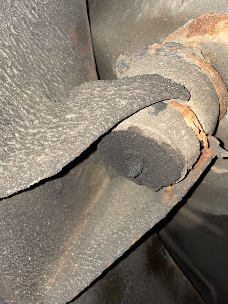

Ever since I bought the truck, the right side cab and box body lines never matched up, didn’t think much of it, since it’s a 2 decade old truck (some alignment just don’t hold up after 20 years), anyhow, recently it started squeaking everytime I hit a bump or defect in the road, and rides like a bag of bolts. Upon further inspection, my cab mount itself has rusted out and isn’t exactly holding up the rubber. What’s my best way around it? Hoping to repair it soon, since I don’t care for these new side effects and don’t want to damage it further.
Rear right cab mount

I've heard of people using an extra large washer and some scrap to build it up some. The hardest part is probably getting the old bolt out.
I’ve done this. Or cut a piece of steel and hole saw where it needs to be. Down side to that is you need to weld, which isn’t a problem for me. The first time I repaired some was when I learned how to weld with oxy/acetylene.
The other option would be to try to find a solid one in a junkyard or see if some place like LMC sells replacement mounts. Chisel/grind/drill the rivets and replace with bolts.
You may end up having to replace the body mount bushing. I’ve had little success getting them apart without cutting things but rust is also a major problem here
