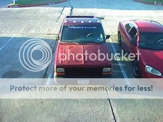

I just put some on my truck last night, I think thier awsome looking, I will post pics ASAP
i still havent gotten around to doing it yet. i've been trying to figure a way to do it without drilling all 5 holes. i don't like the idea of doing that.
Heres mine the lights are from LMC,
i like the look of those. if i ever get around to doing this i'm thinking about getting some smoked ones. do you have any tips for the install?
Just take your time, it took me and a friend of mine 2 hrs to install mine. Be sure you have something to seal them with like silicone.
