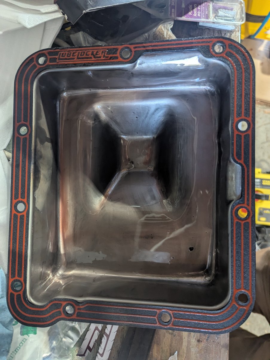

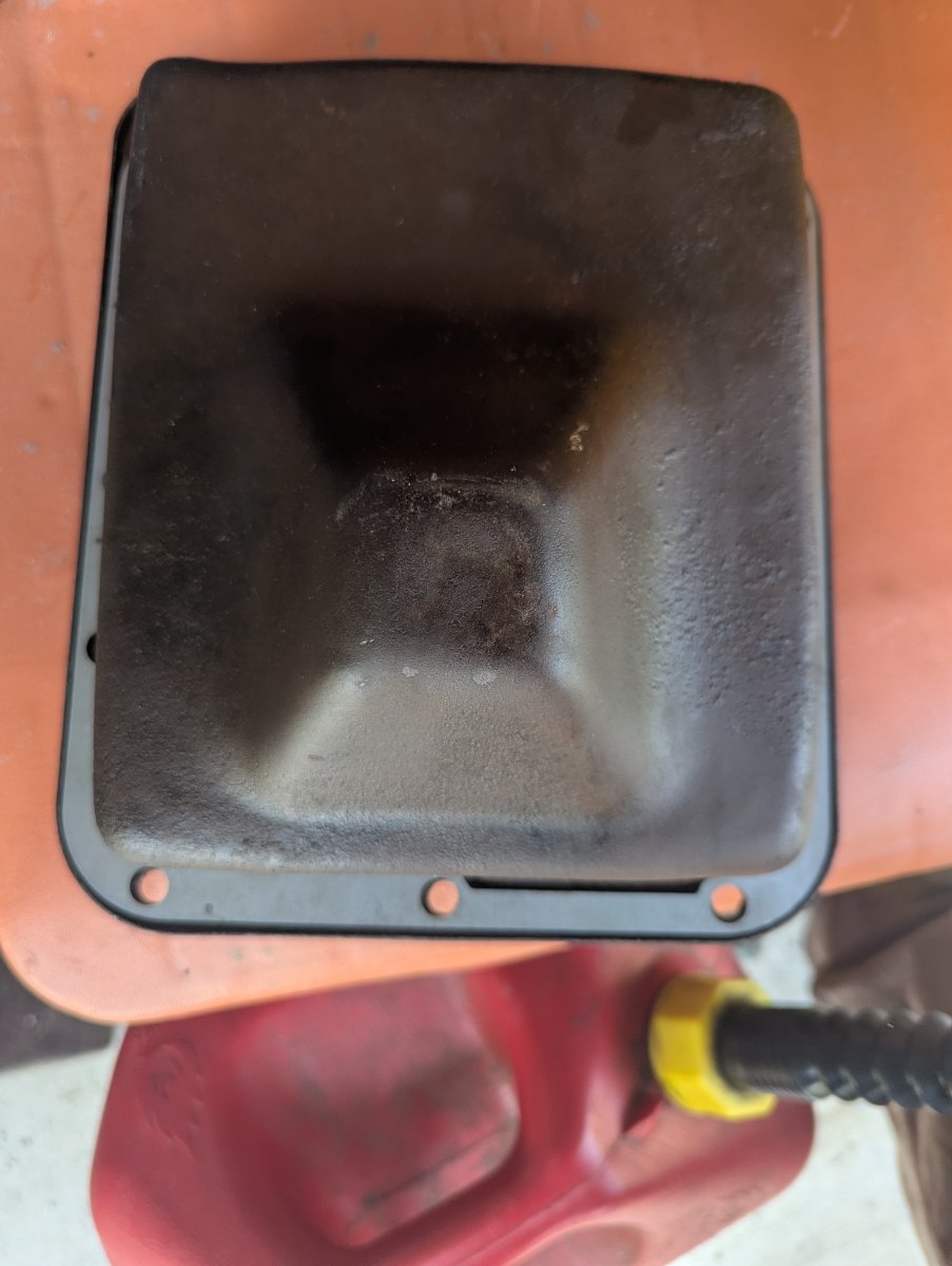

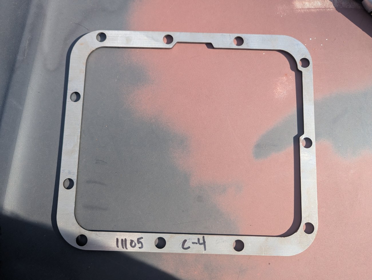

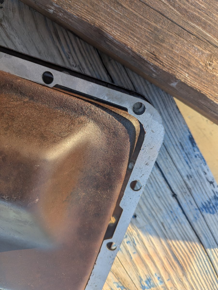

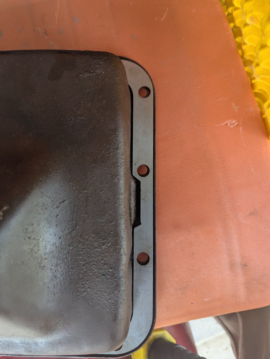

The good: C4 Lubelocker gasket fits the C5 pan perfectly.
The sad: The C4 reinforcement ring from JBG is definitely not a match...

Good news and sad news.
If you have a good fab shop nearby they should be able to scan your gasket and make a reinforcement ring however wide it needs to be to fit your pan.
1/4 in flat stock and a CNC plasma table would make very short work of that. (And generate plenty of waste material...)

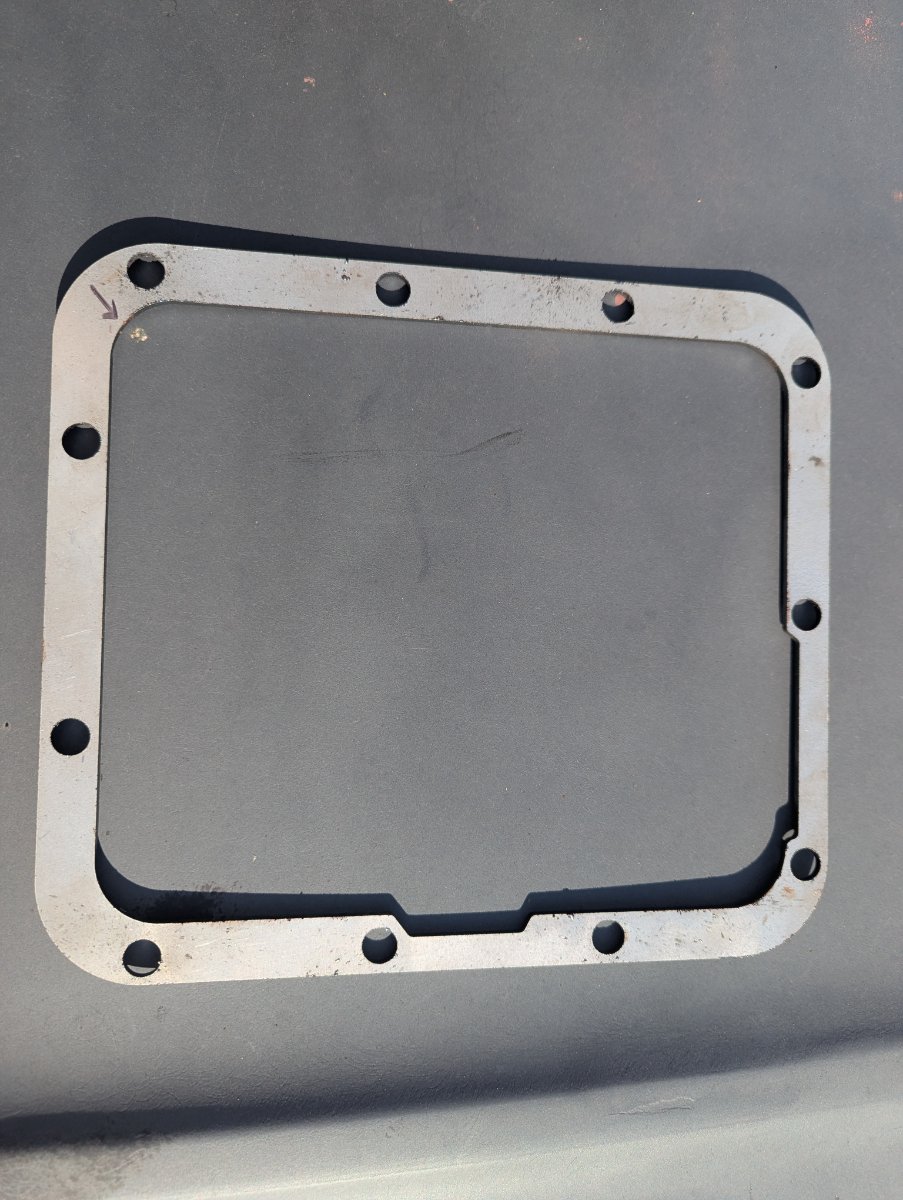

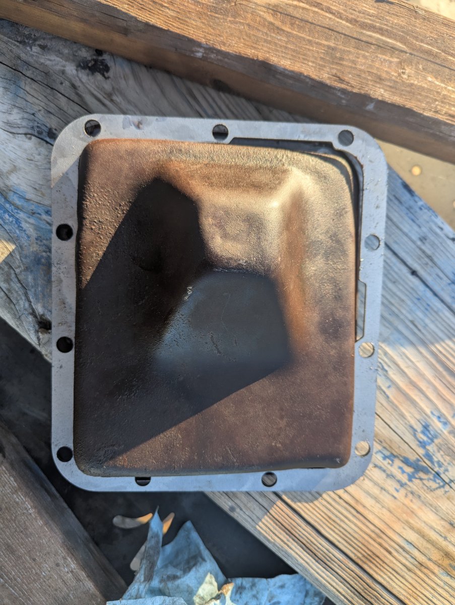

UPDATE!!!

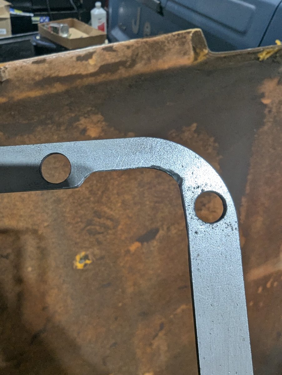

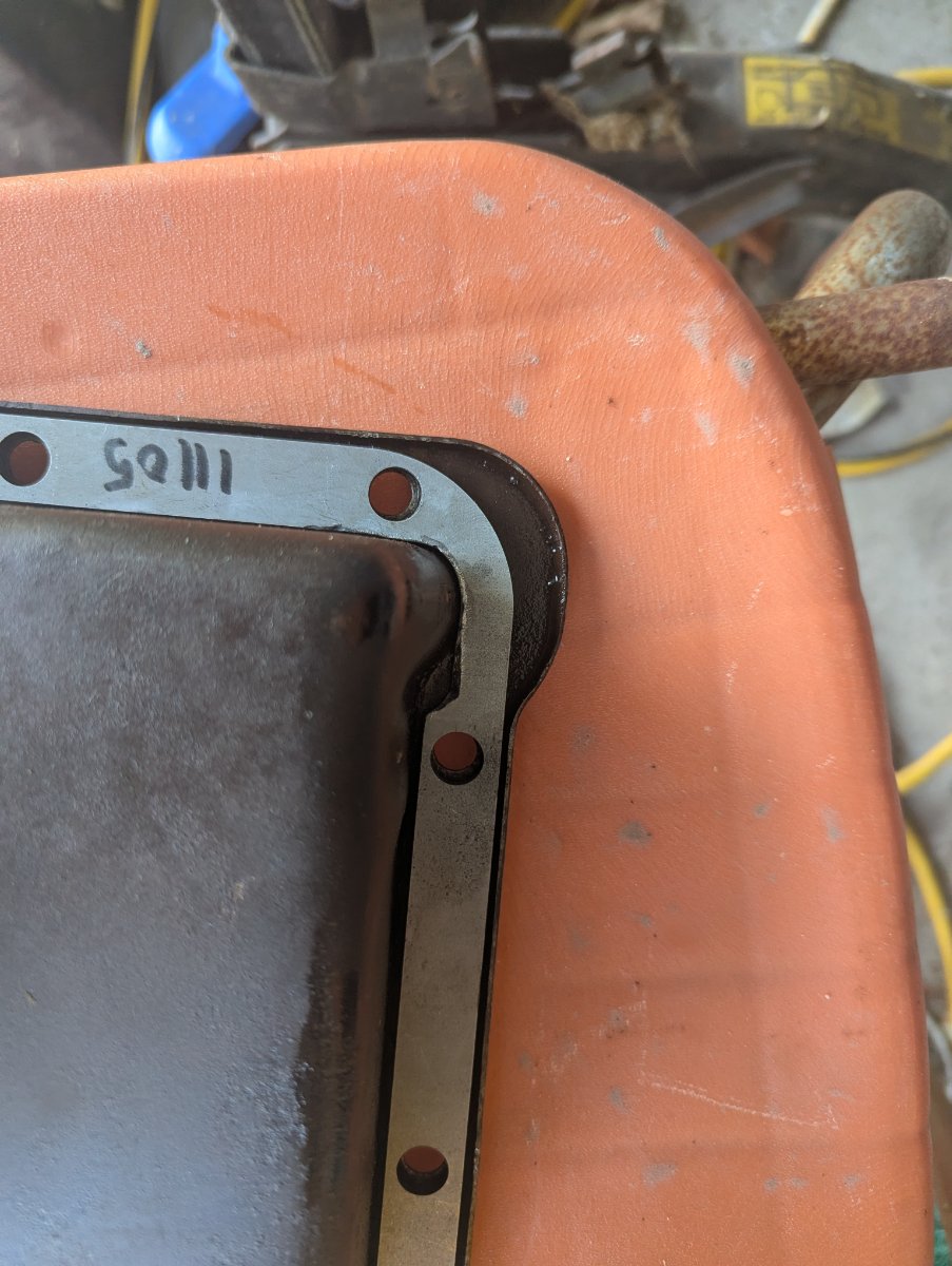

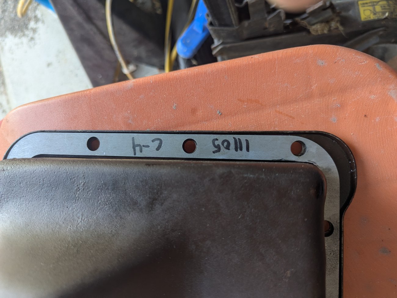

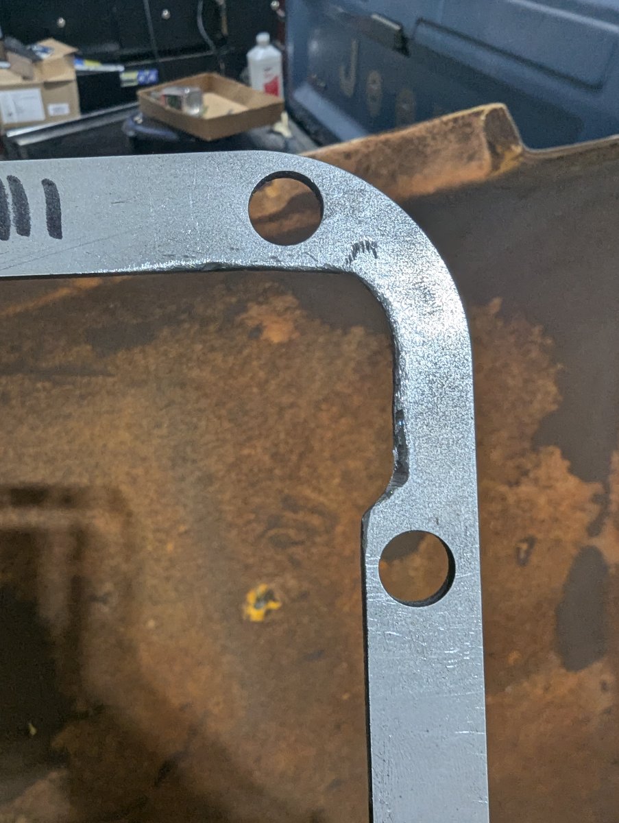

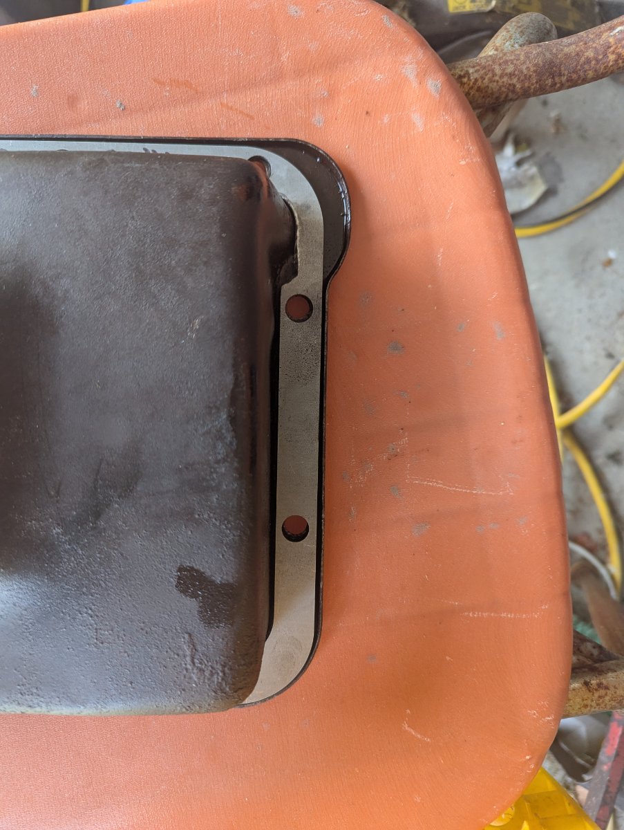

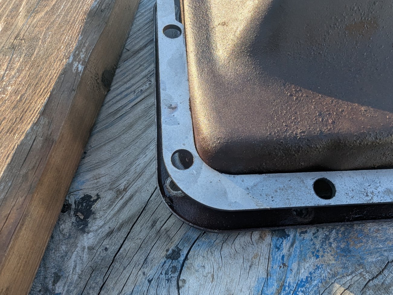

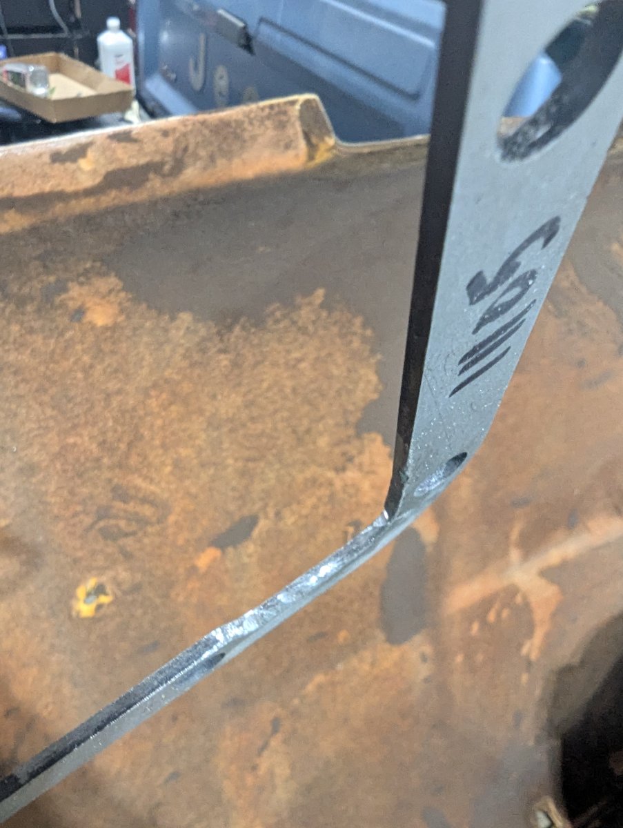

Been dealing with fires at work and working extra hours for the last three weeks so I haven't had much time to do anything. However, I made a go at modifying the reinforcement ring with what I had...

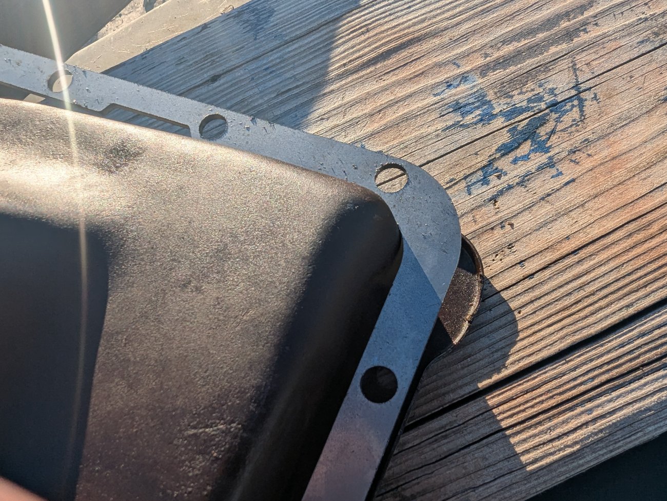

As one can observe, the C5 transmission pan is not fully identical to the C4, and it has one serious hog of a corner, which has to be accommodated. On the ring, I marked where to grind, and it took about twenty minutes of grinding with the dremel, bench grinder, and finishing with a file to get the ring to fit the pan- and what do you know, it fits!!
There isn't a lot of room to play with, a few of the bolt holes are definitely not lined up the same.
1. Should I widen the bolt holes?
2. After grinding, some of the metal stuck to the pan side of the ring, basically welding to the surface. They're small bits and I can probably get them off with a little elbow grease, but could a little bit of this hinder the ring's function?
3. Also, I may need longer bolts, will this be a problem if I do?
I'd love for this to work.

Good job. I would slot the holes as needed. I'm not sure what you mean by metal bits, but clean it off with a file. Use longer bolts as needed, but make sure they don't bottom out.
Basically some of the sparks attached themselves to the ring.
Update:
Everything fits fine, I actually did not have to open the bolt holes any, though I don't know how I didn't get them to line up at first- guess it helped to walk away.
