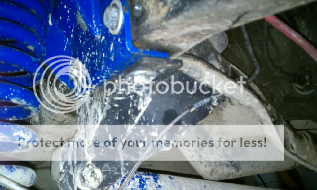

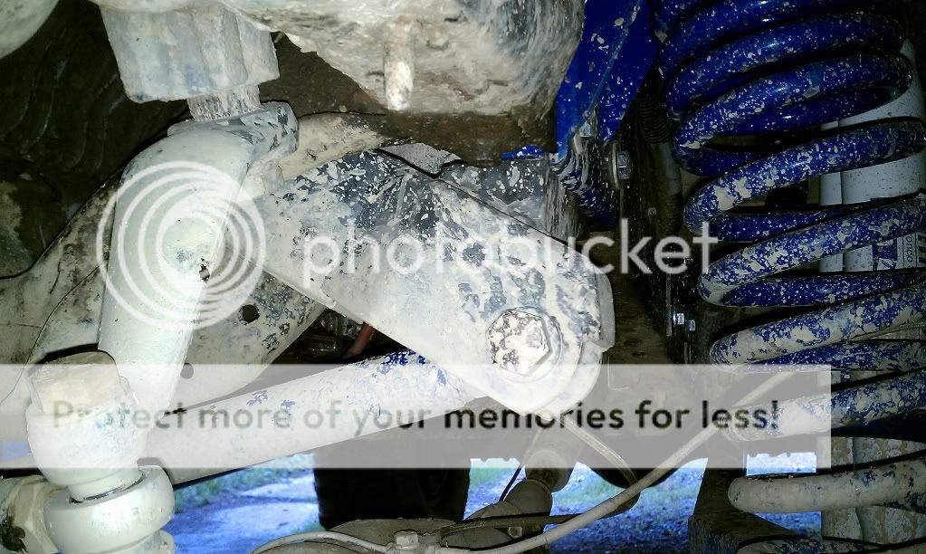

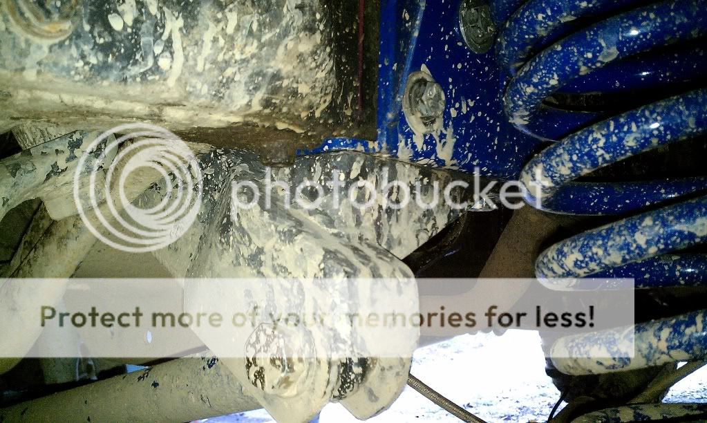

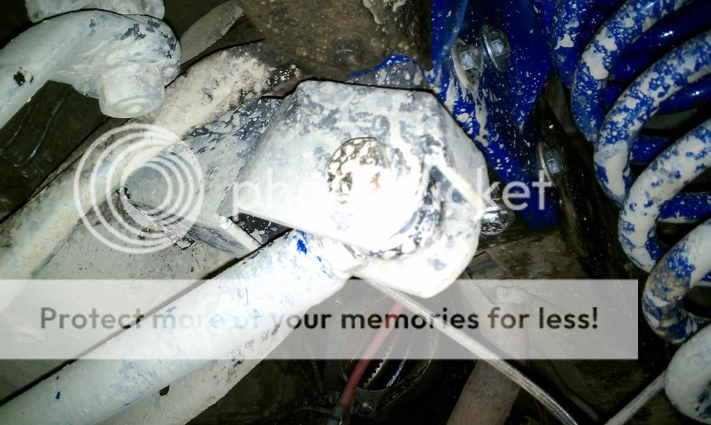

Here is a couple pics. of the track bar. Sorry for the mud.
More pics to come!
