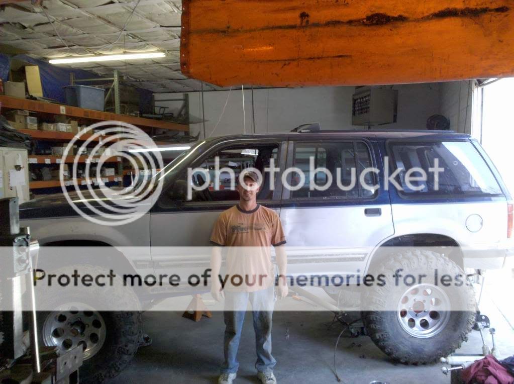

Got the rear SPOA done. Went back to the stock springs plus the shackle I was running with the lift springs. Still sit about 1" low in the rear so we made new spring perches that were a little taller. Still sits a little lower in the rear but the rear springs are already settled and we plan on the front springs to settle some so it should even out within a few weeks.
Pics.
Final ride height.

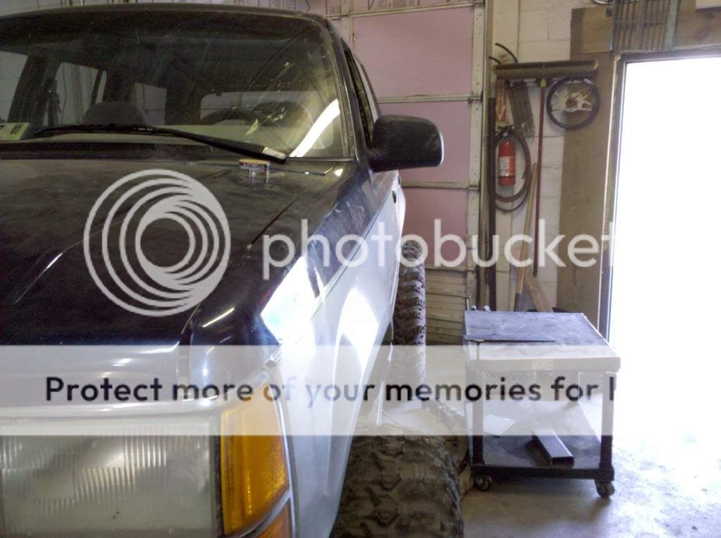

Side shot to show the width.
Me as a reference (before the rear came up another inch)
