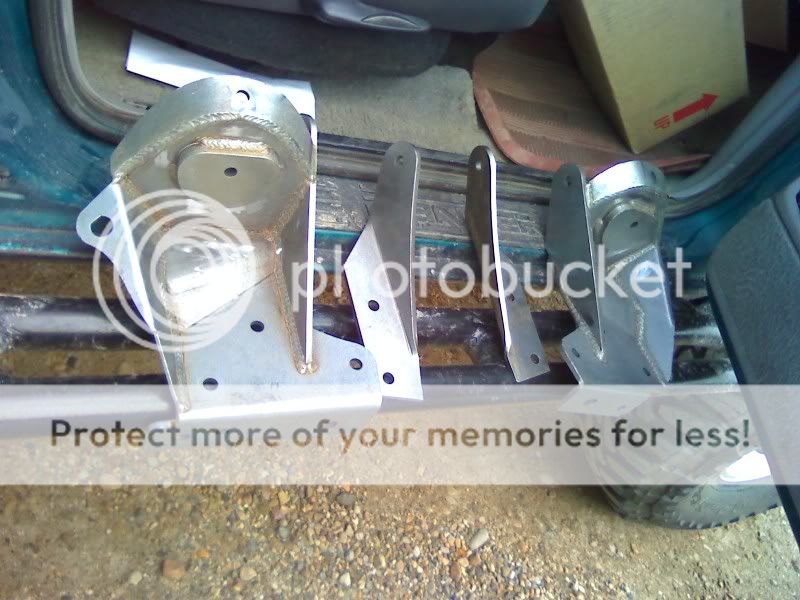

Please tell me that's not a crack I see in the top of the trackbar bracket (2nd pic from the top). Is that just the paint or mud? :-/
Just a shadow from the way the pic is taken, thats the end of the chunk thats bolts below the frame above where it's welded to the tab that mounts to the crossmember....I had to look at it twice too!

Like Andrew said, I believe it must be the way the pic was taken. This is the second setup that was put together. I like this one much better than the first. Ties into the frame using the two lower bolts of the coil buckets and into the engine x-member using the motor mount as well as 2 other holes that were drilled. It's all 1/4" plate and weighs close to 15 lbs!

Yeah, I was like WTF am I seeing, being right in the notch there... it looks rather beefy and well built, it shouldn't be cracking like that (especially having barely drove the thing :icon_twisted: ).

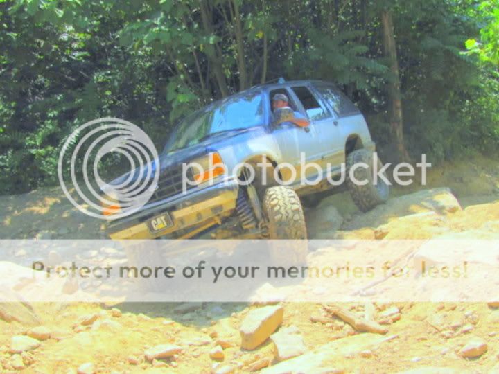

So have you been able to get the explorer out on any trails yet or still just collecting dust in the garage
Actually I did do some wheeling this weekend. I'll throw up some pics when I get home can't do it from my phone. Had a blast and the Ex walked a lot of stuff I used to have trouble with.

Ok so I finally got my friend to send me the pics he took the other day of the ride we were on. I've only got a couple of the Explorer but thought I'd put them up.
Trail 15--Windrock

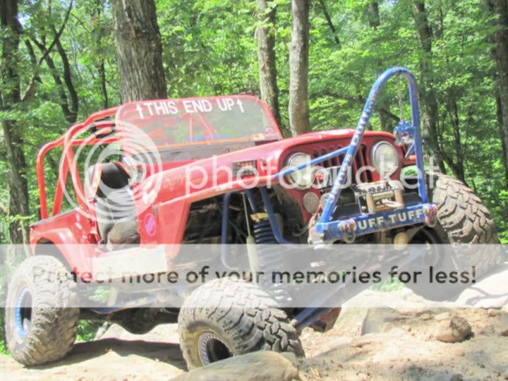

Guys I was riding with.

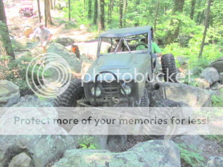

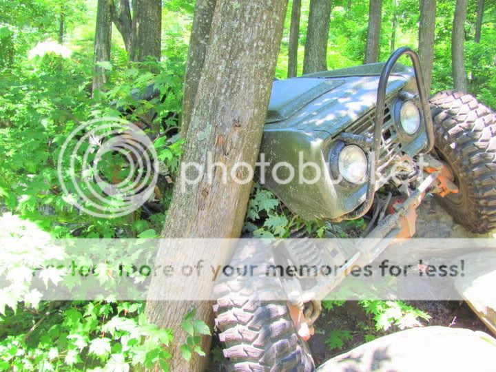

Bryan has a scout 44 front & 9" rear--running Duff 4-link rear & radius arm front. 37" Irocks

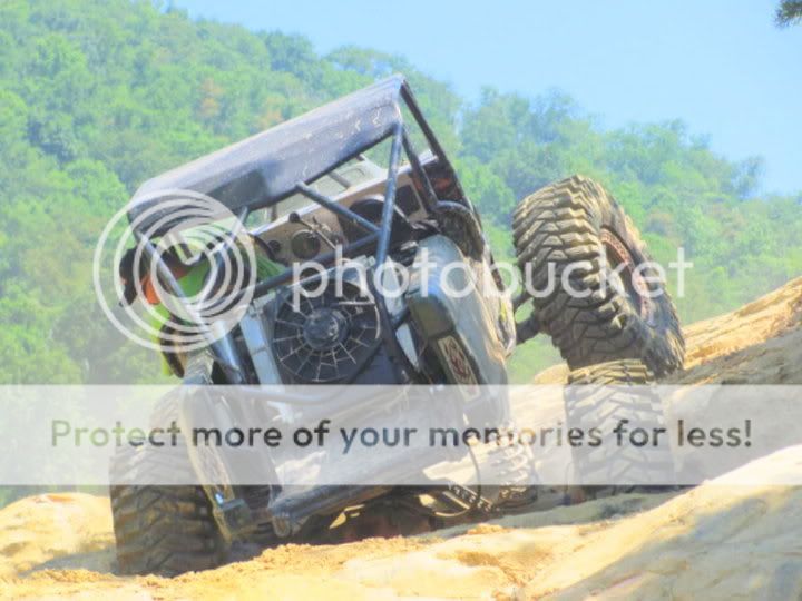

Mark has a EB buggy with 79 HP 60 & 14 bolt rear--4 link front & rear. 40" Maxxis Trepador stickies.

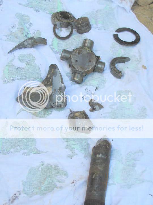

Here's a broke inner & outer Cromo 60 shaft along with a CTM u-joint.

It's a beast fo sho. Hes' run XRRA in it and won a few rock crawling events. Every part on it is the best of the best. Love watching it work, pretty much point and shoot. He had 42" Iroks on it but got the 40" stickies and said he will never run normal tires again. Basically had to re-learn how to drive it with the new tires. Before he throttled everything, 6K RPMs was normal. Now he can crawl up stuff without problems.
104" wheelbase and only 72" tall at the top of the cage.
