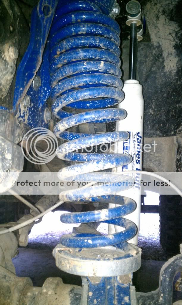

i was wondering, how did you modify the lower coil mount to sit 3" inward? any pics?

weird. Mine moved about that much unmodified.
Paid a little more attention to it last time I flexed it out, and regardless of arm bind I run out of coil before the arm bind is an issue. I need a taller softer coil to get the flex I'm after.
thanks!
Tony, sorry I missed this post. The coil buckets have 3/4" offset built into them and for the lowers I drilled new holes in 3/4" from the originals. That's 1 1/2" and I let the coil take up the rest. You can hardly notice over the span of the coil.
The shocks aren't straight either so you cant go off them. They lean in towards the bottom.
