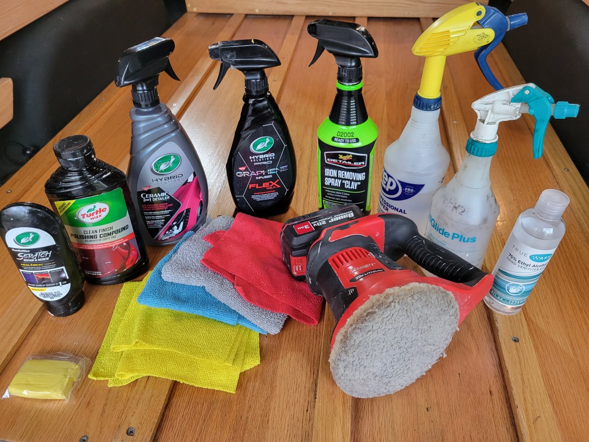

Here’s some things you might need:
  • A clay bar kit, OR a liquid “clay bar” in a spray bottle.
  • A cheap battery powered buffer or a buff pad.
  • Buffing/polishing compound (there's a number to choose from, everything from deep cuts and scratches to very mild)
  • A spray bottle of detailer
  • A spray bottle of water
  • A spray bottle of water and rubbing alcohol in a 50/50 mix.
  • Some small microfiber towels.
Begin by washing. Dish detergent is okay, but just this once. It will help to strip off the remains of old waxes. Wipe down again with the 50/50 mix. Check old wax by spraying water on it. It shouldn’t bead up. It should form an even sheet instead. Use the 50/50 mix again if necessary, or just using rubbing alcohol straight.
Next deep clean, Clay bar the truck to remove stubborn contaminants like brake dust. Follow the directions. Or use spray clay bar. Let the product soak for a few minutes then wipe with a microfiber mitt, rinse, and dry. Spray clay bar also helps to remove wax.
Then buff. Put a few drops of polishing compound on the polishing pad and run the buffer back and forth with overlapping passes on a two-by-two-foot area. Wipe the compound off before it dries hard. Buffing should remove fine scratches such as swirl marks and even flatten out the paint job. Buffing will flatten the paint, make it more reflectant, allow for a deeper shine, and make the surface downright slippery.
“Wax” when finished. Follow the directions.
Maintain with an occasional detail spray after washing. A second wax is always good. Turtle Wax Flex can be used like a detailer on wet surfaces or on dry. This may sound like a lot of work, but wax repels water and dirt and reduces the need for frequent washes.

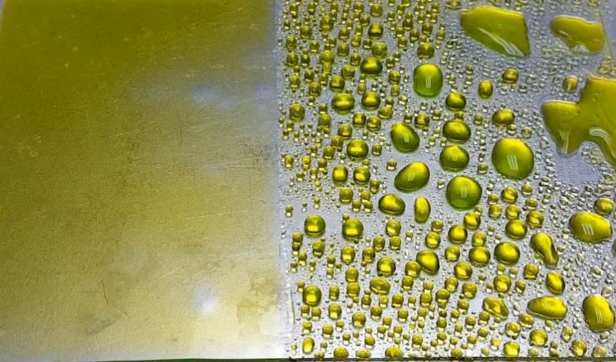

Yup. Beading and sheeting is something to consider. As far as I know, graphene/ceramic waxes minimize beading and allow more water to run off in sheets.
Maybe I should have been clearer when I mentioned sheeting in the post. When waxes are stripped off a painted surface, water will cling to it in a sheet, but it will not run off as as quickly as if it had been waxed. Waxed or not, water beads will form on any surface, but a ceramic wax is a more slippery surface. Most water will run off in sheets, leaving some beads behind. That's why we dry cars with a blow dryer, a microfiber towel, and a detailer.

I can see the argument for sheeting over beading. Beading means there is some surface tension for the water to cling to. Sheeting means the surface is too slick for the water to bead.
In a perfect world, painted surfaces should be so slippery that all of the water is repelled or runs off.
This is why the detailing industry recommends three steps. The first is clay bar to pull out imbedded microscopic contaminants like brake dust, making surfaces more slippery. The second step is buffing which flattens out or corrects paints and clear coats which are somewhat textured. This is because the spray process applies wet paint in tiny droplets or molecules that create a microscopic landscape of peaks and valleys. Also, when paints and clear coats cure, some chemicals and solvents will "gas off," cratering the finish ever so slightly. Those craters, peaks, and valleys are sometimes called an "orange peel" effect. Buffing uses a slightly abrasive polish which will smooth this out. The third step is a "wax" or sealant which will fill in any remaining imperfections and leave a smooth protective slippery coating. These three steps, clay bar, buff, and "wax" are more than cosmetic. They repel water as well as protect the finish from rain (which is slightly acidic), UV rays, oxidation, and chemical contamination.
But this is not a perfect world. After a wash or a rain, some water always remains in the form of either beads or sheets, depending on the coating. Newer products contain graphene and ceramics. Some have sheeting or "hydrophilic" properties, Some have beading or "hydrophobic" properties. A little controversy remains as to which one is better. A third group says it doesn't really matter. Both are slippery. Both protect. Both will last a long time, much longer than those old carnauba waxes (which had beading properties.)
One detailer explains. "Water sheeting or beading does not mean one is better than the other. You want solid protection and depending on the chemical formulation the surface makeup may be one or the other. As long as the protection does not easily wash away and makes the paint easier to clean, you know you have good protection. then the longevity of it is what makes it even better... Automotive paint protection is the resistance to UV rays, chemicals, etc over an extended period of time, not the ability to disperse water."
