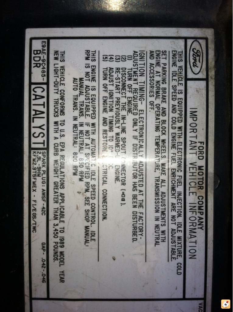

My 1988 Bronco II 2.9 will not restart when hot.
First thing I did was change the TFI. Didn't fix it. Then I changed EEC, coil, distributor, plugs and wires, cap and rotor, TFI again which didn't fix the problem. I don't know where to go from here.
