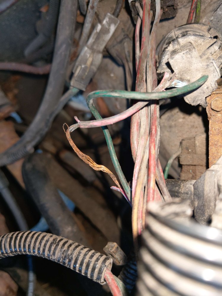

so I'm trying to track down what got it not starting, So, I've checked for spark on sparkplugs got em, got compression, and fuel, and timing shouldn't be an issue since I did not change that, either way, I took a closer look at a few components and noticed a loose wire from the ignition coil, looking at the diagram, it looked like a positive wire that's probably controlled by the ignition switch, I'm just trying to track down where this wire belongs, it looks like the previous owner had it taped to a stripped wire, and it fell off, but I'm not sure as I did not pay attention to it previously.
Either way, I'm hoping someone can give me an insight or possibly a picture of where this wire should belong.
or if that's not the problem what might keep the car from starting, I got fuel, compression, and spark. if it helps any, it does not sound any different when cranking with the ignition coil off.

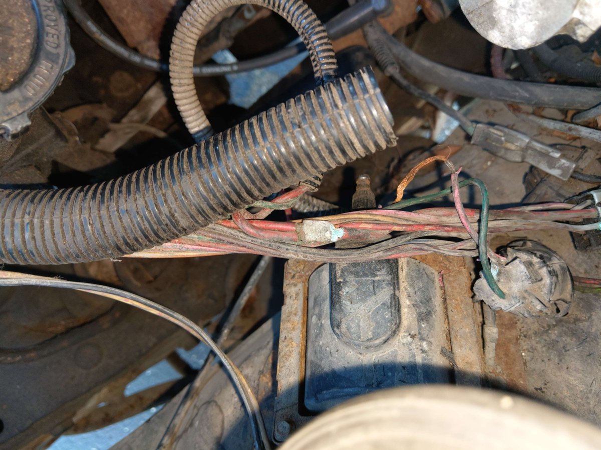

the severed or loose wire from the ignition coil. ---------- where I suspect the loose wire was taped too on the exposed wire.-------------wires close to the ignition coil.

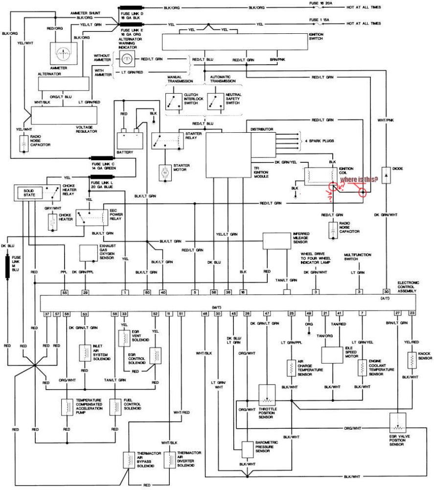

wiring diagrams, I believe it's the Red light green wire from the coil, I just really need a picture of where it's supposed to connect to or a clear description for a color blinded person who doubts every color they see lol

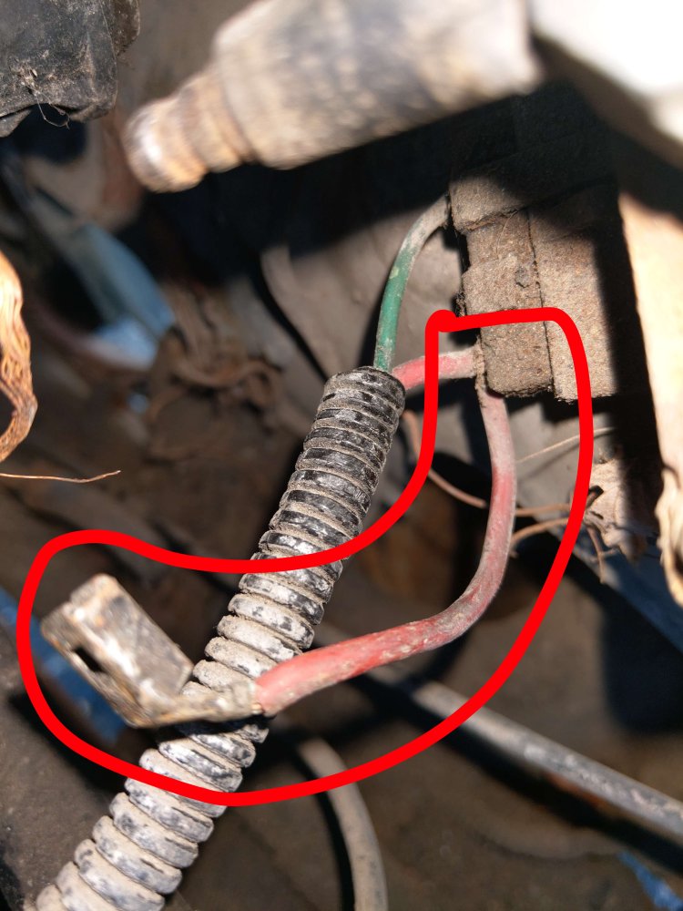

My guess is that your circled wire used to go to the radio noise capacitor.

would you know if this could cause the vehicle from starting? blown fuze, etc since it's oof. id check myself, but my cars are a decent drive away.

That dont look like the capacitor wire. That looks like the wire that goes into the coil plug. Theres only 2, a red and green (if its like a 2.9), looks like it just pulled out of the plug.
On the bottom of your coil theyll be a plug, should have 2 wires going to it, red and green. Itll be pretty self explanitory once you look at it.
And no...having the capacitor wire unhooked wont kill it

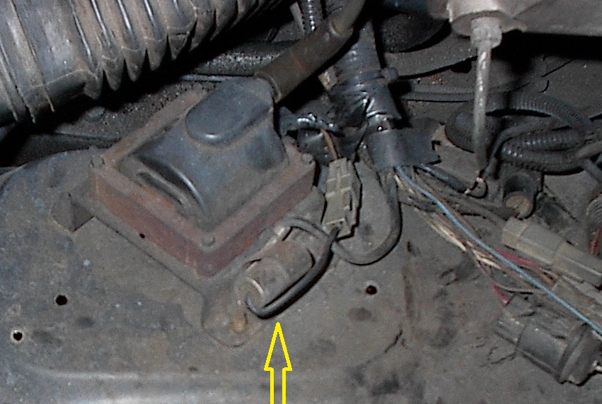

Here's the radio capacitor on the same coil on an '84 2.8L.

The ignition wire (usually red/green, but can be white/blue or brown/pink) goes to the coil and then a short pigtail, same colors, comes off the terminal for the radio cap. If your radio cap is not there, that's likely your circled short wire. The cap being missing will not keep the engine from running.
"The (+) ‘BAT’ side of the Coil is the only place you have to splice into a wire. On the driver’s fender well, there is another connector, square in shape and gray in color that has either a Brown wire with Pink markings or a Red wire with Light Green. These wires should be hot when the key is on. This wire needs to go to the (+) ‘BAT’ terminal on the ignition coil."
"Brown wire with Pink markings " = in sad shape. I would just cut it out for now and replace with a 2 or 4 prong trailer harness and start the vehicle. Obvious the plastic has melted off the wire, probably from high resistance with the connection corrosion seen on the various connectors. If it was me, I would put in a temporary 10 amp fuse with M</F 1/4" connectors to make sure once I made a good connection it did not supply enough power to a short to start a fire because going by Haynes that wire gets direct 12V from the head lamp switch circuit.
