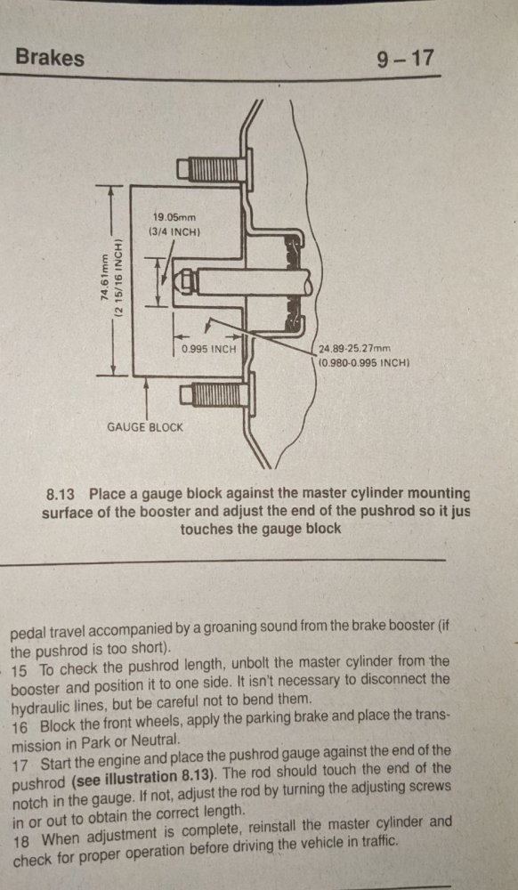

Update: I drove 60 miles and not once did I have the surging issue. The only thing I changed was the Brake Booster pushrod. I never calibrated it so I figured why not check it out. Turns out, it was WILDLY off. It should be ~1" from the base of the brake booster to the tip of the rod. Mine was much farther than that, which might contribute to a few things: Dragging brakes, poor fuel economy, and a "vacuum leak". My theory is that if the rod is too long it creates a pressure difference, not suitable for the car, creating a "vacuum leak".
I created the brake booster measuring stick by 3d modeling it and 3d printing it, though you could use any tool that's roughly an inch. Attached is the excerpt from the Hanes manual and my stl that I created.
