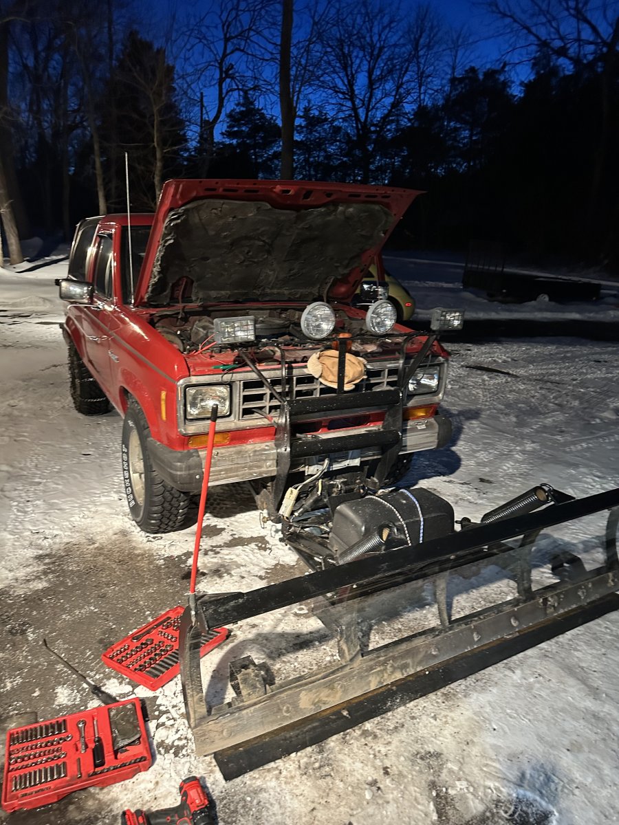

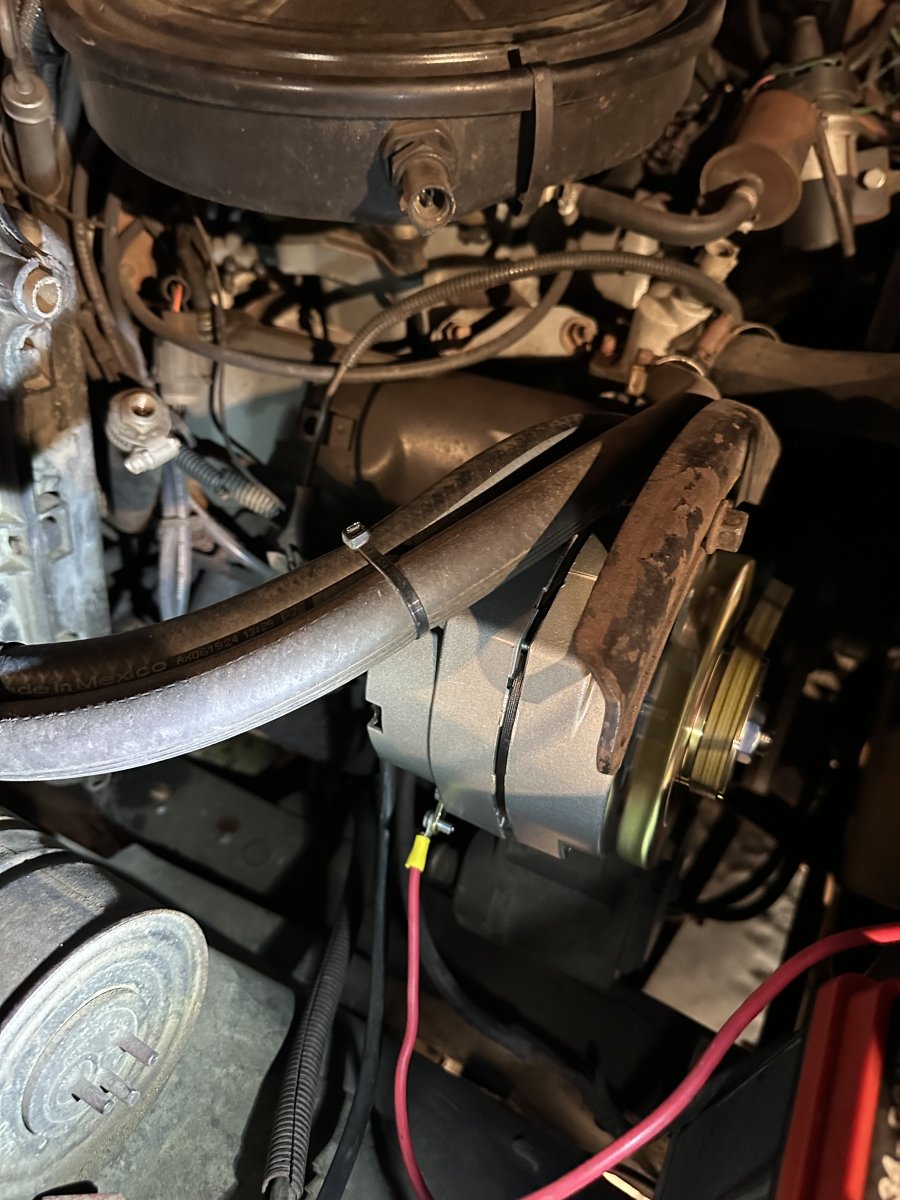

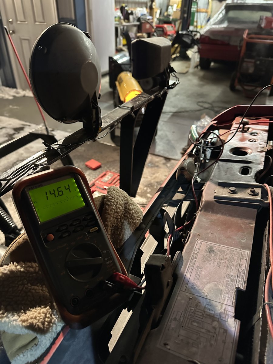

Just to give you an update I just finished the one wire conversion tonight and let me tell you what an improvement the old alternator put out about 13.5 V at idle this puts out 14.5 the plow now goes up and down a lot quicker due to more voltage at the motor and at idle it is putting out a consistent 14.5 to 14.6 V. It was a quick install bolted right up in the stock location with the stock brackets lights are brighter. Everything seems to be an improvement over what it was. I am fairly happy right now. We will see how it goes when I actually have to plow with it.

So, you used the alternator that you linked in your original post?
I assume you are running duraspark, what are you using to work an electric choke if you still have one? Mine us currently running off the S wire on the stock alternator I believe.
Yes I used the tuff stuff 7068 and I did away with the electronic controlled carb years ago and converted to duraspark due to my harness was deteriorated , I ran the choke wire to switched 12v , seems to work okay and converted to a cheap eBay 2150 2 barrel and has never run better, search my posts I think I had a thread on it
