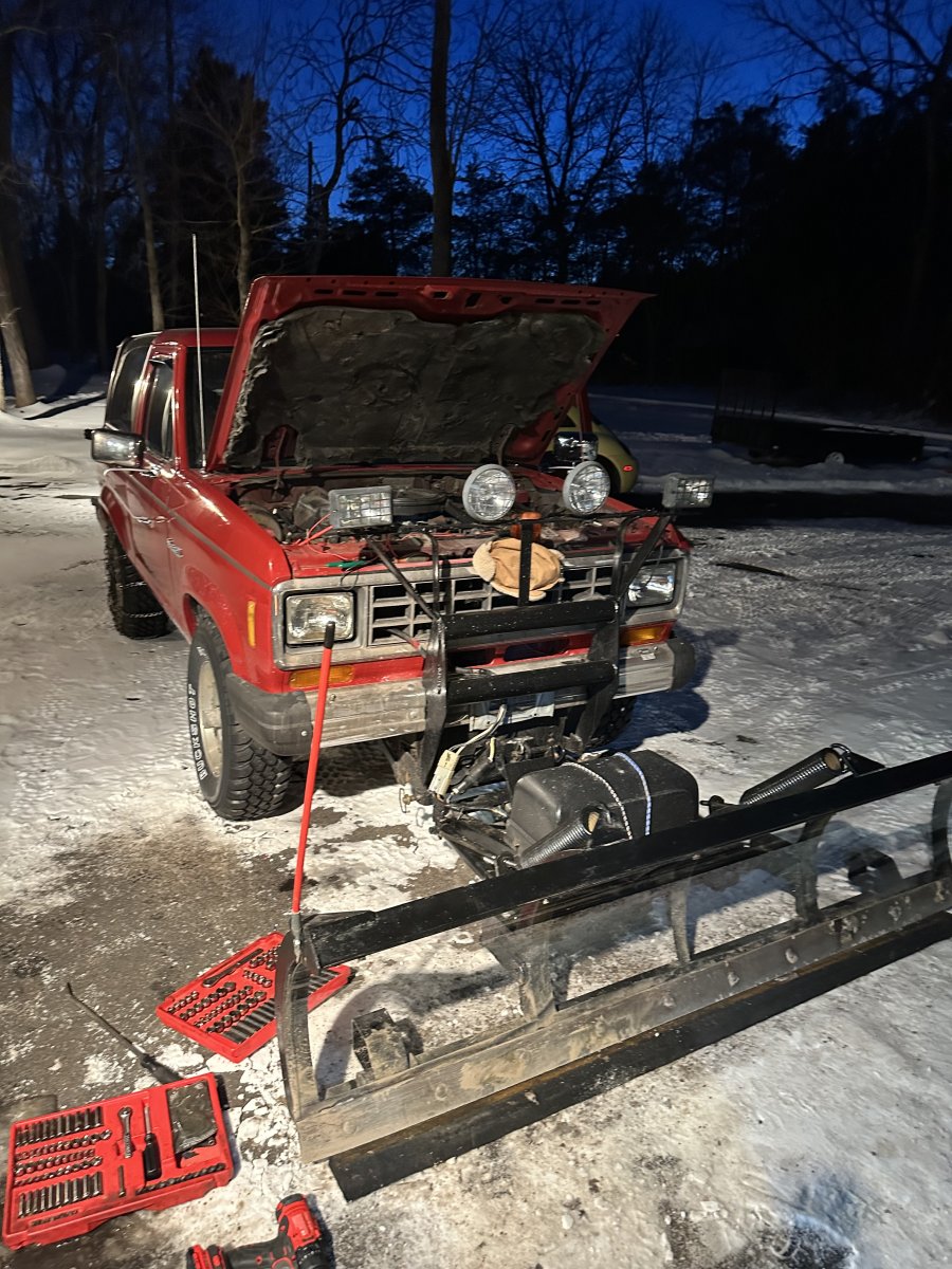

Guys I'm looking at doing a 1 wire alt conversion for my bronco ii as it intermitantly won't charge and i now run an odessey battery and the old alt and external regulator is just not enough for my needs, I use my B2 to plow and the front is outfitted with 4 off road lights for plowing so I need a good 100 amp alt.....was looking at the tuff stuff 1 wire alt form summit racing part number 7068?? does any one know if this will work or have done the conversion before?? If so what did you use?

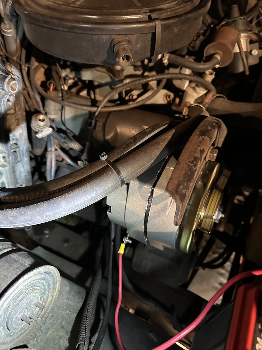

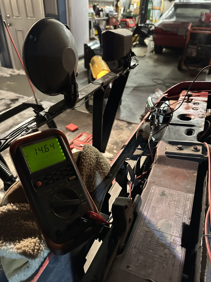

Just to give you an update I just finished the one wire conversion tonight and let me tell you what an improvement the old alternator put out about 13.5 V at idle this puts out 14.5 the plow now goes up and down a lot quicker due to more voltage at the motor and at idle it is putting out a consistent 14.5 to 14.6 V. It was a quick install bolted right up in the stock location with the stock brackets lights are brighter. Everything seems to be an improvement over what it was. I am fairly happy right now. We will see how it goes when I actually have to plow with it.
