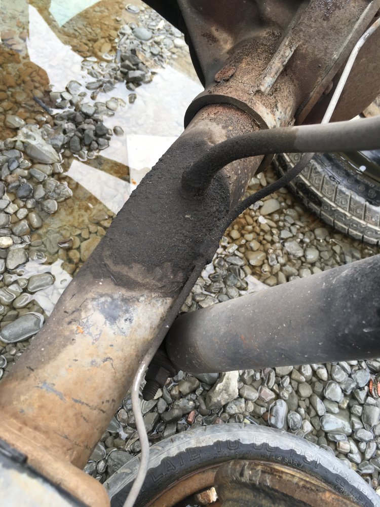

any idea why there is grease all over this connection that goes to an open hose?
i saw other rangers with smaller pools of grease in the same area

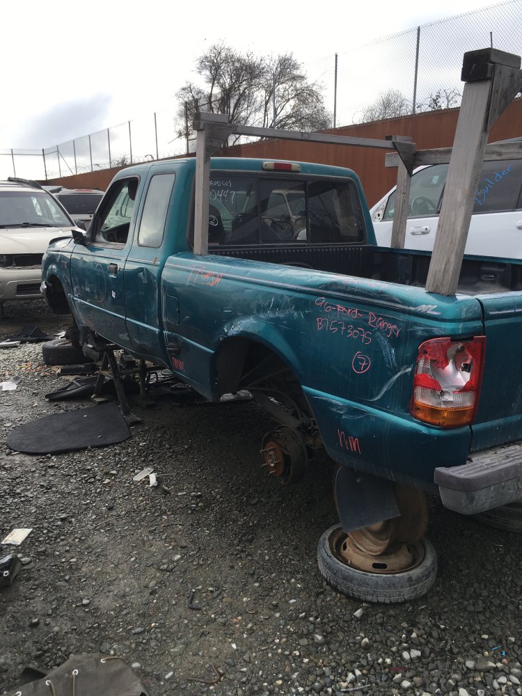

another ranger with only 200kmi, looks like it sideswiped something but not very hard, you all dont think that could compromise the axle, do you?
That's just oily dirt. That hose is the vent for the axle and differential. Opposite end of the hose is usually mounted on the frame or higher, with a breather on the end to keep dirt out. The hose is probably old and brittle and allowing oil vapor to exit there and collect dirt.
Hose could be obstructed so it is venting down low as well. Can also cause oil get pushed out of axle seals.
