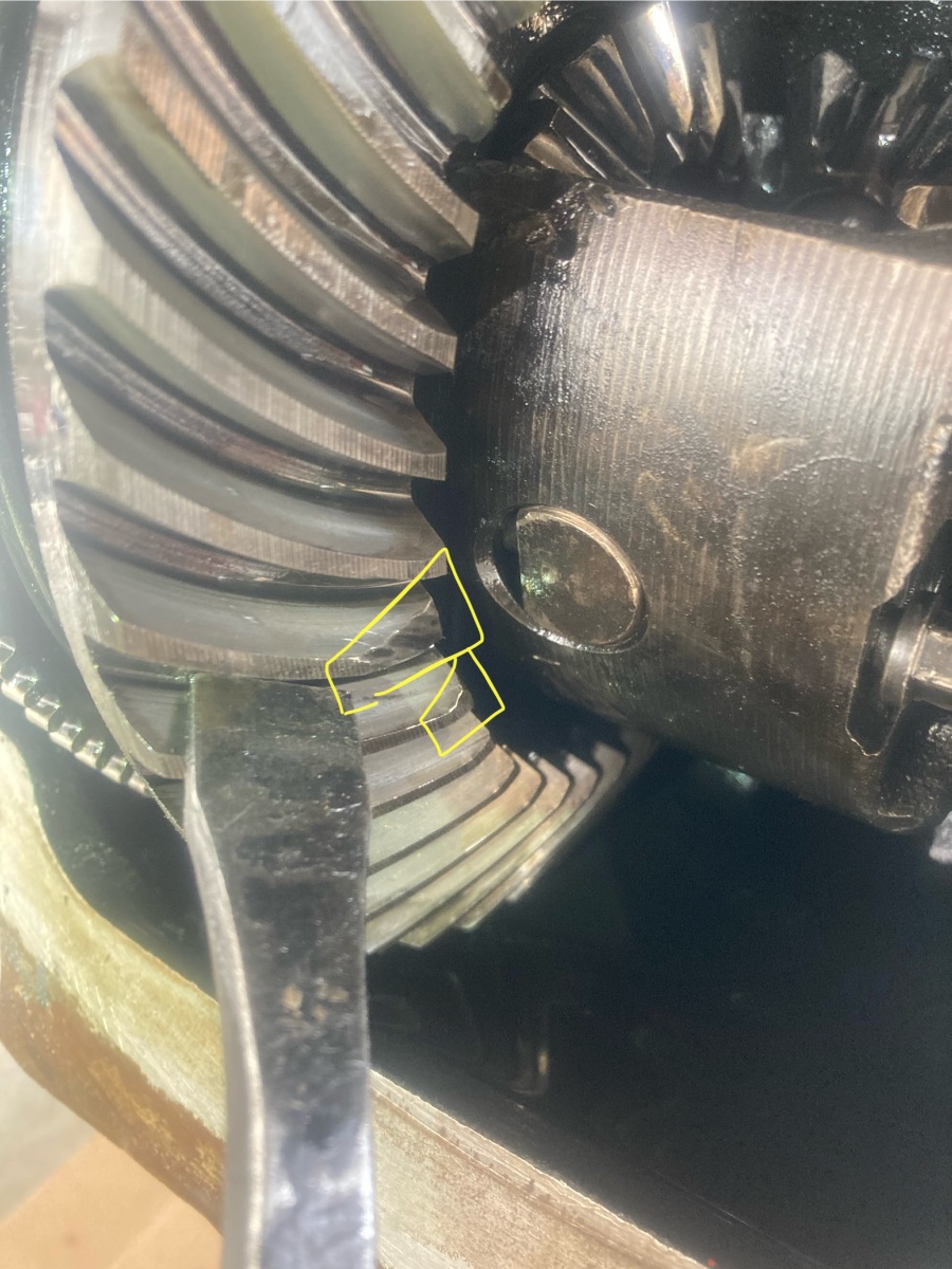

just thought i would give an update for anyone who searched this thread
for reference on differentials.

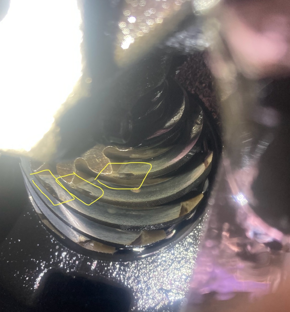

iirc i posted similar pictures earlier in the thread and the teeth had similar wear which doesnt seem to have changed much.
the wear on the 'worm gear' seems to be consistent across every tooth.
the wear on the big gear is just on the two highlighted teeth.
the spider gears all look fine

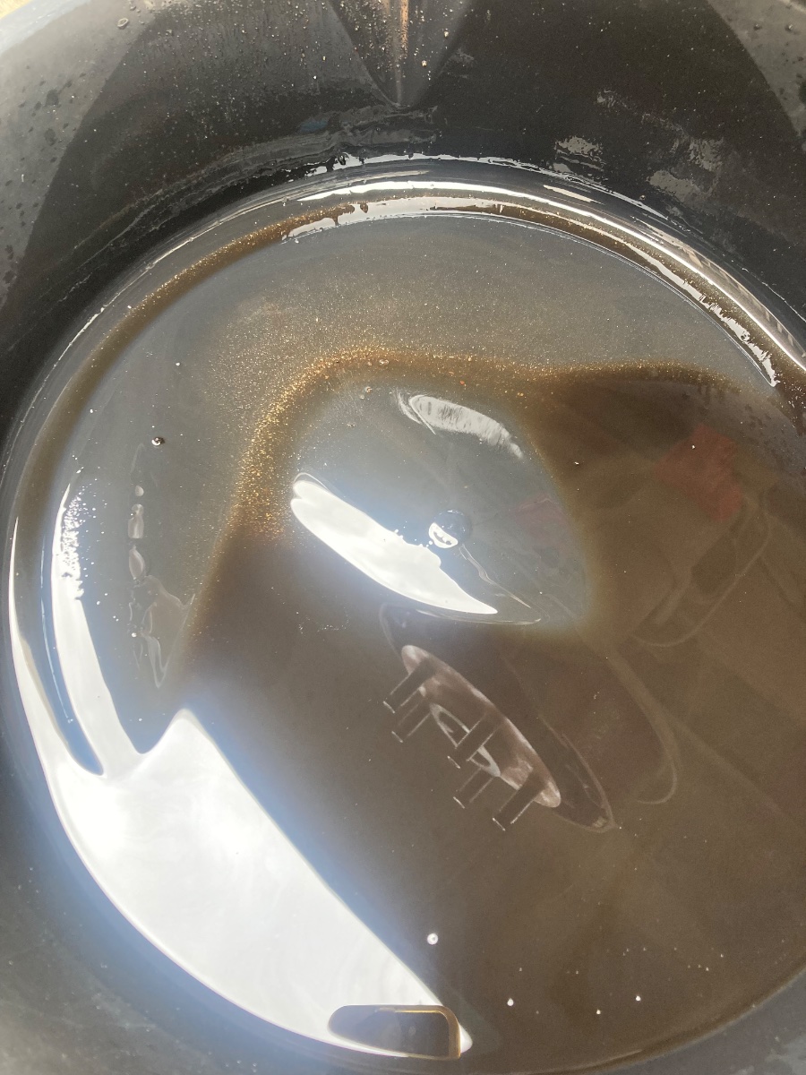

the pictured debris was at the bottom of my gear oil.

omg that big gear wear was from me hitting it with an angle grinder to remove the crosspin LMAO
