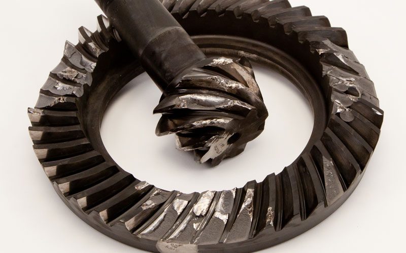

Man, I was hoping for a picture of carnage like this...
Differential Failure Analysis | West Coast Differentials
Seriously though, setting up gears is not for a novice. I'm not saying you can't do it but you will need some special tools. Todays prices you can see a gear swap around 700 at a shop. If there are chunks in the oil the shop would probably want to replace bearings and carrier as well. Then you would be looking around 1500.

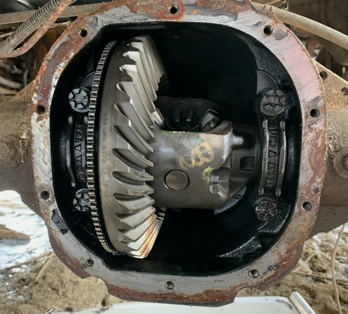

Pulling off the diff cover will definitely give you the view of telling if the gears or carrier are toast.
But I would verify all the above before you do this. A u-joint that is toast can make a lot of noise.
This is the view that you would see...

I feel like when you pop off the cover, you will be misisng more than a piece of a tooth, luke in the picture you posted. Clicking every two rotations of the wheel sounds like you sre going to be missing 3 or 4 teeth.
And downshifting to slow down will not cause that issue. Being very low on fluid could though because that could be the face of a tooth missing, not the whole tooth.
