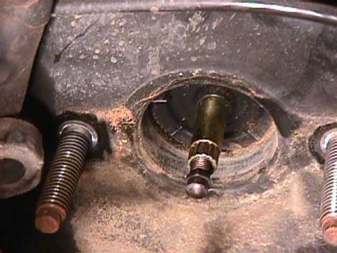

On explorerforum they talk about adjusting "the pushrod for the master cylinder. In order to maintain a good pedal feel after the conversion, the rod must be adjusted to push further into the master cylinder":
i didnt notice much of a braking increase after my explorer rear-end swap, should i try this, or will it cause premature master cylinder wear, or apply too much front pressure?

Try swapping to a disk/disk master cylinder from a later model explorer or ranger. Should take care of your problem. Adjusting the rod will do nothing to help the problem you are having.
