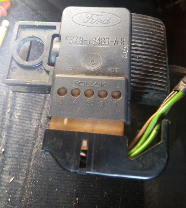

removed the brake pedal switch. the contacts are marked with numbers. switch says part# F87B-134870-AB
both brake lights quit working, don't know why
checked with a multimeter. on the plug, #1 and #3 have 12V power. on the switch, 1-2 and 3-4 have continuity when pedal is pushed, otherwise not. 4-5 always have continuity unless pedal is pushed. any other combination is always off.
