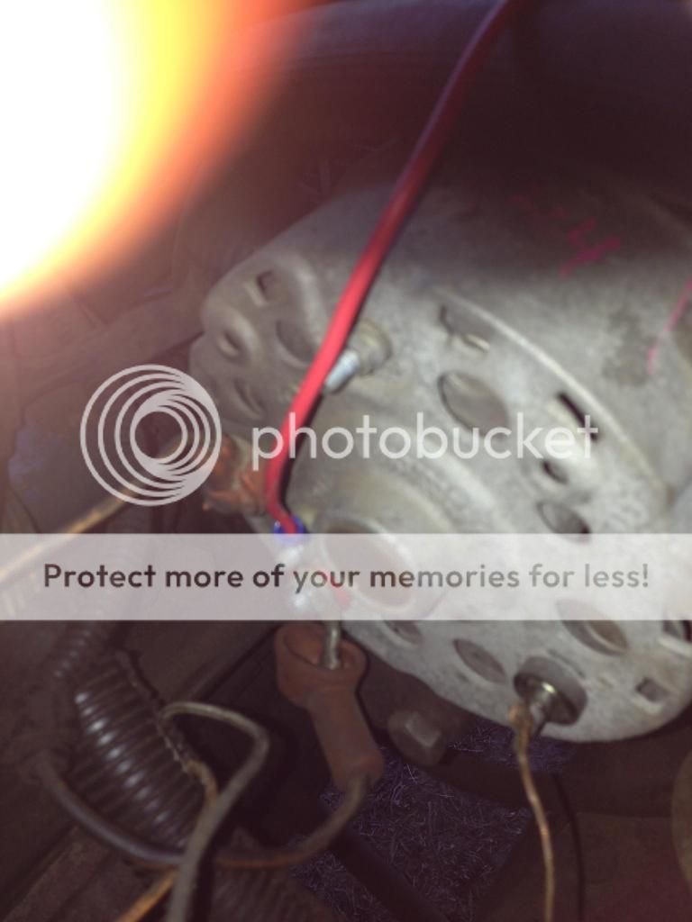

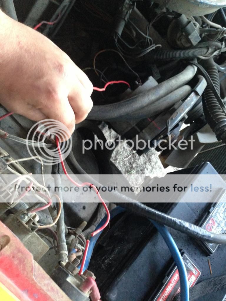

heres a pic of the wire i connected that i think cooked the battery. its a brand new wire because the old loose one was to short.(cut it after the battery bit the dust)

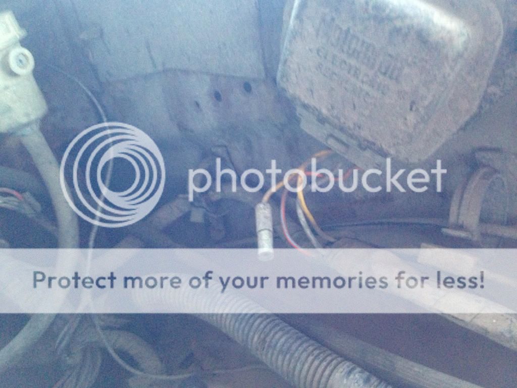

heres the back of the alternator with the 4 wires coming off it.
external voltage regulator.....i think

so there isnt any splits in the wire or broken coating on the wires. not between the alternator and the fuse fox anyways. but there is that wire on the voltage regulator that goes to nowhere. im wondering if thats somehow connected.
