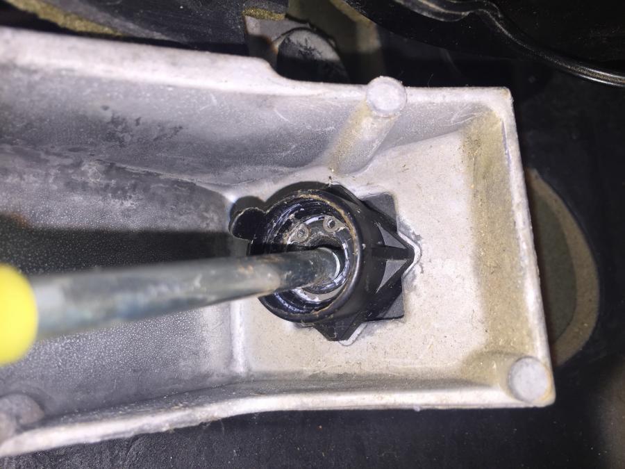

earlier i tired bleeding the slave cylinder. did that correctly to find out i now have a very soft clutch. starts but wont go into gear. goes into gear fine with the truck off. i've tried to take apart this master cylinder mechanism inside the cab behind the pedal. something about getting the snap ring off the piston to relieve the air bubbles inside the master cylinder and it will then work. i just need help getting this snap ring off and if any body has any suggestion to a soft pedal fix
Here is the snapring

just pulled the whole assembly out. pretty simple. i couldnt get the master cylinder situated right where the actuator whould push the air out just like ya'll were trying to describe. i hung it up vertically outside on a nail and pulled the piston out, made sure it was filled up, re installed the piston(actuator) and viola it works. but thanks to my buddy i wouldnt have been able to do it. thank all of yall
