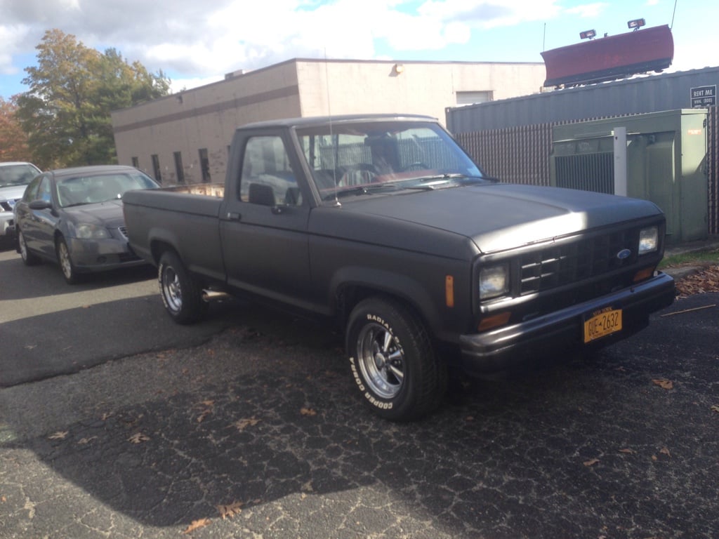

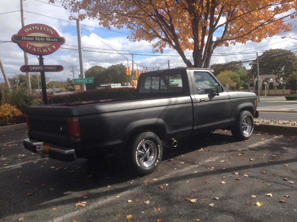

Blackwidows 350 sbc street truck build

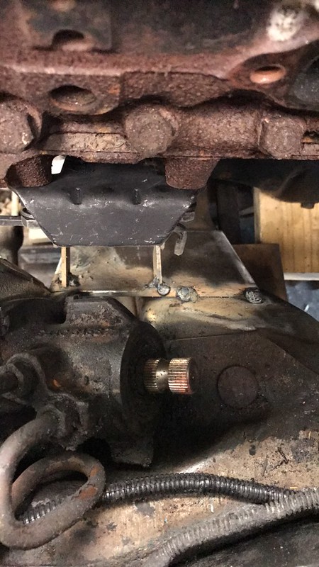

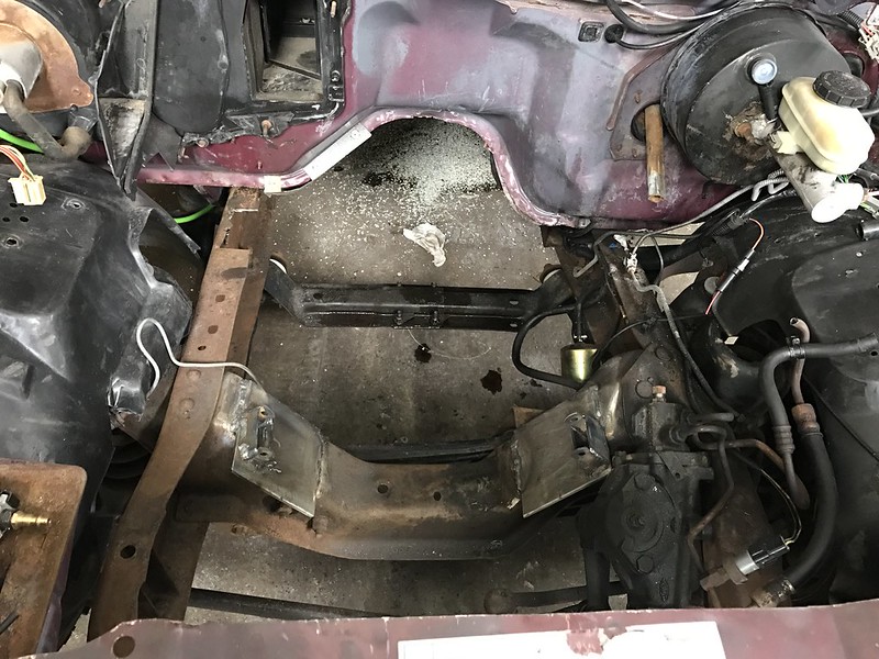

I've ordered a different set of headers. Also some 1/4 plate steel to fabricate the frame mounts. Should have everything by the end of the week. So this weekend a lot of progress should be made.
Nice progress bud. Looking fwd to seeing how u fab the plates. What headers are u going to try n squeeze in there?

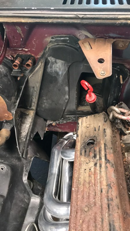

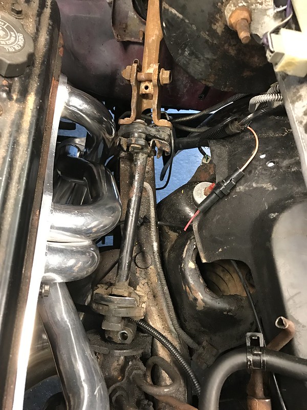

88-up Silverado headers fit nicely on the driver side. Pass side I had to cut the frame. I'll box it in for strength before I set the engine back in.
Looks good man. I had to go back n read up as I forgot it was a sbc going in there. Looks like it fits similarly as a sbf clearance wise. Keep up the good work.
