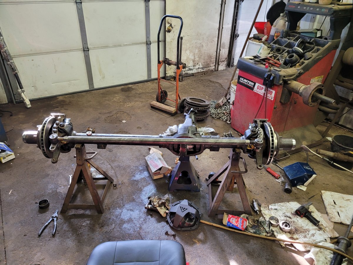

Just finishing up a dana 44 swap
On my 93. Not gonna say this is the way to do it but it is how I did it. Hopefully somebody finds some of this useful or at least interesting.
Front suspension:
Spring under
5" bds lift springs for front on a YJ
Factory ranger shackles
Rear shocks for 02 rav4
Spring bracket from slag factory
Rear suspension:
Factory but with lift shackles and add a leafs.
Front axle is the wide track waggy 44
Wide track is not ideal but it was only 50$ everything knuckle out is from a 90 dodge w150
This is a great way to get flat top 5x5.5
Bought the truck for the knuckles and made money parting it out.
Detroit locker got it used its a 3 series so I had to run thick cut gears to get to 4.56
High steer arms from src precision products
I think they have been closed for many years now but i had them around.
One ton tre ends
Rear axle
Jeep 8.25 from 97 xj with disc brakes from first gen liberty. To do the brake swap you will need wheel studs for a tj front axle. Why? It was already geared 4.56 and had it lying around. Not ideal but use what you got.

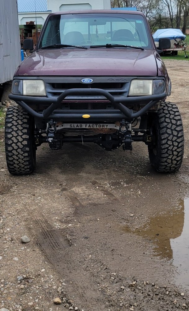

I gotta say... I like that tube bumper. Is that one you fabbed up?
Truck looks pretty tough with the SAS...
Nah I got it from Amazon. Its a smittybuilt jeep bumper part number 76721.
Quite a bit of welding.
Nothing really lined up.
Wow it looks like it was designed for that truck!
Yea Im happy with how it looks. Really didn't know what to expect but thought it was worth the risk for the price. My pipe bender is missing the tooling to do any pipe small enough To look right on a bumper.

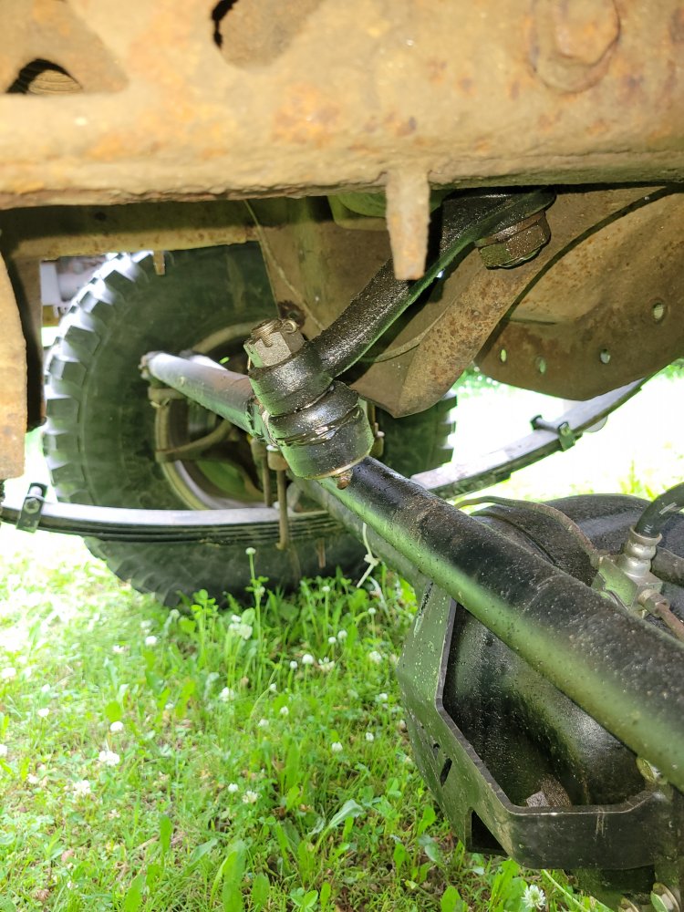

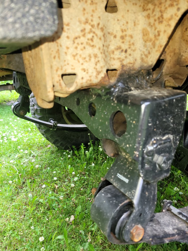

I think I'm just bad at taking pictures lol not really much to see. I tried to get some steering in the pic as well because I think that might be a challenge If you go with spring over. My other concern is with spring pad placement i think you might have to outboard the springs more than me because one perch is cast into the pig on mine.
