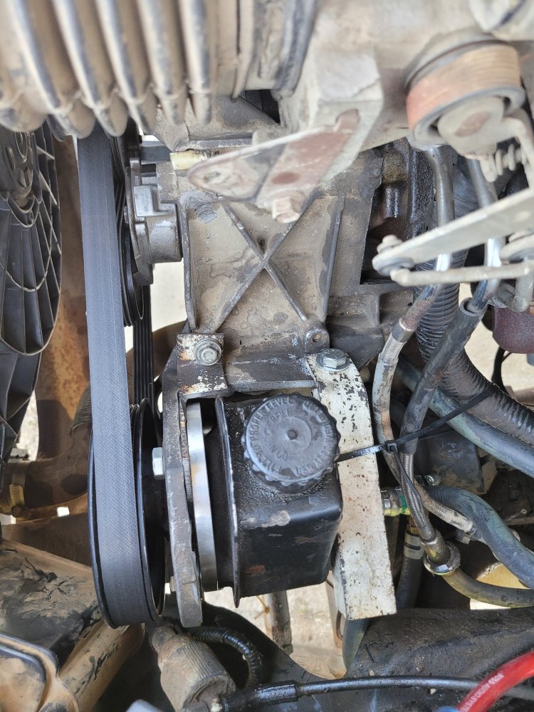

Here is the power steering pump bracket I cobbled up. Seems fine, time will tell

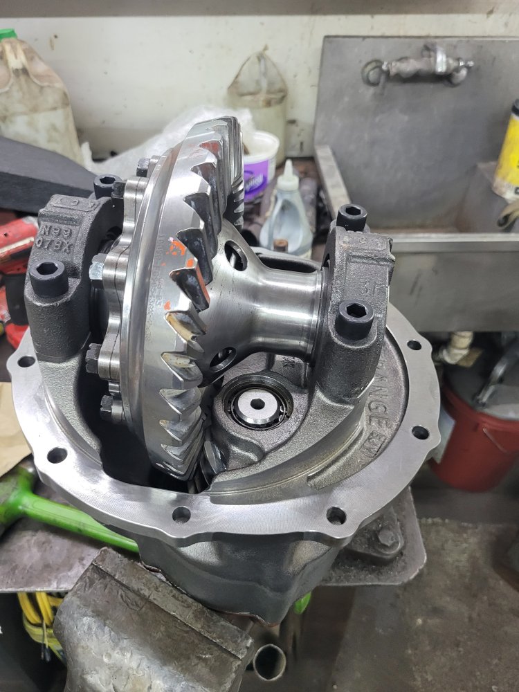

Here is the locker and gears I bought used as well has the nodular third member required for the racing locker's larger bearings.

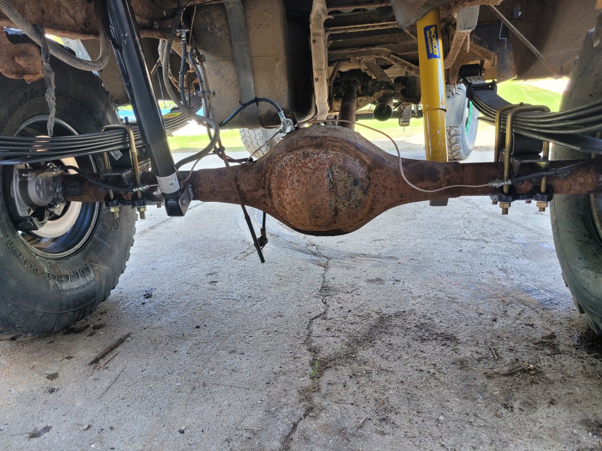

Here is the picture of the axle in the truck.
As you can see the shocks don't match.
Yes I got a good price on them and yes I'm that cheap. The brakes are 94 4wd ram rotors with 89 dodge d150 calipers and pads.

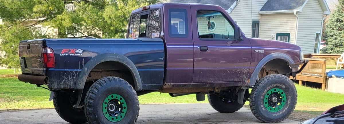

And finally a picture of the truck as it sits now. Tires are just whatever 35s i had around hopefully be getting new ones soonish

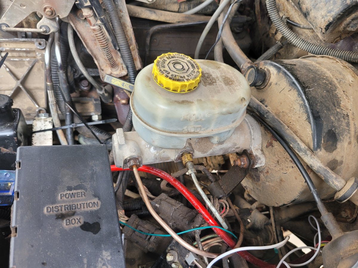

After my test drive yesterday I determined the master cylinder was to small. I read a post on Midwestnomads about a project lone ranger doing a swap out of a 99 ram 4x4 gas. Lucky me in parting out a 99 ram! followed the inductions in his post its pretty much a direct swap just have to shorten the rod 1/8 inch. Fittings all hooked right back up. Brakes are great now.

I'm surprised there's so much info on here about doing the 85 F350 master swap but none about this one. The F350 master swap seems far more complicated considering our Rangers use metric fittings, and the F350 master does not, plus the ports are on the opposite side of the master and it needs to be modified to even bolt onto the booster.
That being said, I looked up the article you're referring to about the swap. Was there anything you had to do other than modify the pushrod? I know with the F350 master swap people say you have to swap the lines front to rear compared to the stock MC for it to work correctly. Did you have to do that with this MC? From my research it looks like the 99 Dodge 2500 master uses the same size metric fittings as the stock Ranger, so if you don't have to swap them like you do with the F350, that would be the closest to a bolt on upgrade possible I think.
Nope just shortened the rod 1/8 inch then threaded it all the way in. Other than that it's plug and play. No need to swap lines around.

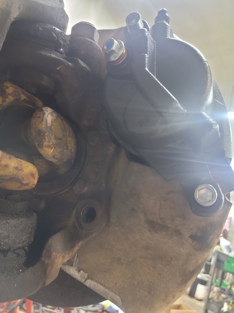

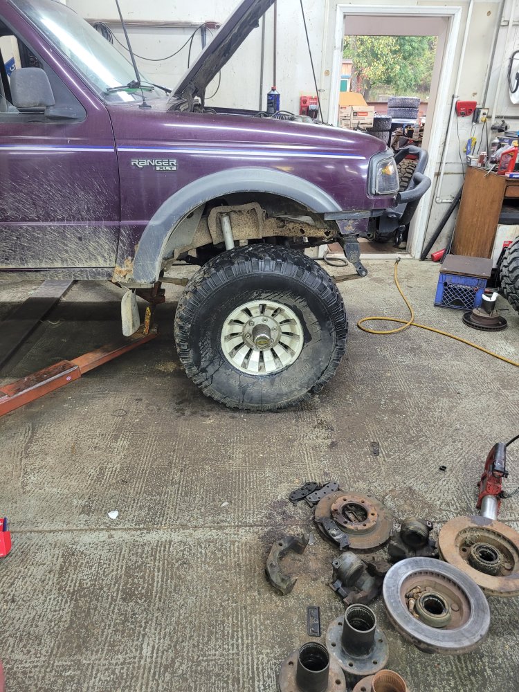

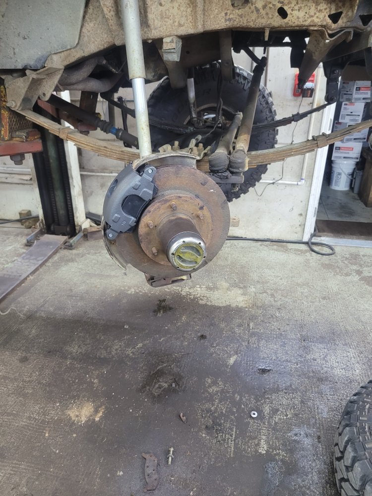

The dodge brake caliper brackets are hosed. Swapping to chevy calipers. Hit some snags but I've learned some things. After grinding some of the dodge knuckle off, the chevy caliper bracket fits. The dodge hub is offset incorrectly. The chevy hub fits but I don't want 6 lug. Ford 5 lug hubs will fit with the 73 to 76 chevy spindles, but I don't have any. I've put the chevy hubs on so I can get it off the lift until the spindles come in mid next week. I had ford hubs in barn so its not a huge deal.

I drove it to work today with wagoneer wheels up front. The correct 1973 to 1976 chevy spindles should be in tomorrow and then Ill swap back to 5x5.5. This proves that If you where looking for a cheap way to do 6 lug high steer dodge knuckles could be an option. Unfortunately the noise I thought was coming from the brakes is actually coming from the trans. Looks like i need to get that nv4500 built soon.

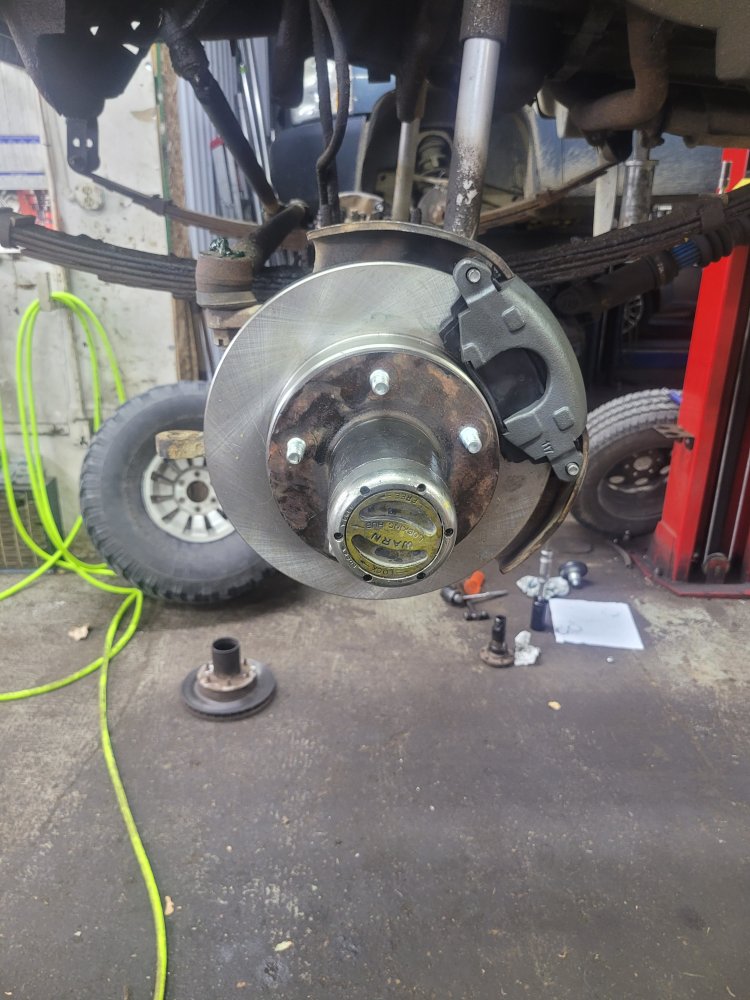

73 to 76 chevy spindles and 77 ford rotors and hubs are on and fit good.

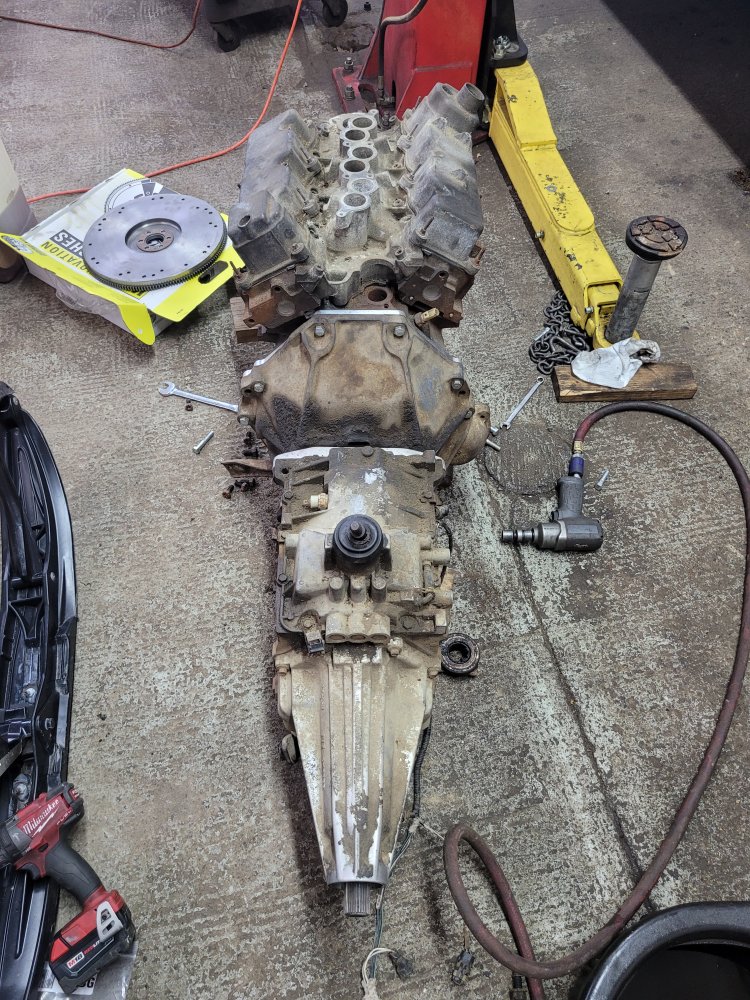

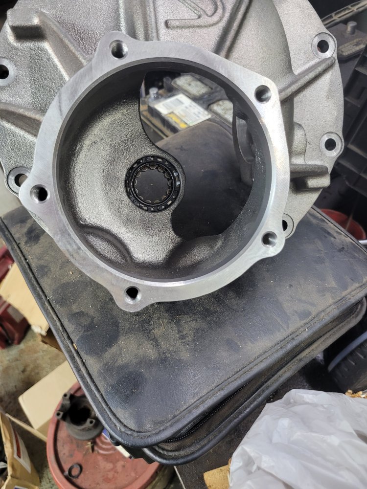

Finally getting started on transmission swap.
Test fit the adapters with a junk motor yesterday.
