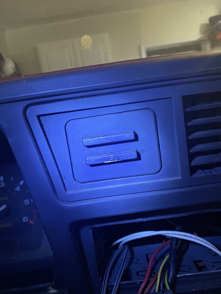

Is it normal to have the e-selector button tray on the dash in tandem with a manual transfer case lever?
The buttons are blank, no 4x4/Low written on them, but there's have a noticeable click when I press them.
From what I've seen on junkyard Rangers, there's usually a fake vent that goes there.
There's also no feeling in the shift when I move the lever and the 4WD does not engage.
Additional info, I've got manual hubs, FM146, and a non-functioning speedometer.
It does not appear to be the dummy case.
Sounds like somebody has been mix-and-matching at the junkyard.

I took a razor blade to the button to see if there was originally an "on-the-fly" that's painted over.
Nope! Definitely wiring something into those slots. P38 Rover style air lift came to mind.

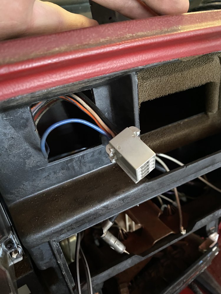

Well... this is mildly embarrassing...
In process of pulling the dash and found this little guy.

Not really. They often used the same wiring harness for vehicles with different options and just left the extra connectors clipped into little brackets to hold them in place. Unused fog light wiring is another common find.
Someone's been swapping parts and pieces around hacking things together to get working 4WD. Hate when people do stuff like that it only leads to a nightmare hack wiring system to try and figure out in the future usually after the previous owner gave up on their own mess the next owner has to figure it out.

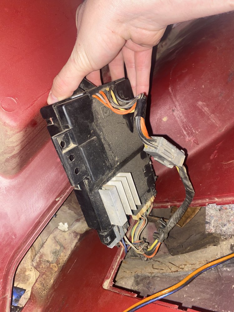

The control box. Do you have the electric transfer case with the motor on it?
Given all the hackery, its a fair bet the current case doesn’t have a motor in it. I’ll crack it open when the chassis is separated to confirm.
Where is the control box located?
The transfer case motor would be on the outside. If you have a manual shifter to shift it, then it does not have the motor for electric shift. You would need a different transfer case.
Not sure where the control box would be in your truck. Mine is behind the driver seat.
I'm not sure there is as much "hackery" as you think there is. We have explained that the extra electrical connectors, dummy button panels, etc. Are common. In vehicles of that Era, it was easier and cheaper to manufacture one wiring harness that included wires and connectors for almost every possible accessory and install that harness in every vehicle. Then, accessories and features were either installed or omitted as necessary per the build sheet for that particular vehicle. The wiring already installed. Need fog lights? Install the lights, switch and relay. Voila! Fog lights.
