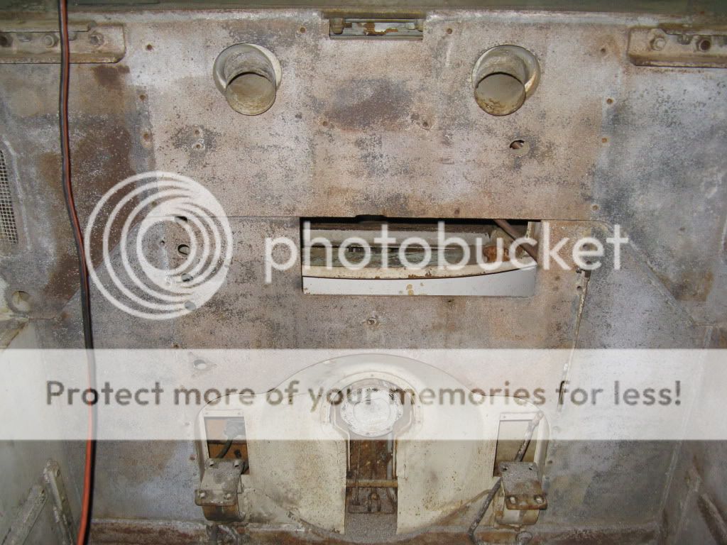

Biggest Ford I've ever worked on...

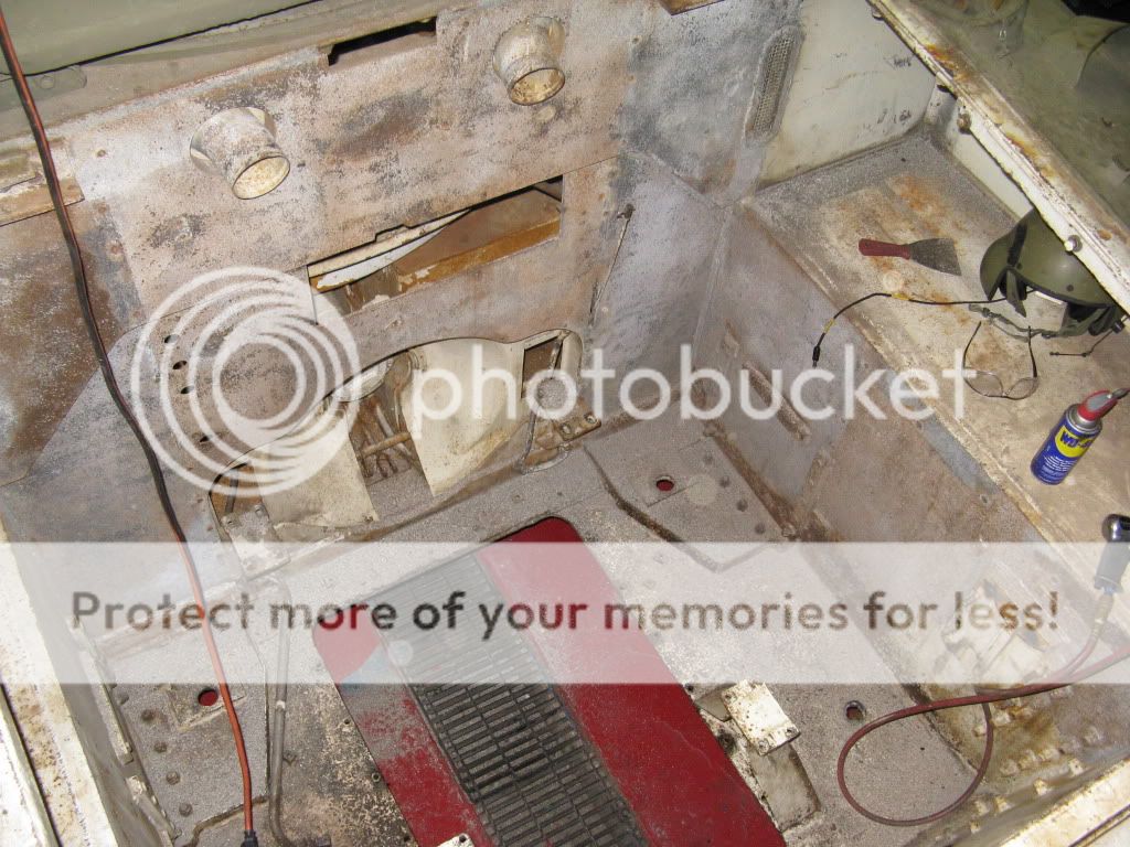

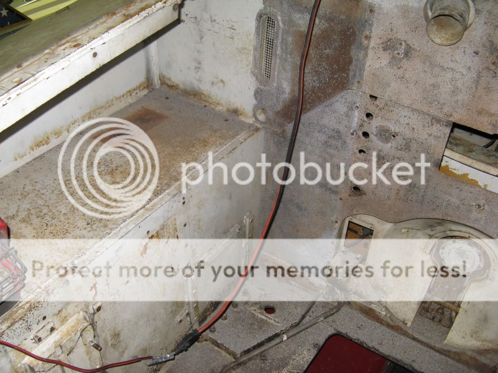

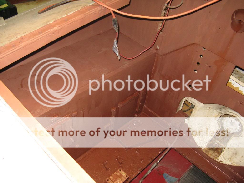

Started scaling the engine compartment.

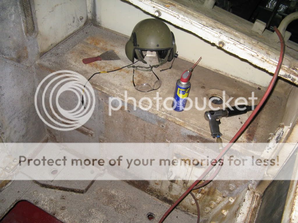

And yeah, that's my bitchin' helmet. It blocks out the noise very well, keeps the paint chips off my head, and prevents injury in sudden moments of retardism (haven't had any of those yets). Only reason i'm using it is for the sound blockage. I didn't have any other hearing protection laying around at the time.
Progress was slow the last two days, but it's further than what the pictures show since I didn't take any today. Spent more time working on a snow blower this weekend than the tank, but we're expecting around a foot or more this week.
It'll be another two weeks before further progress is made. I'm going away the next two weekends, and I work all the other days.

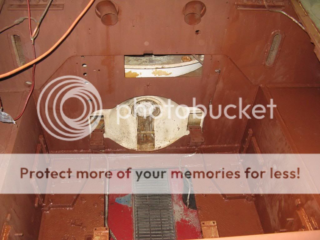

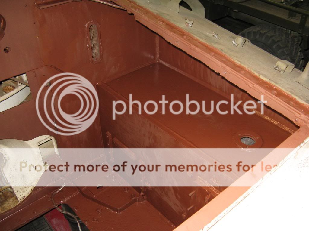

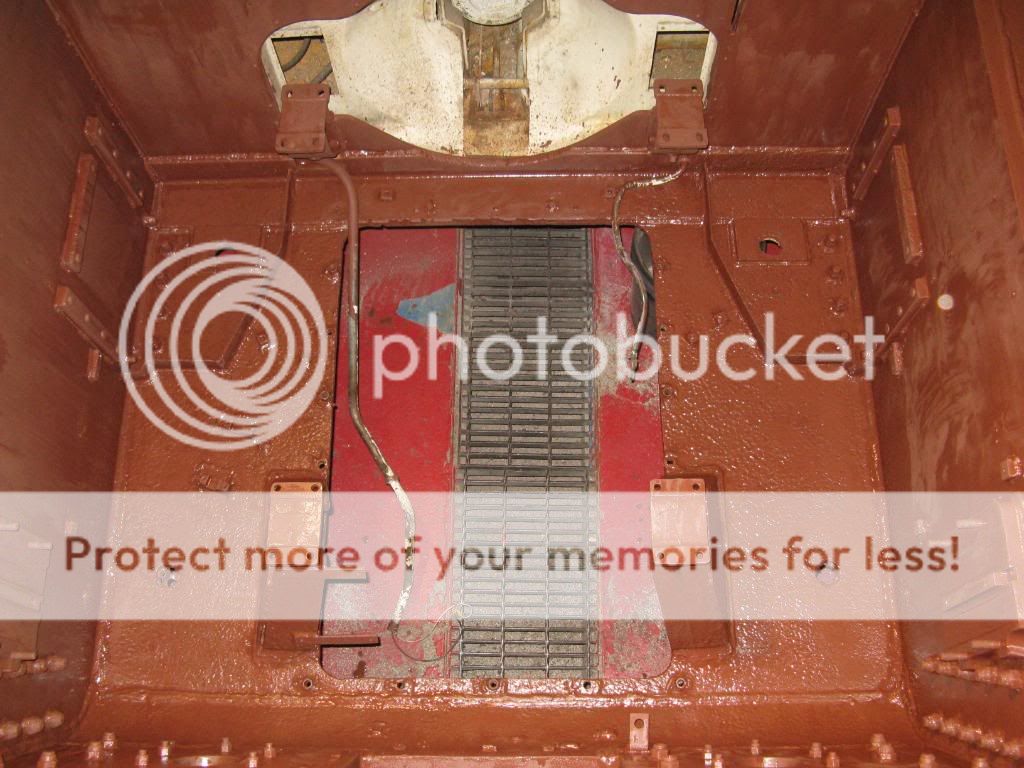

Finally got the rest of the paint stripped, sanded the whole compartment, and brushed on the first coat of primer. Still mostly wet, obviously.
Now to sand it again, put a second coat of primer on. Then on to that nice bright white paint to give it that fresh-off-the-assembly-line-in-1944 look. :icon_thumby: :icon_welder: :icon_hornsup:
Oh yeah, the clutch housing...which is the only thing still white besides the fighting compartment, will be stripped and painted when we do the fighting compartment.

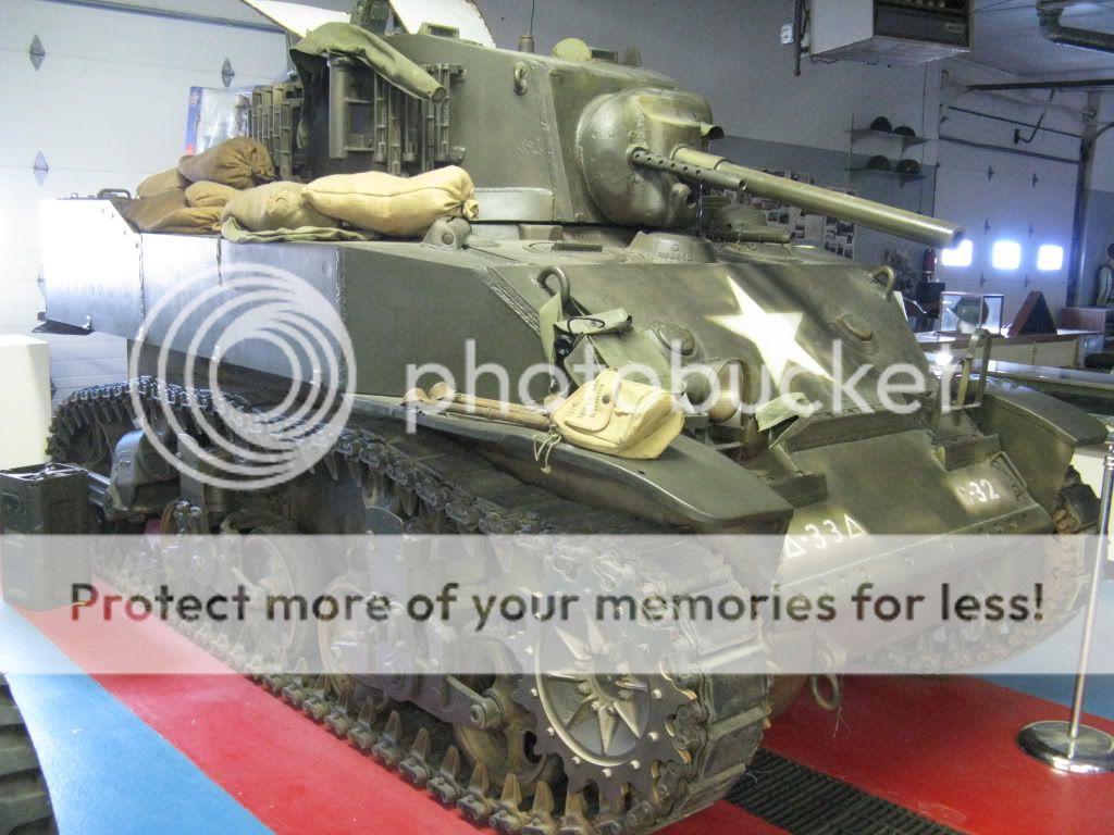

Here's a pic of our M5.

The M5 had a 37mm gun, and had the twin caddy v8's. The Stuart light tanks at the beginning of the war were the M3 and M3A1 and were 7 cylinder radials. The M5 and M5A1 replaced the M3 variants.
