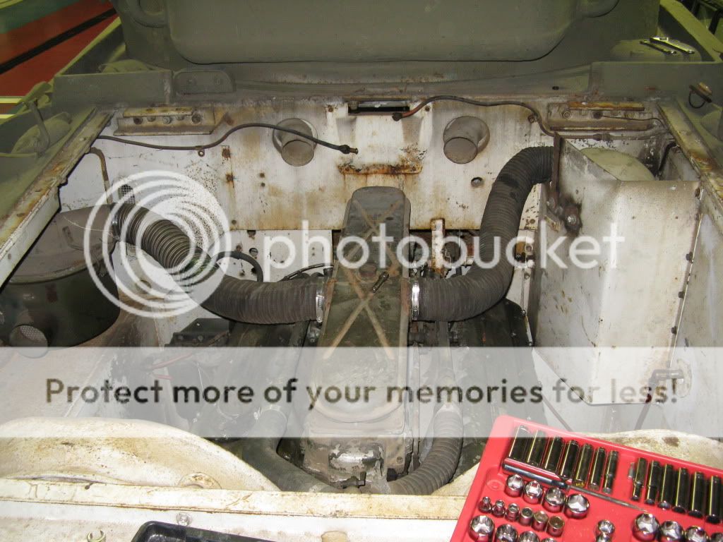

Continued the project...

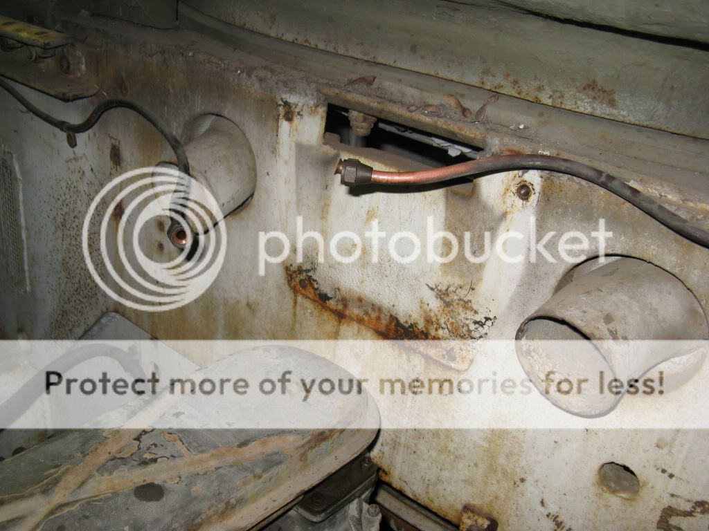

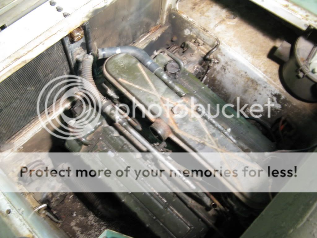

Drained the 14 gallons of coolant, removed the water pump, disconnected ignition wires from magneto's.

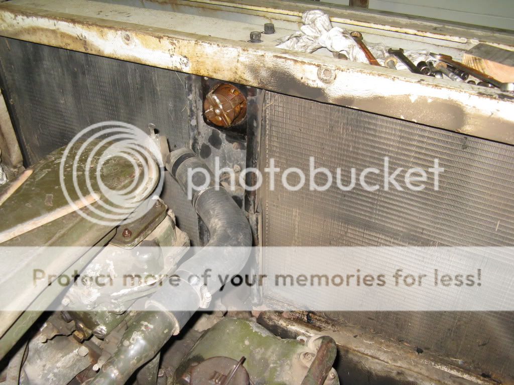

Removed the radiator expansion tank.

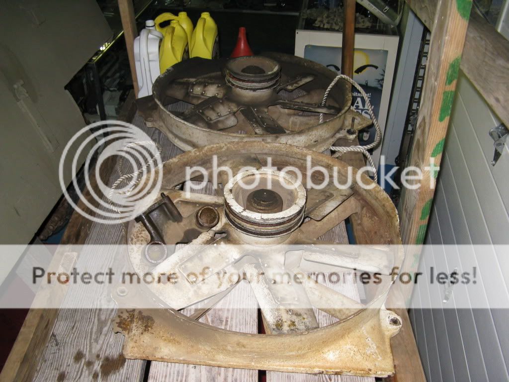

Removed cooling fans and shrouds (weighing over 100 lbs a piece and lifted by hand), and radiator inlet connection.
Removed radiator outlet, air intake hoses, disconnected fuel lines and drained fuel tank.

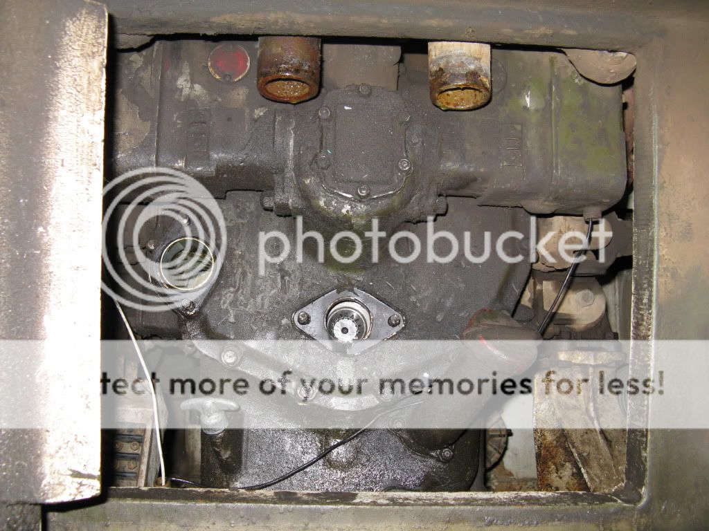

Next time is the hard part, all the hard to get at and remove bolts. Exhaust manifold to downpipe connection bolts (rusted like crazy), engine mount bolts, cooling fan drive shafts, as well as the main driveshaft. After doing all that and pulling off the front carburetor and throttle linkage, it's ready to pull. The main driveshaft has to be accessed through the rear of the crew compartment, behind the turret basket.
More to come in a couple days...:icon_welder:
