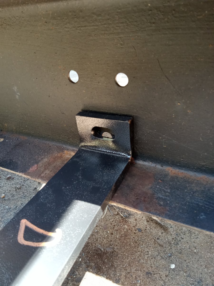

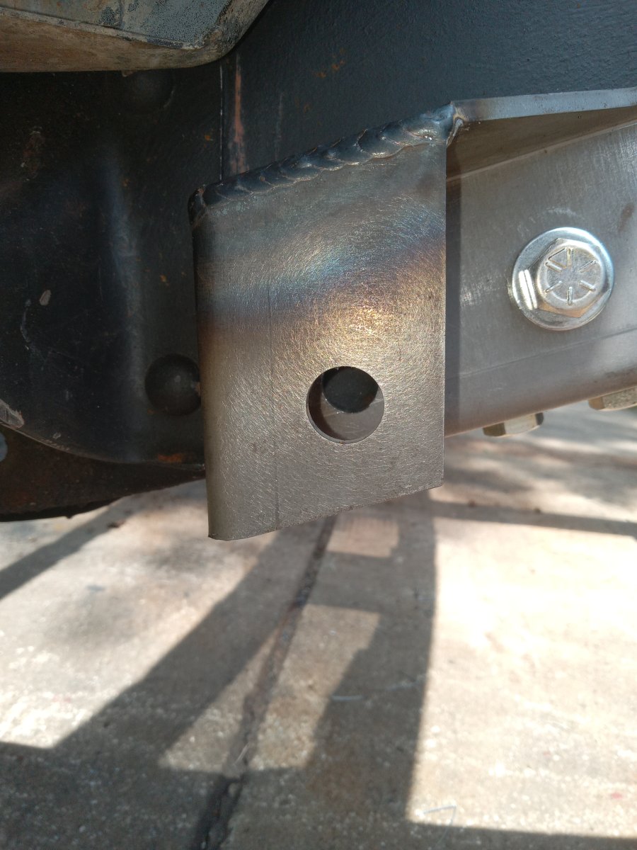

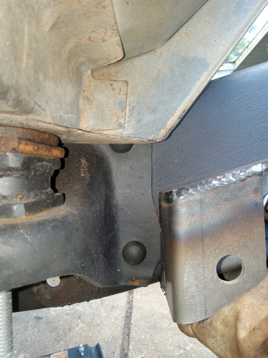

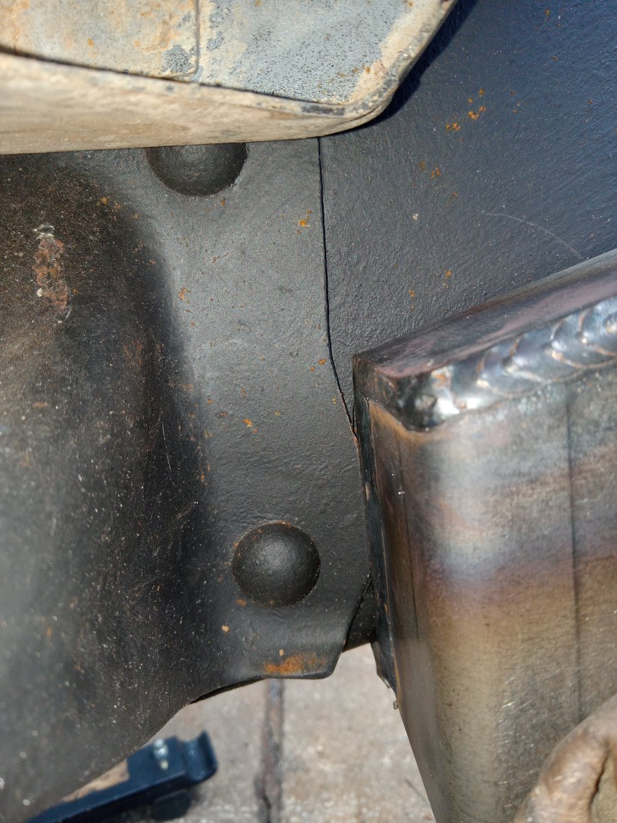

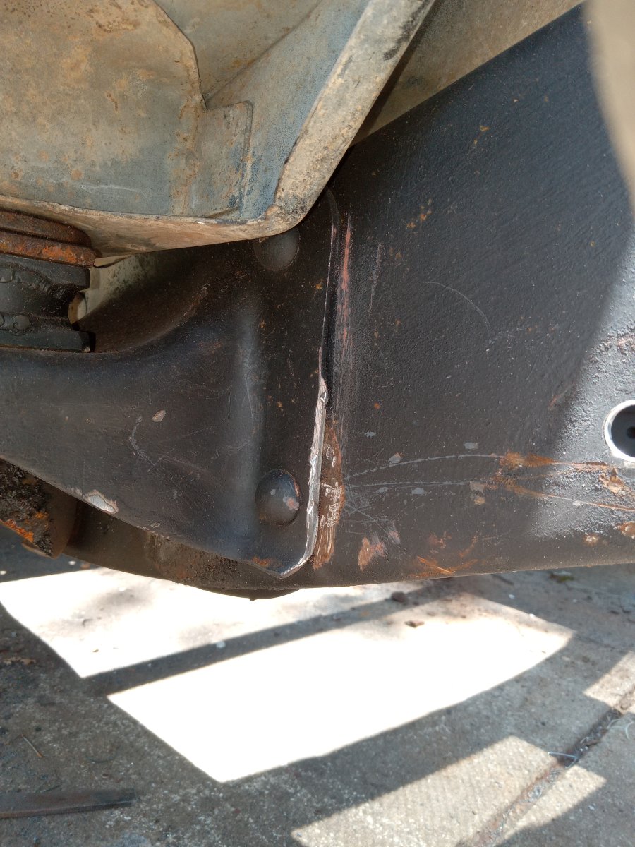

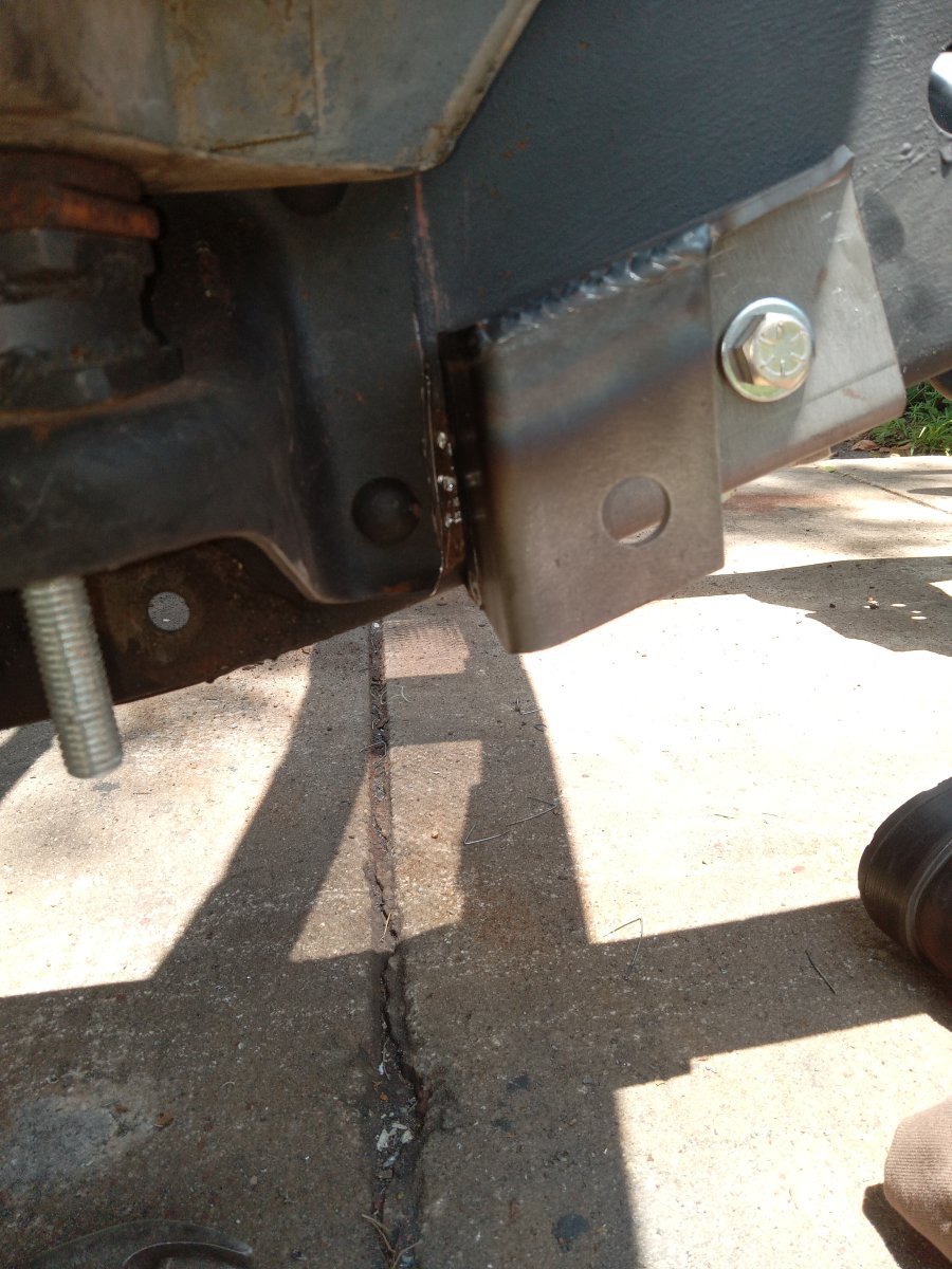

After the transmission cross member situation i started mount the raised radius arm mounts before i paint them. they fit perfect but i did have to trim the edge of the front cab mounts in order for the radius arm mounts to sit flush.

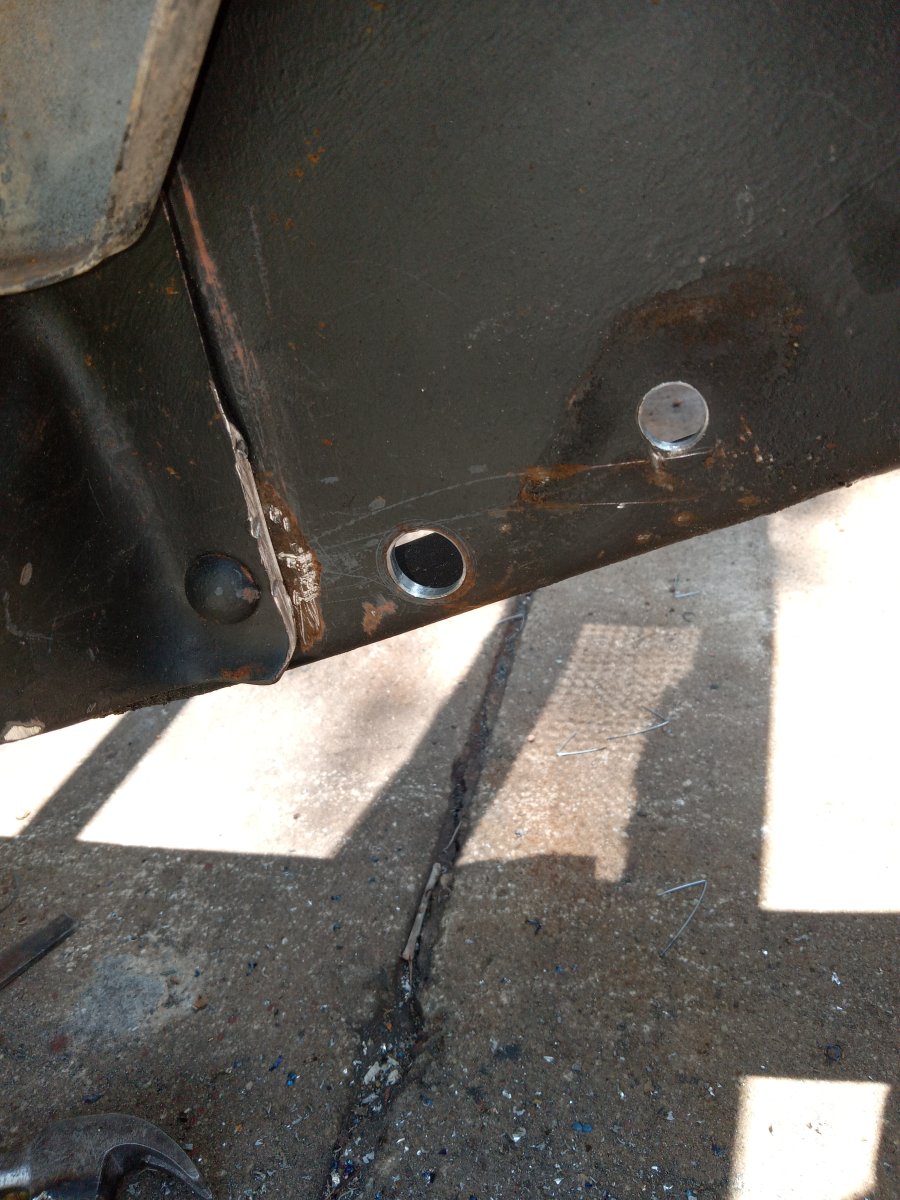

I did have to enlarge one hole and drill another additional hole

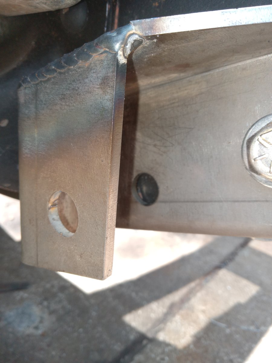

tried to install the raised transmission cross member today and noticed that the holes are a bit off, so i decided to hold off on modifying it to fit correctly until i mount the motor and transmission in the spot i like, just in case i need to move the cross member farther back from the stock location.

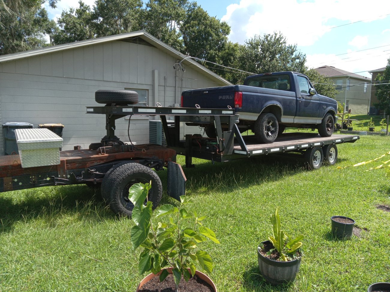

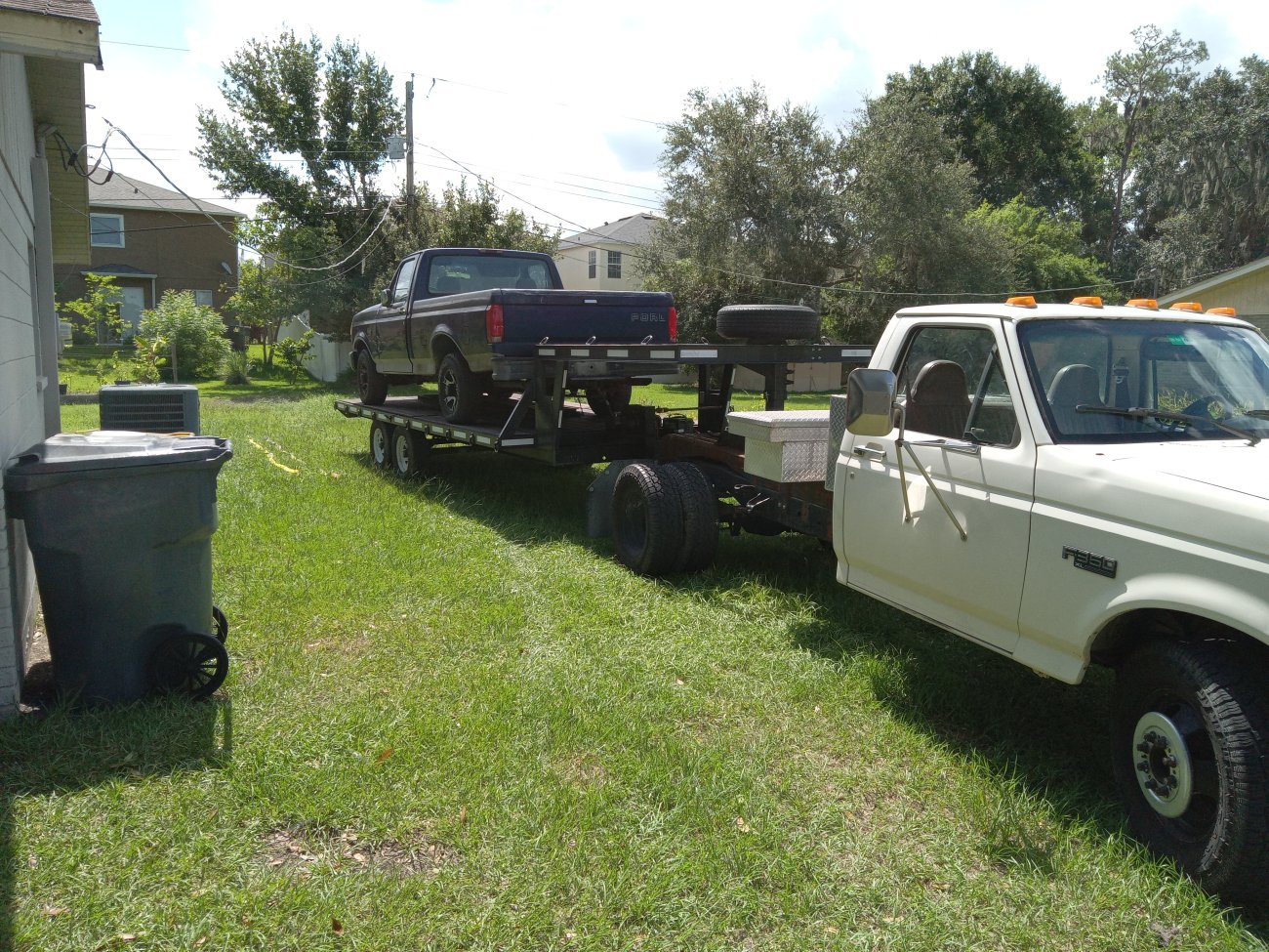

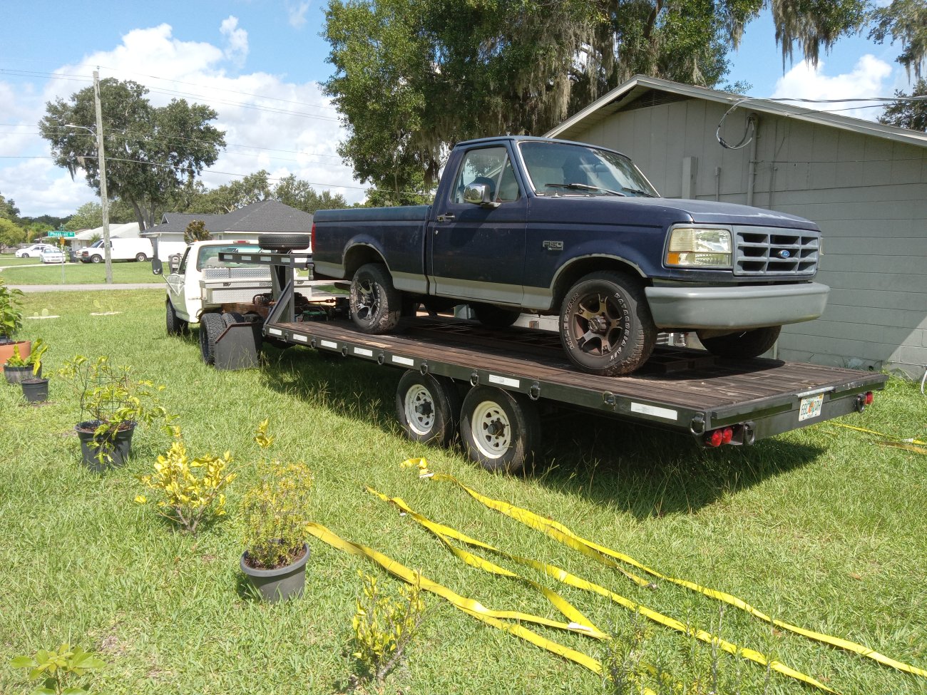

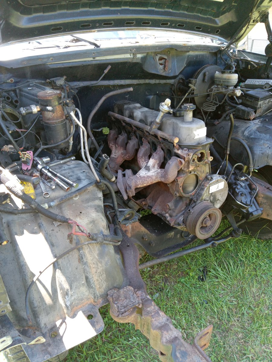

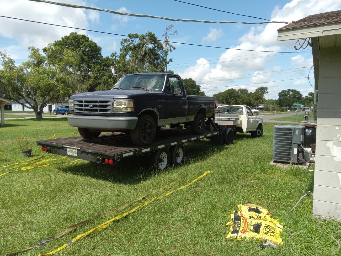

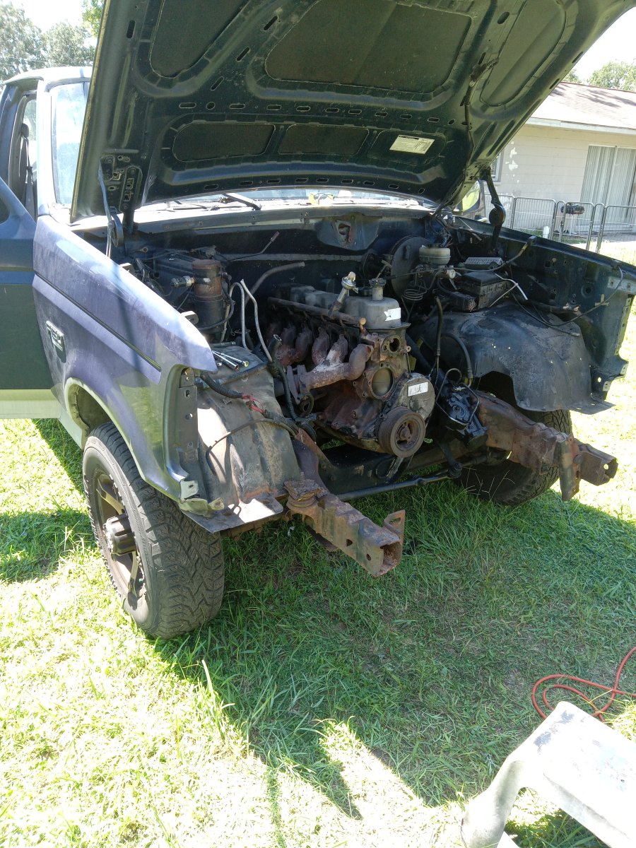

well the plan has changed. when searching for a manual transmission for the 460 i found out that the prices are too crazy. i had a choice: $2000 for a rebuilt Ford ZF5 speed or $1700 for a 1994 f150 with a 300 straight 6 with a 5 speed, and a clean title. I chose to get the truck.

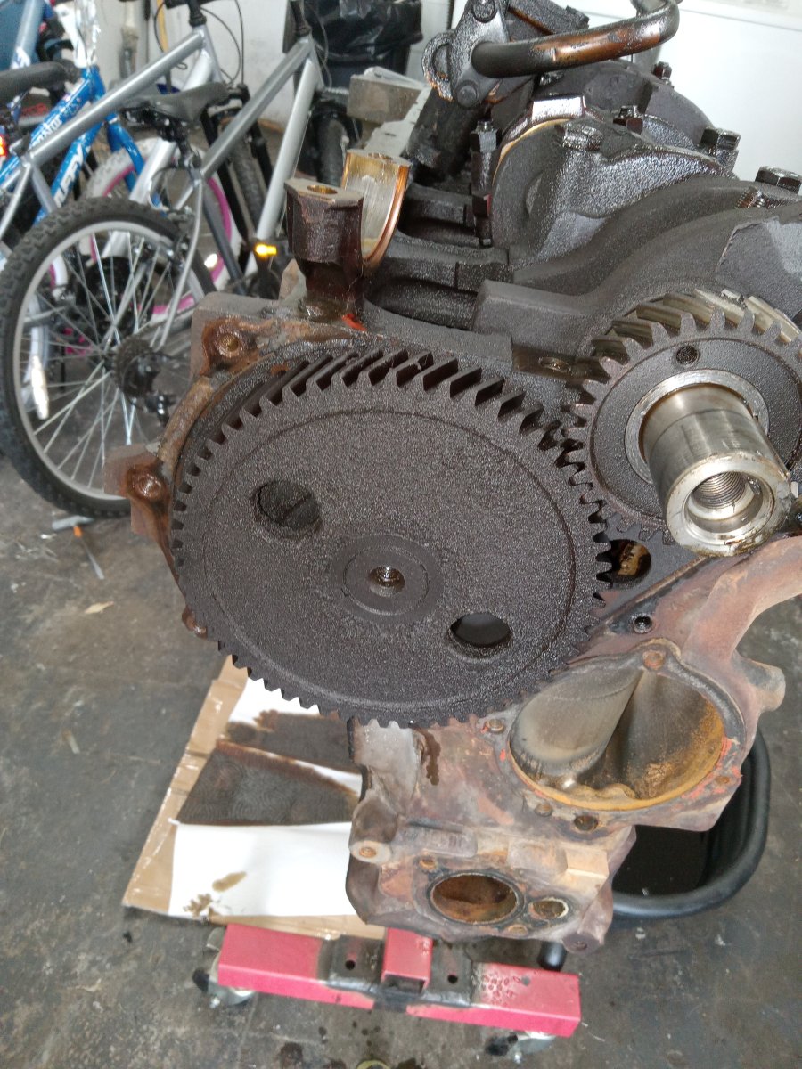

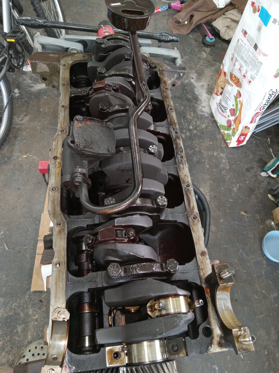

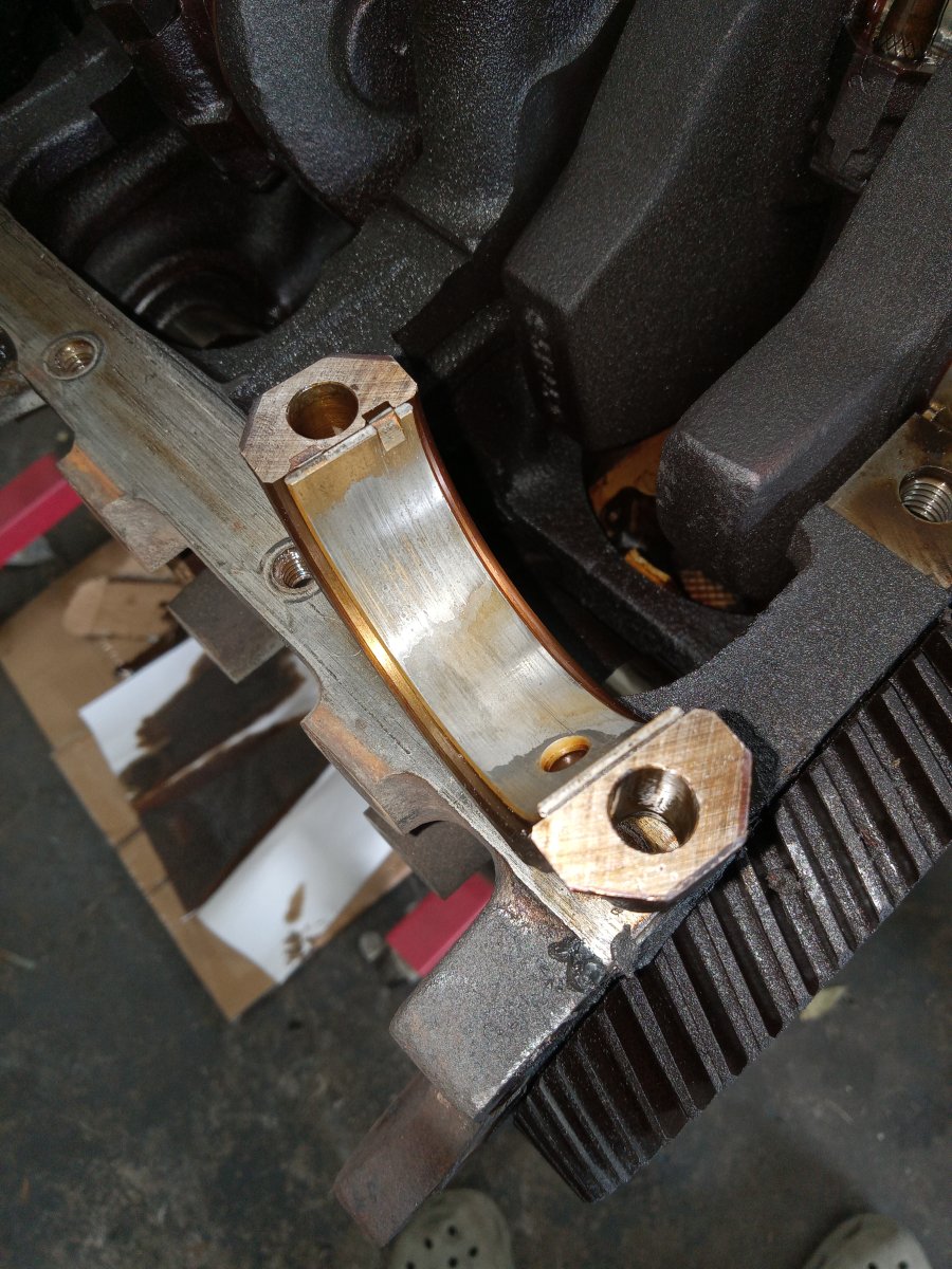

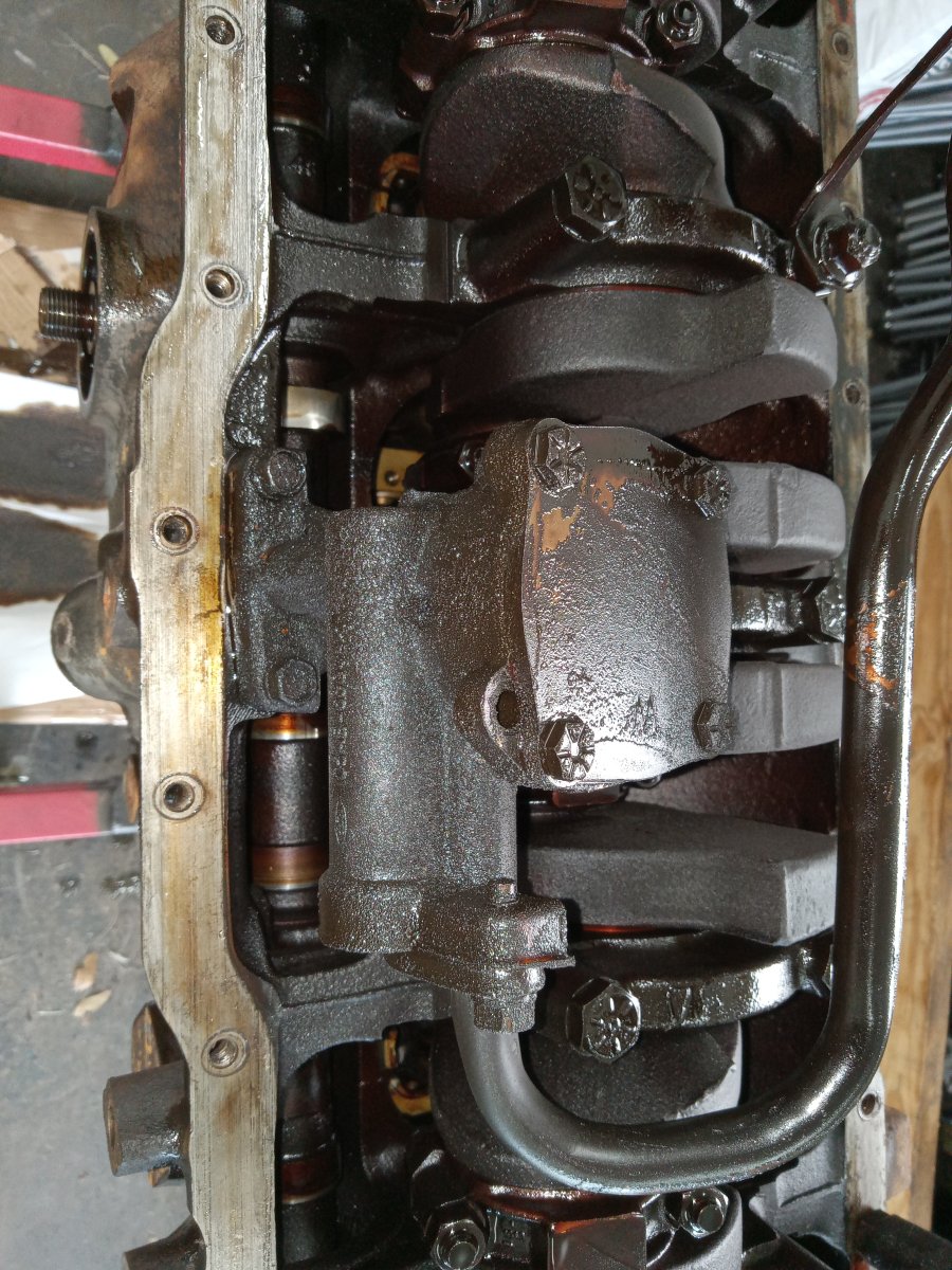

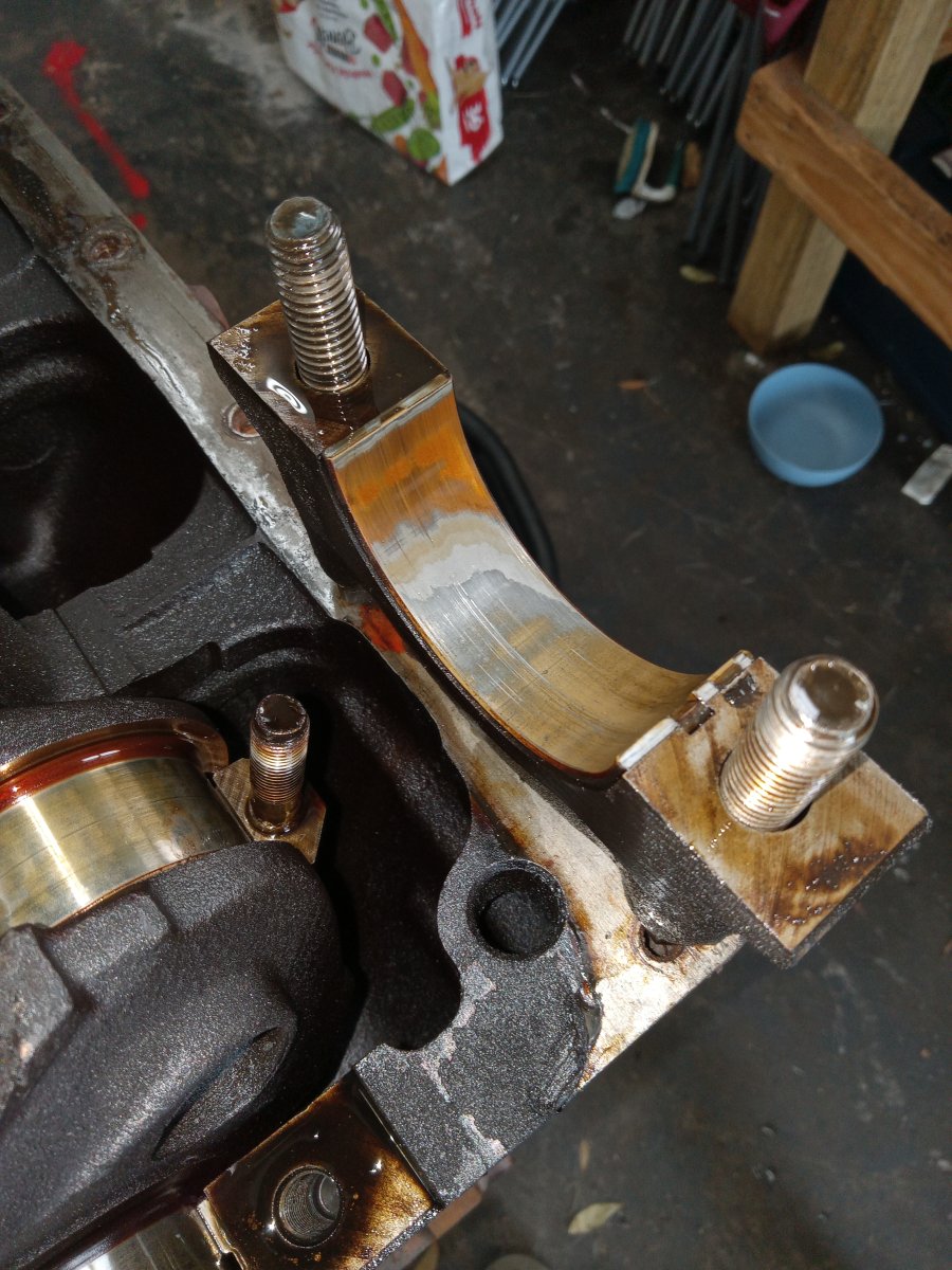

did some work on the engine. the plan is to do a simple rebuild. replace main bearings, rod bearings, piston rings, cam bearings, bigger cam, new lifters, deglazing cylinder bores, and paint.

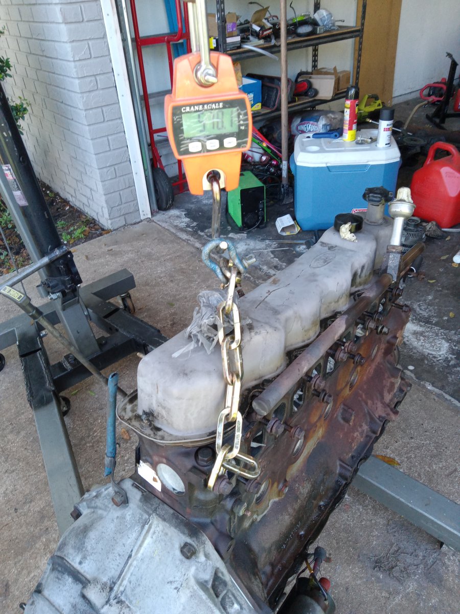

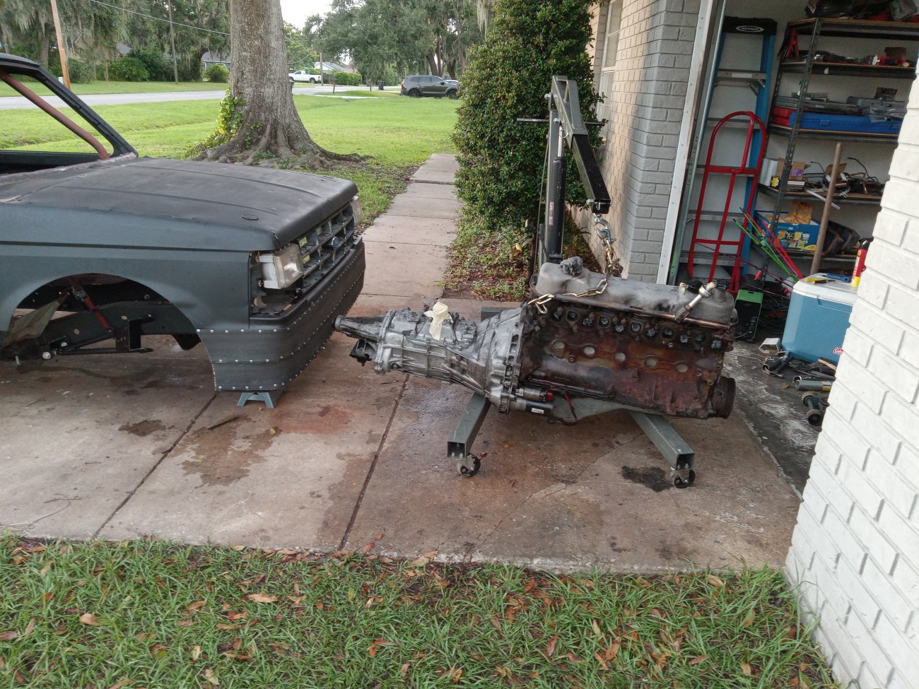

here if the wet engine weight of the engine and transmission

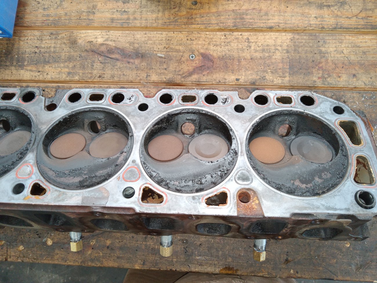

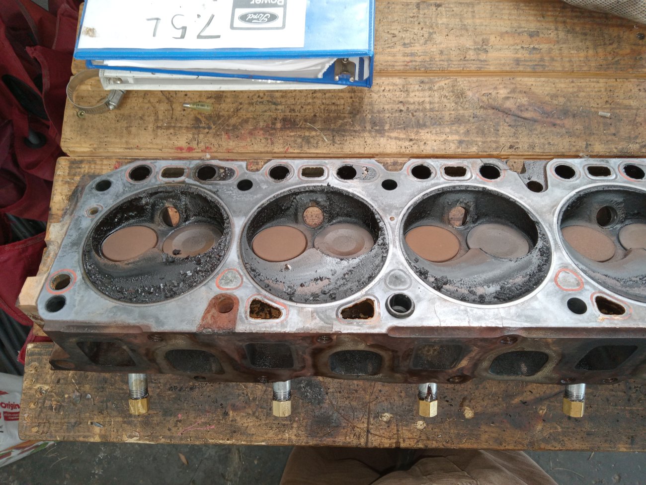

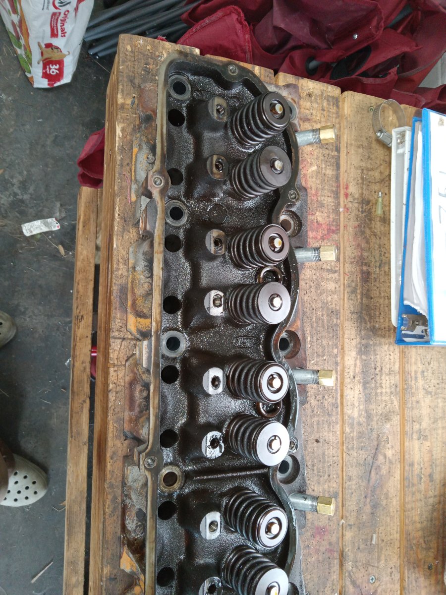

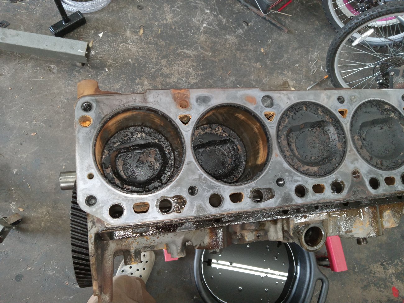

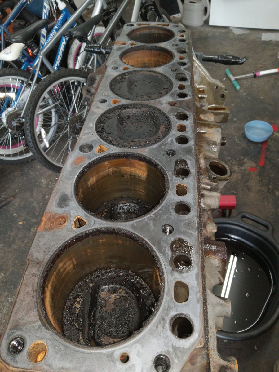

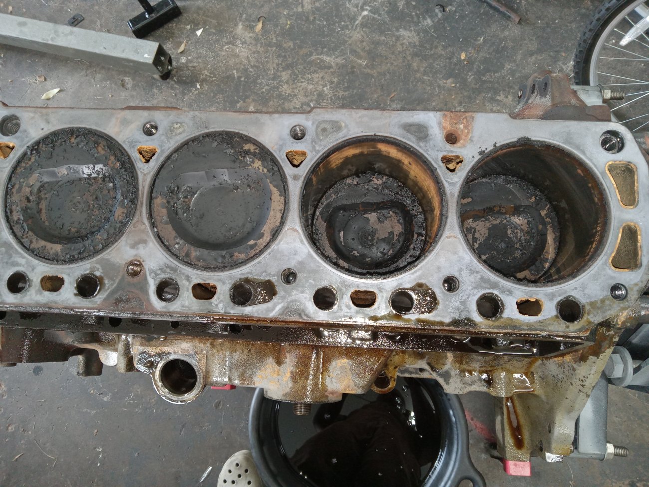

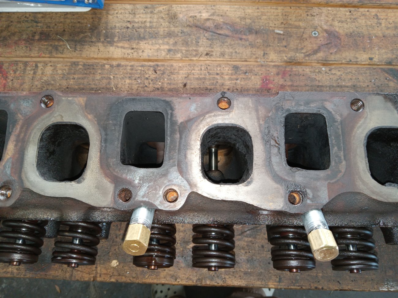

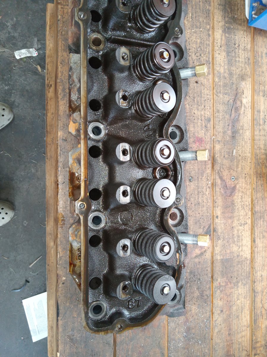

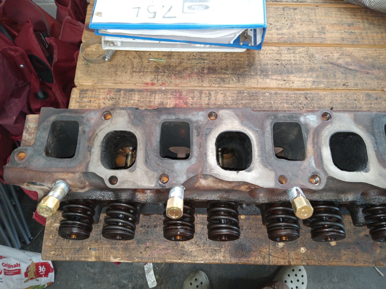

if you ever wanted to know what the smog pump system does to your engine, take a look at the pics

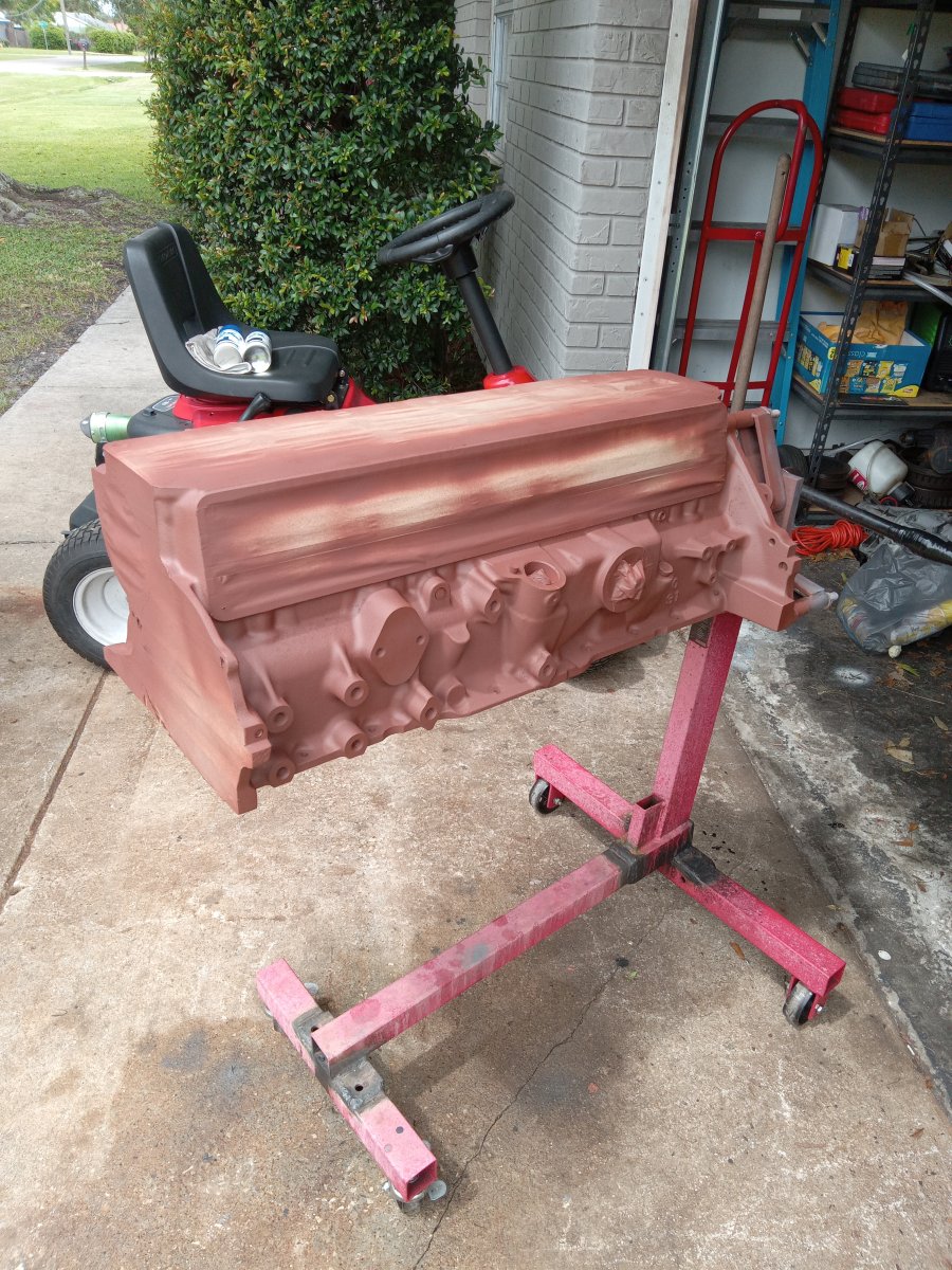

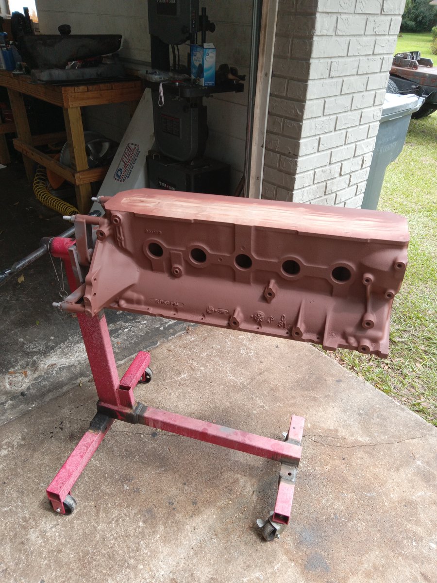

after hours of cleaning the block got a layer of primer.

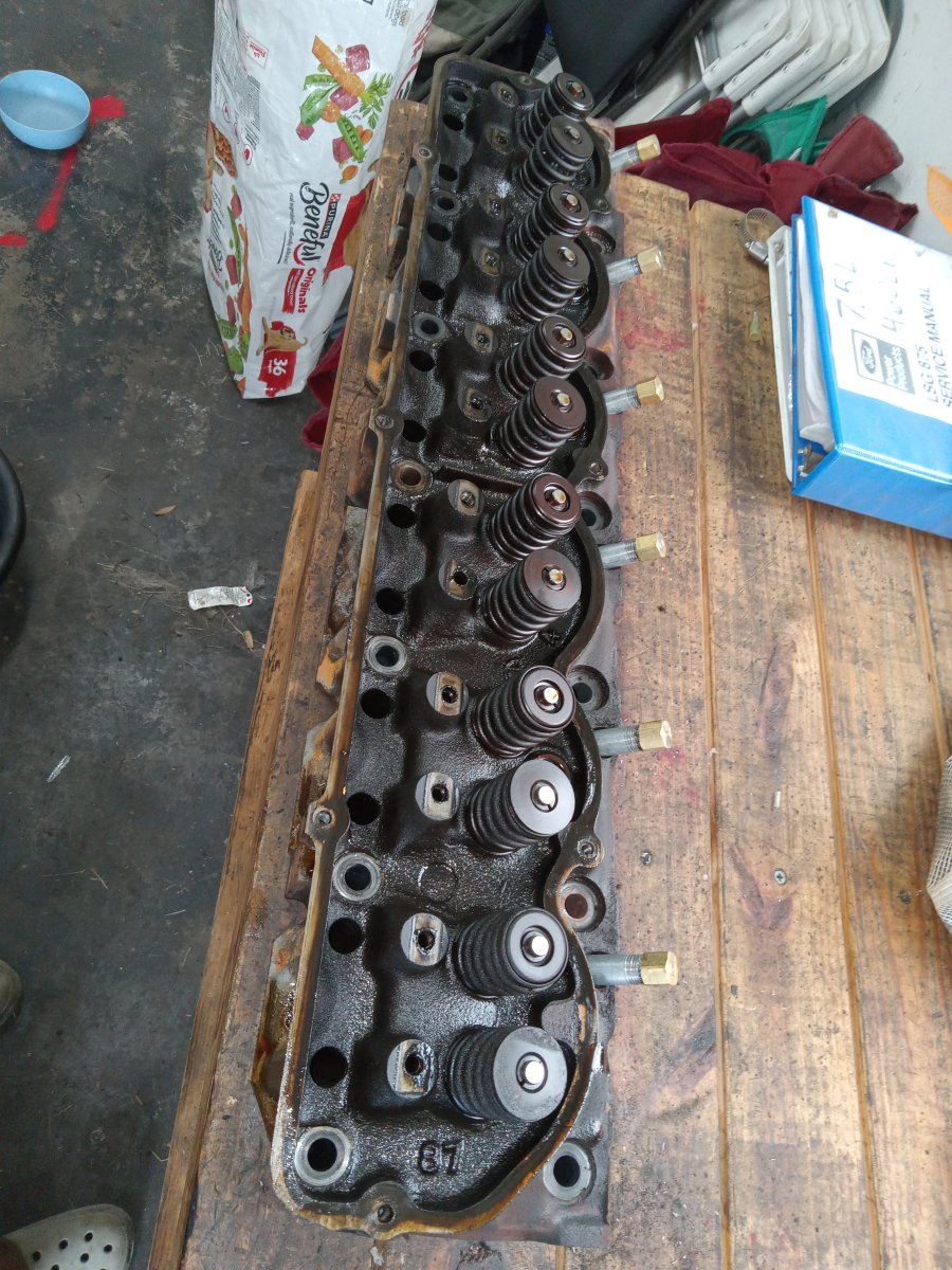

Looks like you may have 1 or 2 exhaust valves receding.
