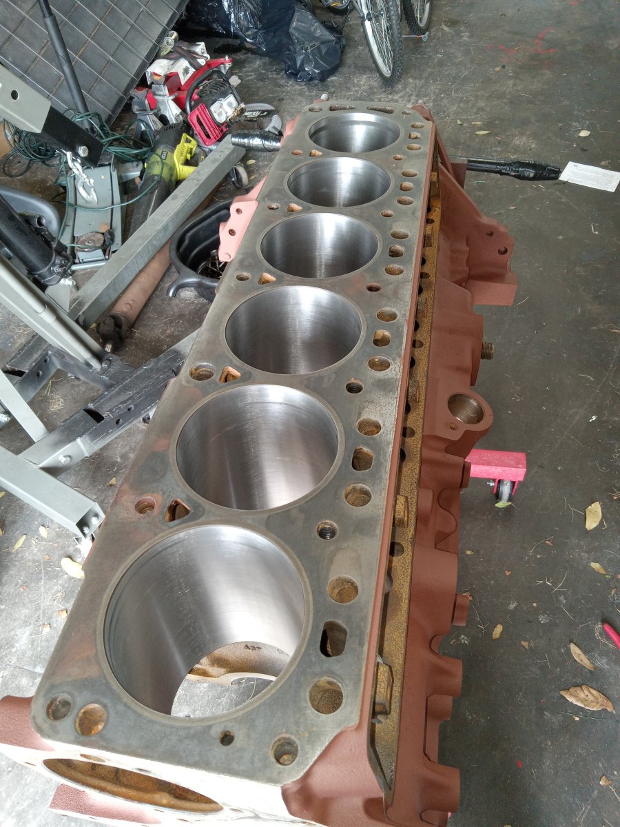

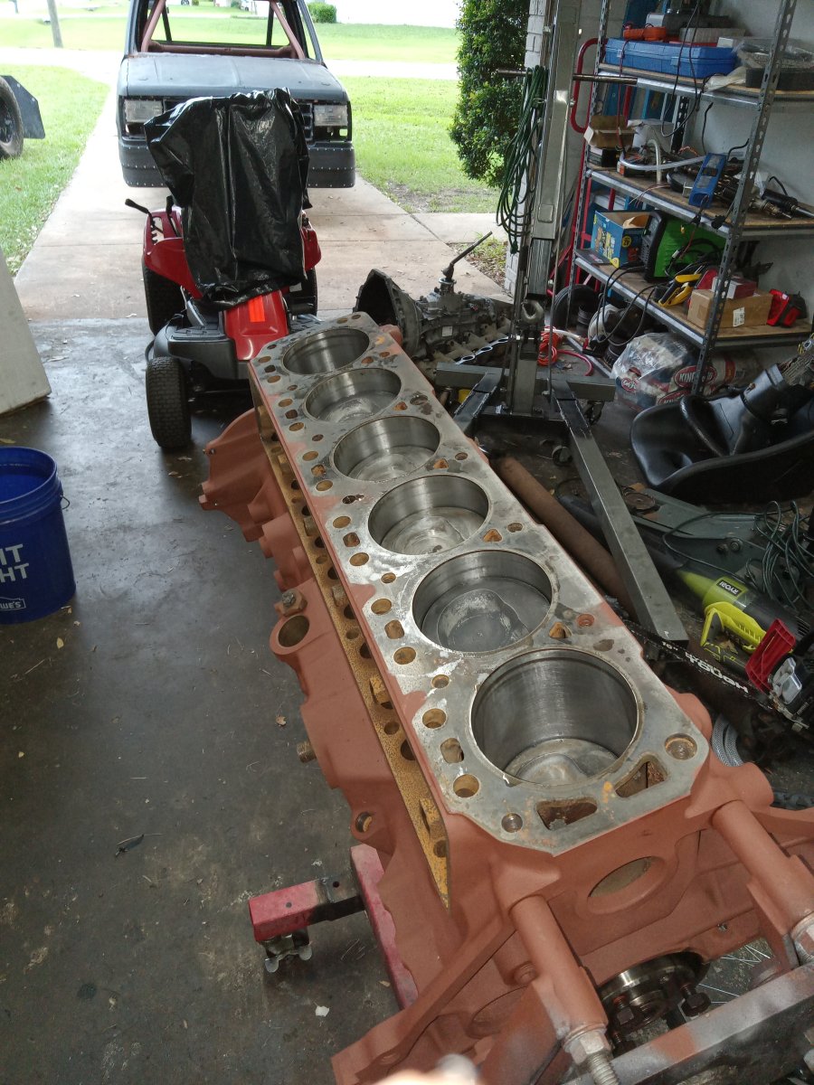

Looks like you may have 1 or 2 exhaust valves receding.
they are good, its just there is a thick layer of cabon and it started pealing. had a hard time getting the head to separate from the block so i had to use a hammer.
The connecting rods have been stamped and are out if order so i know it has been rebuilt, im just surprised at the amount or carbon inside the motor.

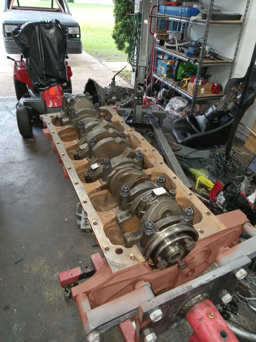

deglazed the cylinders. there is still a small ridge on some but its good enough for this mild build

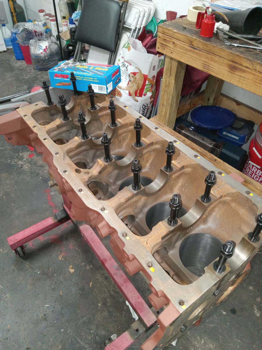

Did a test fit of all the major parts and double checked that i have all the correct bolts, and also the main cap studs came in today. They arent really needed but i plan on adding a small ebay turbo in the future.

yea im going to get some head studs too. Trying to save money on reusing head or main cap bolts can turn out bad. $250 on studs is alot cheaper than a broken crank or hydrolocked motor.

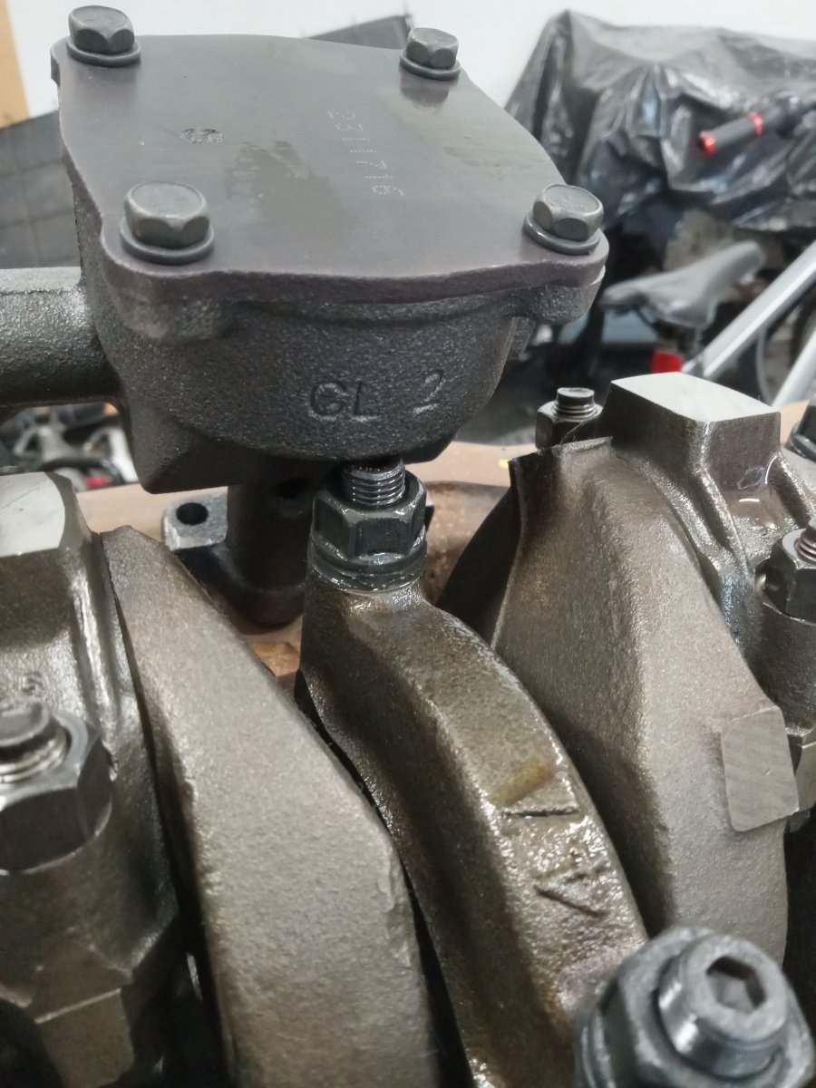

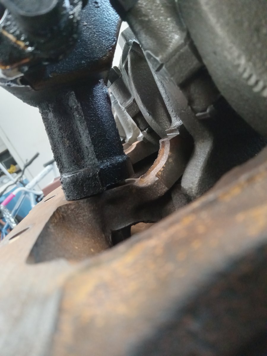

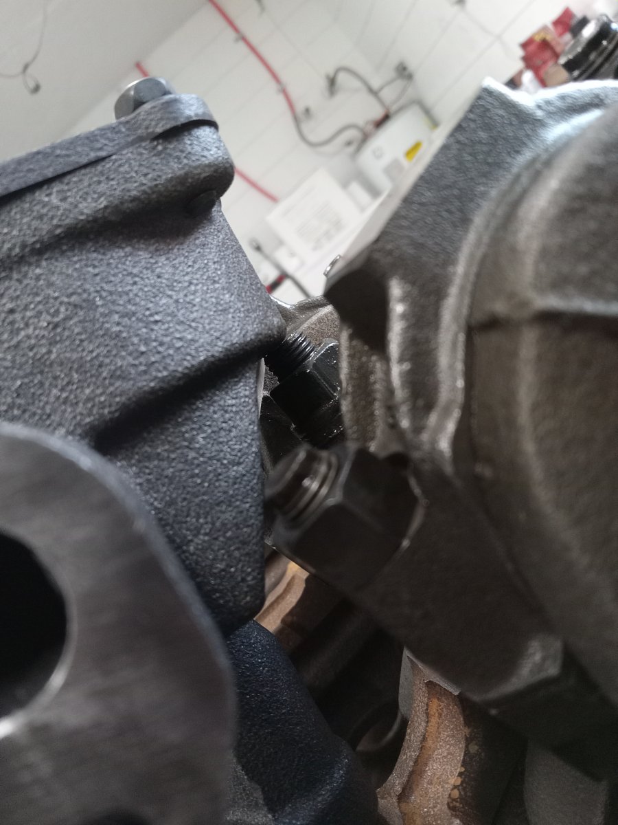

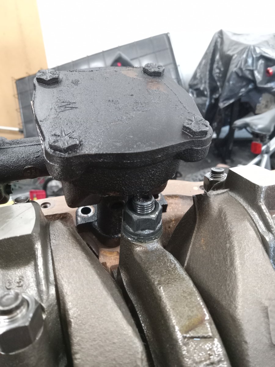

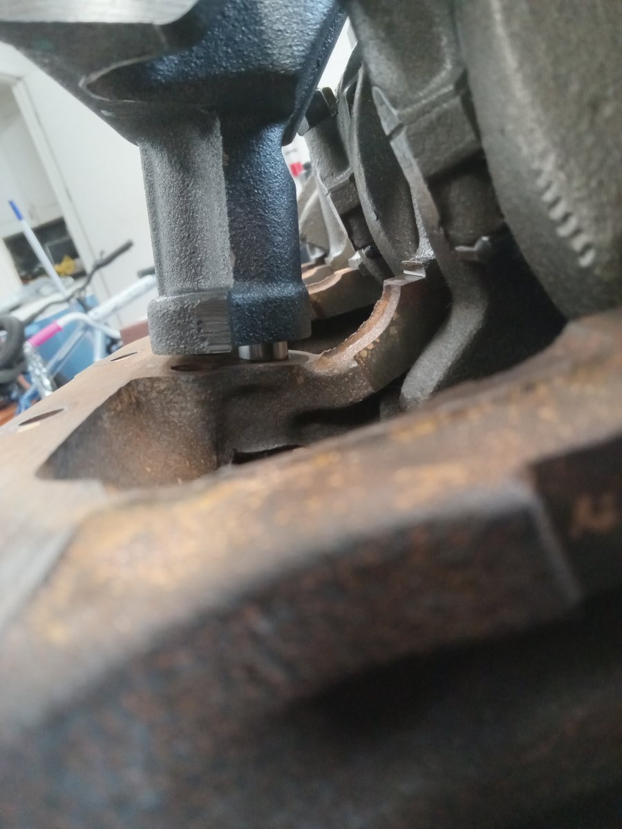

ran into a small problem when installing the new oil pump. the pump is a high flow stock pressure model from melling and its hitting the main cap studs. there is about 1/4 gap at the base of the oil pump and around 3/8 of the stud extending out of the nut. going to take the extra off the stud so it sits flush with the nut when torqued. the stock oil pump has the same clearance issue but a little smaller gap
Here is the stock Ford oil pump
