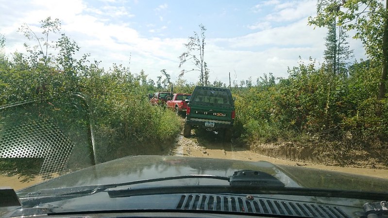

As far as lift, with a pretty much stock suspension and a bodylift on 31's I had a riot on the Vagabond trip this year.
TRS Vagabonds - The Ranger Station
