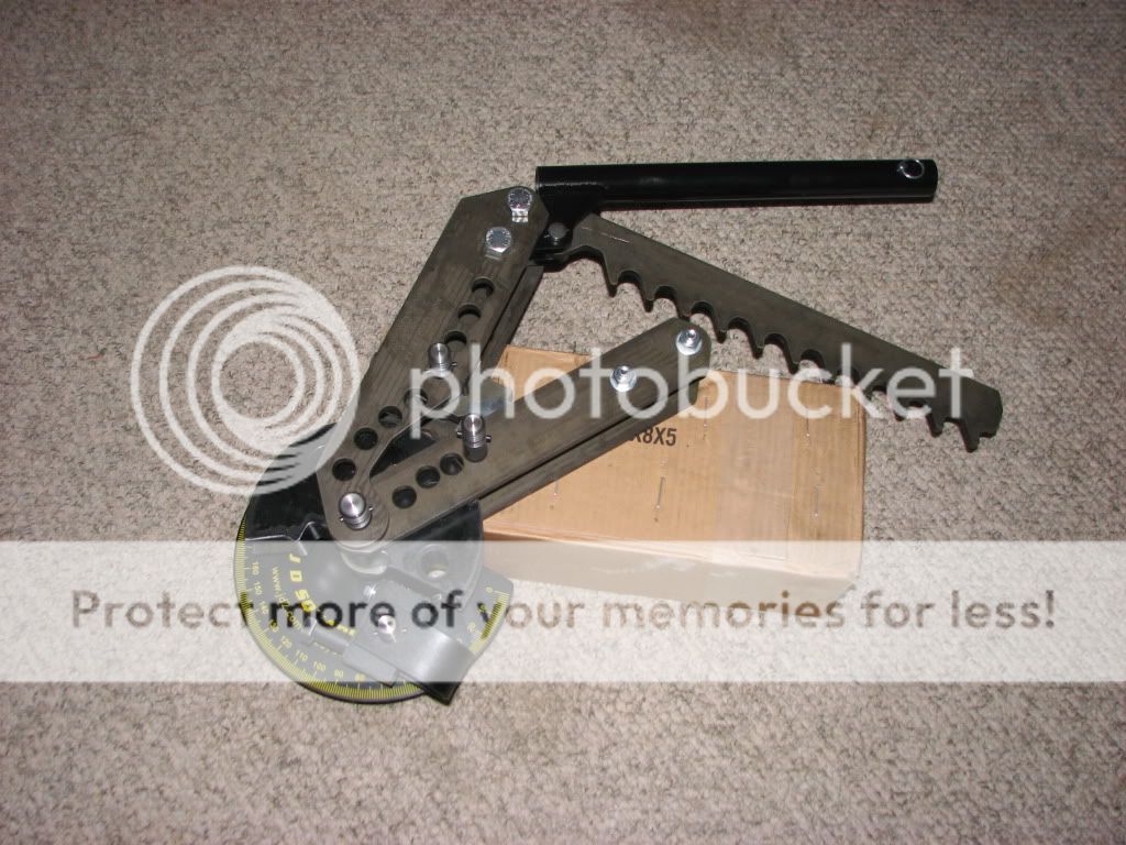

it may be out of the question but i suggest you step up to a decent TUBE bender
that bender is made for pipe which runs everything in ID, plus if you put much of bend in it it will crush and crinkle the pipe
here is the bender i just bought...$804 to my door with 2 sets of die's take $155 off with a single 1.5 die
its a jd2 model 3

I've used one of those benders before and they're not great that's why i bought the same Jd2 model 3 that someone else pictured, which I definatly recommend. However if you plan on simple bends (less than 90*) it will do OK the bends kind of stretch the tubing so the corners shrink just a little and flatten on the inside a bit, but depending on how much your doing and budget you can make decent stuff with that bender it's just a learning process.
