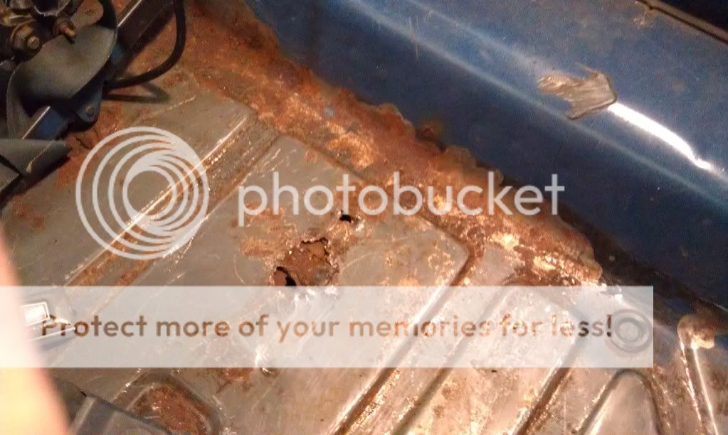

Updates to the floor are coming. Tomorrow I will be working on the floor. School and other problems have put this project on hold for a while, sorry guys. Good news is i have all the stupid roofing removed and almost have all the sound deadening off the floor. Its looking like more rust then expected :( nothing patches cant fix i hope. Plan for tomorrow is wire wheel the rust and clean up the rest of the floor. wish me luck
Sounds great- you are using roll on or brush bed liner I hope -diy spray is too thin. It did not seem too loud and since we wheel in cooler climate floor temp is non issue -this will be a great upgrade and look good too!:icon_thumby:

Drivers side
passenger side
extended cab section
ok so im thinking of buying the HF $99 welder to patch the holes in the floor. It seems like a good buy for small jobs like this one and for a first time welder. also how thick are the floor boards 20 gauge?
Another thought was buying a whole new floorboard section from LMC for the drivers side, it seems to be the worst and has quite a few holes. its $40
Buy the floor panel, it's much easier fitting than stuff not pre-bent. Check my b-II build thread for what I did to fix rust. Still driving it after three years and it still looks like crap but I'm not worried about falling through the floor. That welder would do just fine with practice. You just have to make sure that you are welding good metal, otherwise lots of blow holes. The trick is not to weld it continuously but to use a tac-tac-tac method and move around the clock to let the metal cool between tacking ~ 1" at a time. Another option; I also used self tapping screws in a lot of places and they are holding up just fine. If you have air, a flanging tool would also help in the fitment for welding, it creates a 1/2" lap that the new metal falls into and makes it a lot neater looking.
