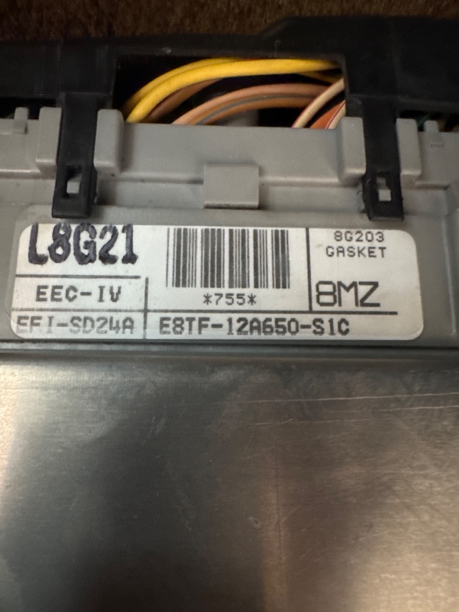

@ty.forestcom best thing to do is just pull your ECM out (it’s easy) and get the numbers off it....or post a pic
Sweet, here’s what I see. Mine doesn’t match any on rockauto

If your emission sticker says federal and you have a manual (now) just get any 88 ECM
Actually according to google your current ECM is federal

Big news everybody. Ecu is good, may still replace with a manual one in the future, does it really make a difference?
I powered an injector wire with a fuse strait to battery. Cranks right up and stays running. I somehow need to find where they lead to I can make a permanent fused power from battery. Only weird thing, usually she starts by just touching the key. Now it starts like a regular truck, could this just be its cold and has been cranked a bunch the last few days?

One injector wire can power all 6 if ran to battery. I traced them back to the main red at a connector, connect is toast. I am going to cut and splice from a good section and run all 6 to battery with fuse. I will try to run them to starter relay first, could be a cleaner result. She’s a show car but only when she feels like it. Was thinking I’d miss a show tonight but may make it after all.
