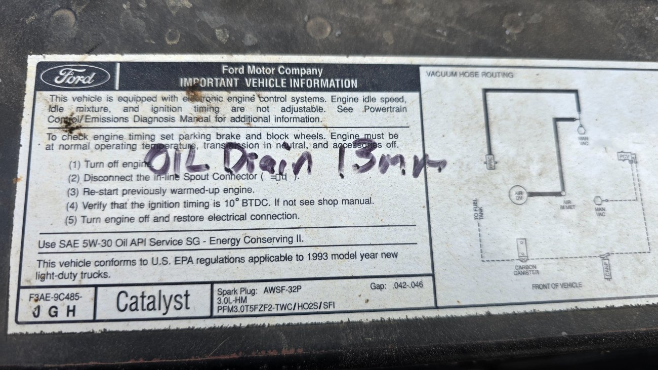

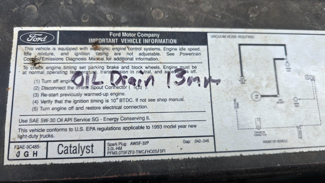

Really? I didn't know that. So my Ranger is currently California compliant? Here's the sticker. It doesn't say anything about California. It just mentions US EPA reg'sShould be on the sticker near the hood latch. If that's not there (or readable),
Does your 88 have a Mass Air Flow sensor?
If yes then California Emissions.
If no the Federal Emissions.
The cali ones will say CARB compliant i think.Really? I didn't know that. So my Ranger is currently California compliant? Here's the sticker. It doesn't say anything about California. It just mentions US EPA reg's
