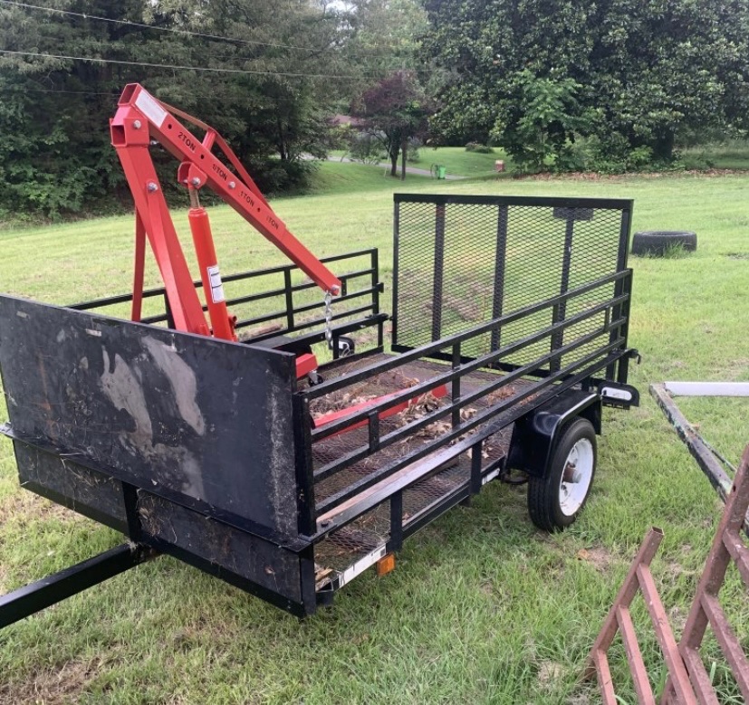

“Finished” up the tag along. I might upgrade from the factory 8.00-12 wheel/tire combo to a set of 14” deer hoof wheels and 205/70s, since I have them.
With a 2.3/5spd and 3.45s I know Barney is not a tow pig, but… 5x8 mower trailer, cut down Co-op stock racks, old display table top that DG threw away… I might colorize it, might leave it flat black. Only rated for 2000#, but…

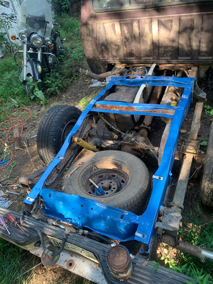

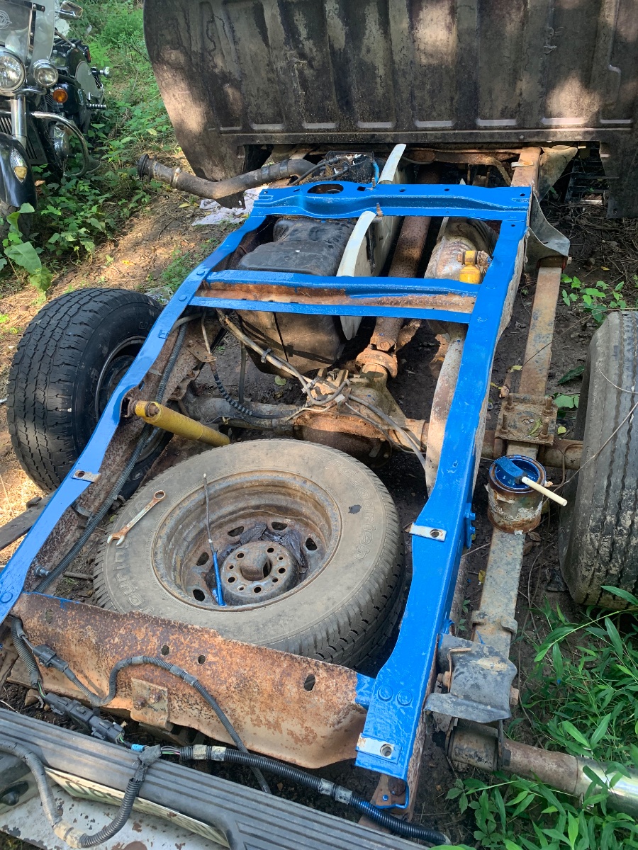

Should be basically cloisonne by the time the frame is done. Letting the sun flow/bake the paint in stages. Until it turns smooth…
Waste of time? Waste of old paint?
Naw…

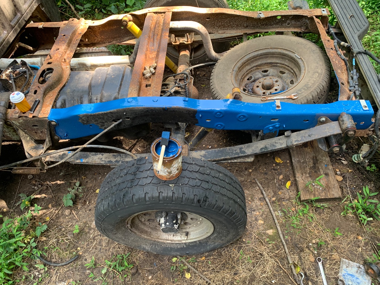

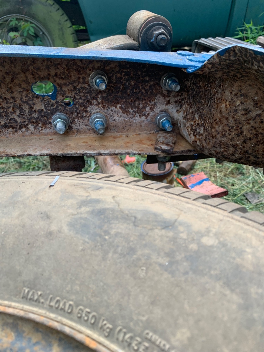

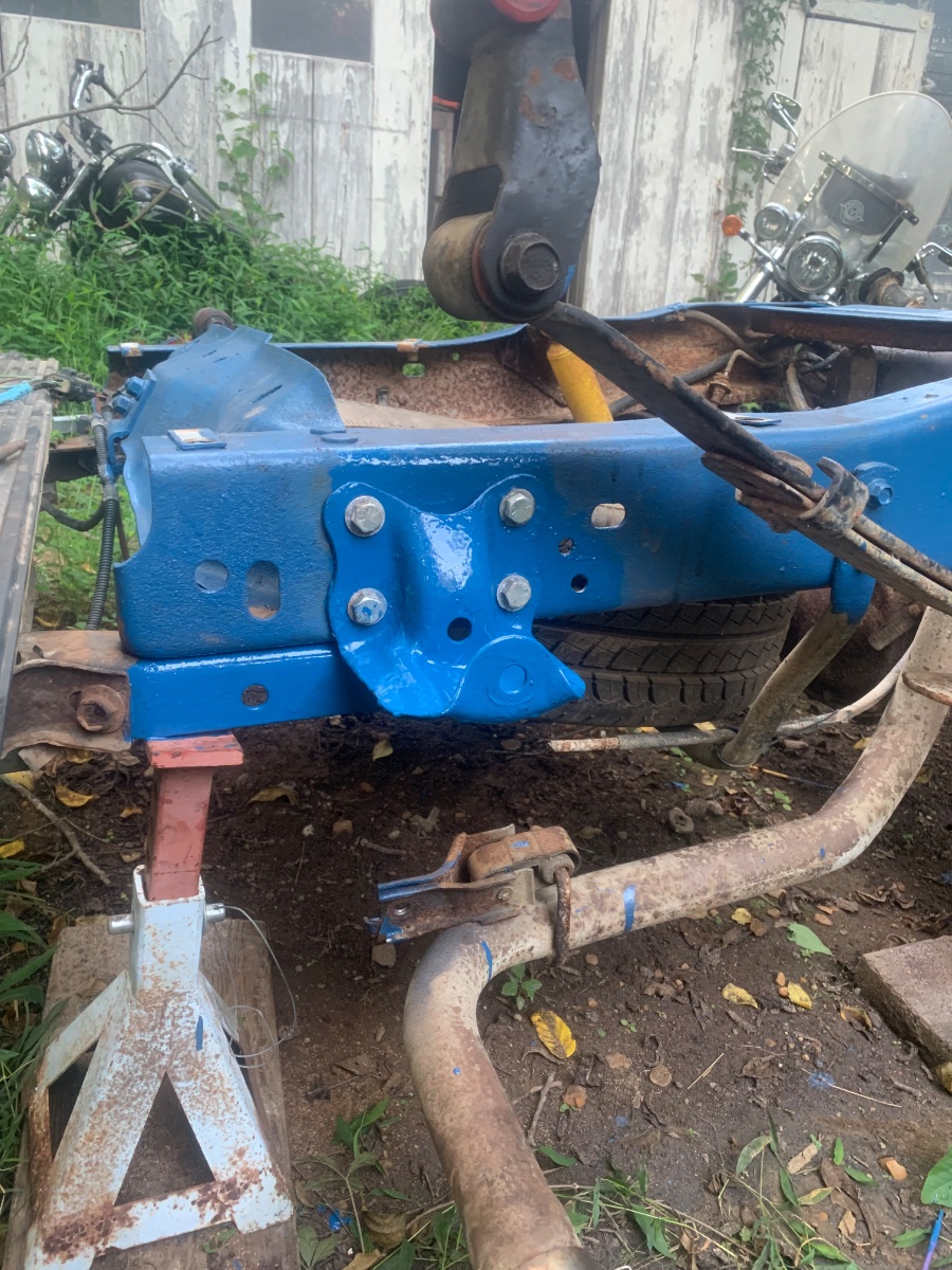

Going to try and flip the passenger shackle this weekend. Once the back half of the frame is smooth blue, on to the bright red rear springs and cream rear axle.
Heard back from DST Suspension. Prothane had a bad run of bushings a few years back. Explains the heat induced failures. No big deal, bushings are A: consumables and B: inexpensive. I just wanted bright red or yellow because I can see them more easily. Yellow is no longer available so, red it will be.
Why the odd almost Grabber, almost Safety blue? Heather wanted to change the truck from dark cranberry to “Smurf” blue, with a gray interior. Found 4 quarts of Gloss Royal Blue on clearance for $2.50/ea at Lowes or Home Despot. Four quarts of New Holland blue at the then low price of $16/ea was beyond her budget. 😉
Today? The Rustoleum is no longer discontinued and is $16/qt. New Holland blue is $30/qt. I can see cracked metal, loose fasteners and worn bushings better against brighter colors. A case of 36 chip brushes is $10 at “Hazard Fraught”. I can let Mother Nature handle the flow out/cure by working on hot/humid summer days that are not conducive to catalyzed polyurethane coating application.
Blue. Red. Off white. Not for any flag. I’m cash poor and have left over paint that needs to get used up. I make really decent money for TN, but household expenses have tripled, or more, with the current economic issues. Improvise, adapt, overcome. Reduce, reuse, repurpose. Good enough for what it’s for. Barney will be a parts runner, grocery getter, daily driver grade mild custom. “She who thinks she must be obeyed” said “reliable, comfortable, fancy on the cheap”. 🤔😖🤨

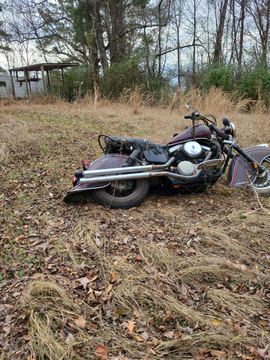

I “might should” leave Barney Dark Cranberry to match his “pet motorcycle”.., Naw, will do the bike to match the truck. 1999 Kawasaki 1500 Drifter, someone tried to steal it. I hate being this close to a city… 👿

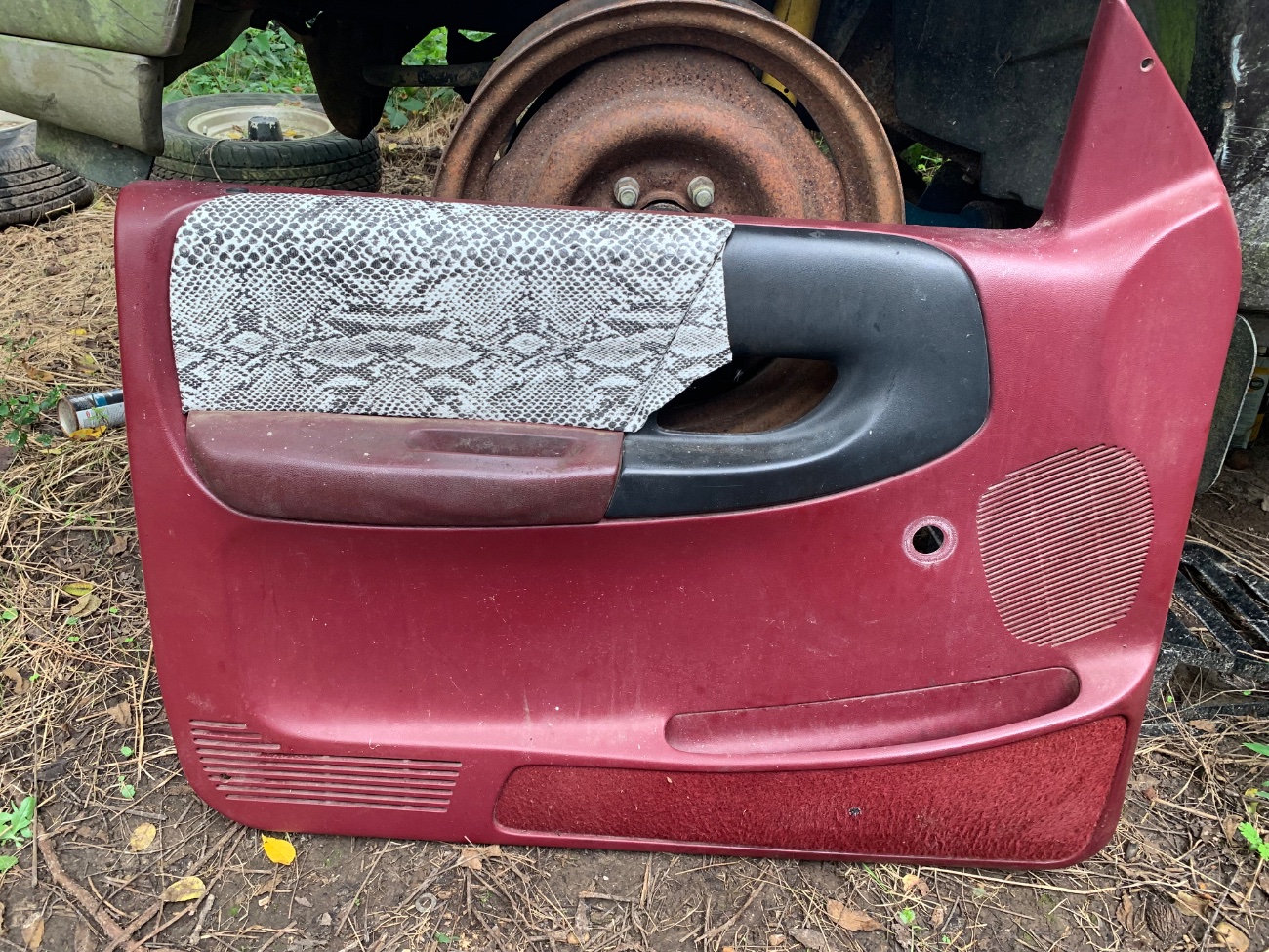

In keeping with the whole “small purple annoying dinosaur” pseudotheme…
Python print vinyl. Hidjis… Perfectly hidjis… Uncle Fester would be so proud.
Just loosely stuffed under the panel. Will actually remove, properly affix/stretch, epoxy panel back in place.
Barney and L’il Bit
The actual covering fell apart/off in 2014 or so. The gray underlayment is self “riveted” to the reddish main panel. Part of the molding process seems to be hollow tubes that are heated and squished in the final press, locking the subassemblies together mechanically. Simple enough to drill the edges off like removing a pop rivet.
I will need to epoxy the scew mount, bottom left corner, and 1 hooked mounting tab back on. If you have never pulled a 93-97 door panel: 1. Remove the armrest and lower left screws. 2. Remove the window crank handle, has a deeply inset Torx behind the snap cover. 3. Lift straight up, wiggle edge until the hook tabs release from the padded pockets. After 29+ years, the tabs are fragile…

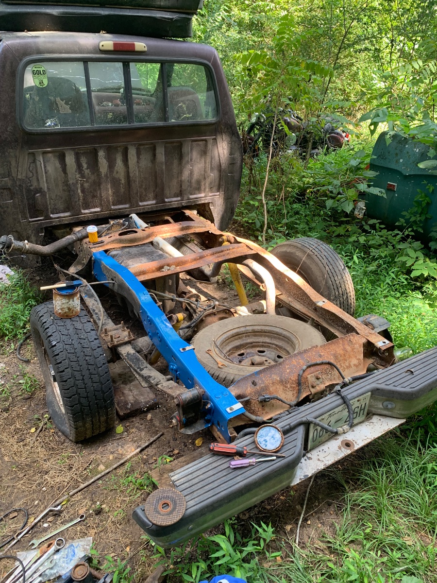

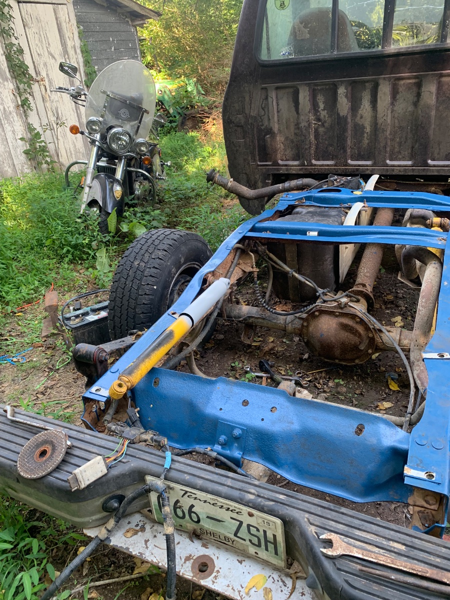

Finally got the other shackle flipped this evening. Will final bolt tomorrow, assembled with wet oil based enamel on frame and rear hanger. Do the other rear hanger in blue, recoat the bushings, spring eyes and centers with Energy Suspension synthetic grease. Coat the actual bolts too, can’t hurt. Paint/reinstall the exhaust hanger as it has to come off to reach the top right rivet. Yes, hanger is also riveted on… 😖
Don’t support your truck on a vintage jackstand under the bumper mount… It wiggles like a happy puppy.
While you have the shackle out, reverse the bolt/nut that required full shackle removal… Factory design flaw.

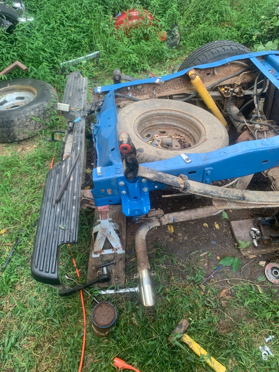

On its “own” wheels again. By that, I mean the 14x6 Outlaw 2 clones off the 92 parts roach. Even filthy, so much nicer than deer tracks.

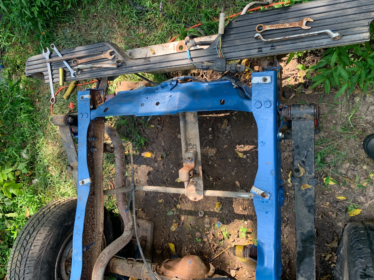

Getting ready to do the inside of the rear frame. What a mess…

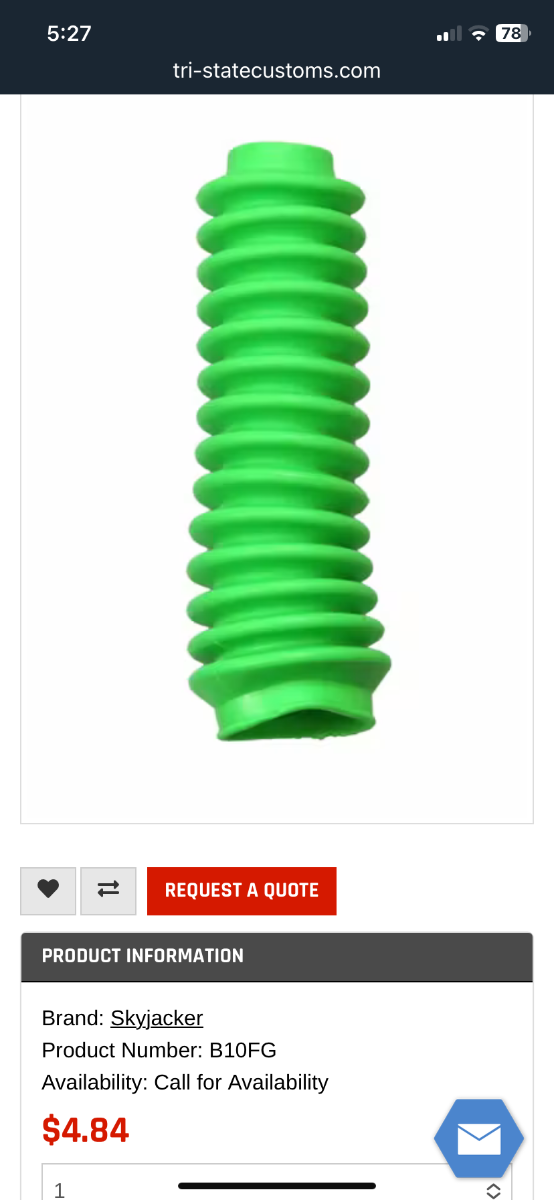

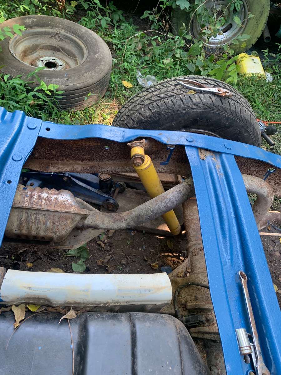

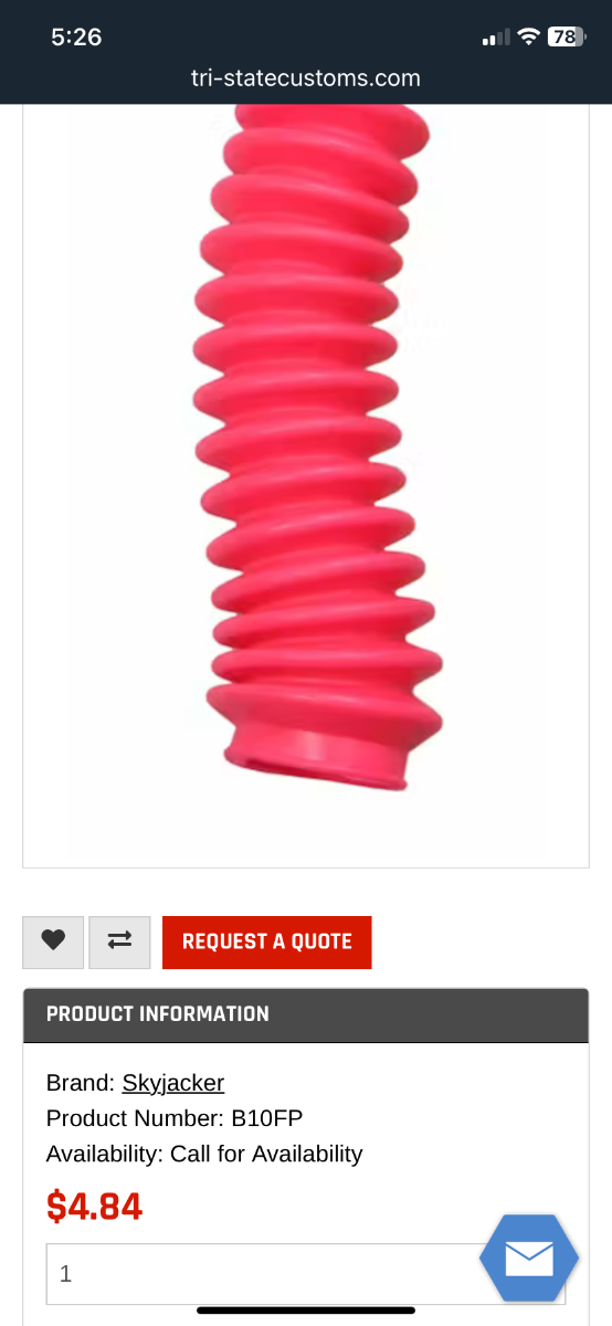

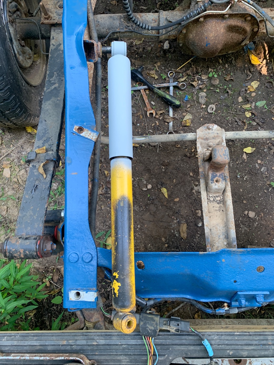

Not too keen on bright yellow shocks. So, even though these will ge getting some form of hidjis (hopefully Lime Green, but Hot Pink would work) shock boots… Stripped and primed the upper. Will then do the lower. Paint in stages as well. Install passenger side first. Then clean up, paint, boot and install the was passenger side onto the driver side. Shock mount plus rear crossmember makes the perfect drying stand. Passenger side is so cluttered that this way kinda sorta makes sense.
I will be rebushing the shocks with proper polyurethane bushings. RED. Will get to the front shocks eventually. I “should” replace the rears with Gabriel load assist coilovers, but, can’t put boots on them. This is my parts runner, winter beater (only 1 I have tire chains for), cheapish daily driver that gets somewhat tolerable fuel economy w/o being a “shudder” car… 🤔
