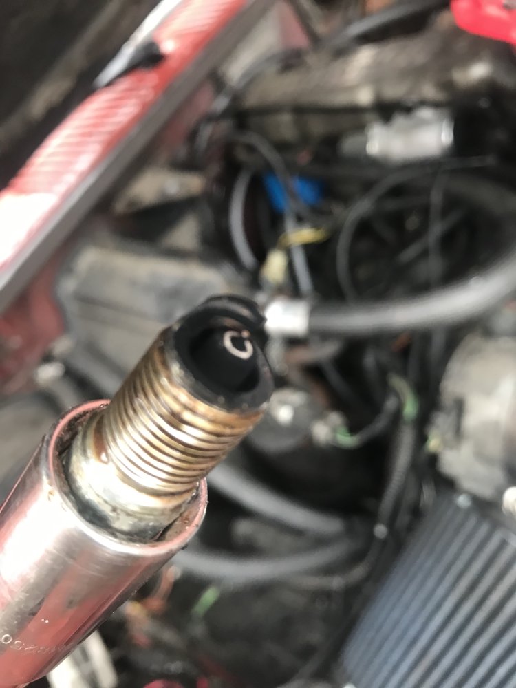

I have a 1987 Bronco II. I am not a mechanic. I replaced the TFI Module.
I Screwed something up.
I was getting some slight hesitation when I pressed the gas, the idle was a little rough, and a little rough on start up and going from drive to park. I figured the ignition system.
I checked the tfi module and the case was broken and the metal plate on the back was no longer attached so I figured that was the culprit.
I replaced it and it ran ok for about a mile, then it started sputtering and trying to die, lack of power. Now it starts up and dies with black smoke.
Ive swapped between a couple tfi modules to test if I had a bad module, no good.
I think ive either screwed up the distrubutor somehow, or the timeing was super off to make up for the fact that the old tfi module was broken, or I messed up the timing while I was back there fiddling with it.
My neighbor put a timeing light on it, and the bank on the drivers side is fine, but the bank on the passenger side has tons of missfires and bad spark.
Have I screwed up the distributor, did I accidentally yank the sprk plug wires or another wire that I havn't thought of. Is the timing just super off?
I will say it looks like the TFI Module sits closer to the valve cover gasket then it should. It's almot touching.
Any advice would be appreciated,
Thank You for your time

I checked the plugs and they were fouled black.
I checked the cap and button and they both had a fair amount of corrosion.
Which again is weird because they are only 2 years old. I replaced all of them, and I took it for a test drive last night and it ran great except it had one miss, which I figured was a fluke. It ran fine after the miss. Better then it’s ever run.
I got in it this morning and nothing but misses.
could I have a bad pick up in the distributor?
thank you for your time
Randall
If old spark plugs were "fouled black" then that's usually not a spark issue
1986-1992 2.9l engines used a Fuel Return system
On the engine is the Fuel Pressure Regulator(FPR), looks like a small can
The return fuel line is attached to it, AND a vacuum hose
If FPR leaks the vacuum hose will suck in extra fuel and cause RICH running
i.e. black spark plug tips and misfires from Rich Mix
Check that vacuum hose for gasoline
As said old O2 sensor will also cause rich mix, change it if you don't know its age
PCV valve, this needs to be cleaned or replaced every 3 to 4 oil changes
2 or 3 if engine is older, or if its obviously getting oil clogged
All piston engines have "blow-by"
When a cylinder fires some of the very HOT high pressure gases will "blow-by" the piston's rings and into the crank case
The rings and cylinder walls are lubricated with oil
The HOT gases will Vaporize some of that oil, this is THE ONLY PLACE in the engine hot enough to vaporize oil
Blow-by is exhaust gases
PCV system was added to suck up the blow-by gases and re-burn them in the engine, much the same as EGR system does but for another reason
But PCV system can also suck in the oil vapor
Newer engine will have 5-8% blow-by
As the rings get worn 9-12% blow-by
When it gets up past 15% the oil vapor can clog PCV and start to foul spark plugs
Valve guide seals
The valve train needs oil but the intake valve stems can suck this oil in because of the high vacuum in the intake, so there are valve seals on the intake and exhaust valve stems, inside the springs
Exhaust valve seals are not a big issue as far as engine operation
The intake seals ARE a big issue, as liquid oil can run down the stem and be sucked into the cylinders, this can cause misfires and black spark plug tips
A perfectly working Spark system can not over come any of the above

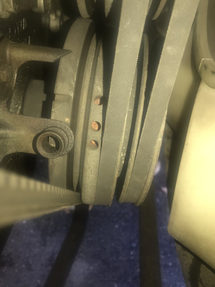

Have you timed the spark for the engine yet?
Check a couple of spark plug tips, see what they tell you about rich or lean running
Cold engine runs off air/fuel mix tables in computer memory
Once engine is warm the computer calculates air/fuel mix on the fly

I don’t have a timing light, and my neighbors broke. I checked that I had spark with one of those inline spark plug wire bulbs. Could changing the tfi module alter the timing or should it?
I checked the plugs, they are black again
That’s maybe 10 miles
thank you

@Randall008 ,
@RonD beat me to it, verify the timing correct. I believe you can rent any diagnostic tool from The AUTOZONE, WESTBAY-NAPA, Schuck's/Kragen/Checker's/O'Reilly's.

I’m going to try and check the time if today, but I am a novice at this. Any pointers would be appreciated.
I’ve looked at a lot of you tube videos and I think I have the general idea. According to my emissions panel I want the timing set 10 degrees before top dead center. There is an arrow over the harmonic balancer that I assume needs to line up with the 10 degree mark on the harmonic balancer while the truck is idling and the spout connected is disconnected.
what is the circular piece of metal over the harmonic balancer?
to correct timing I loosen a bolt on the distributor and move it slowly is that correct?
thank you

Update:
The timing was off. I rotated the distributor about a quarter of an inch, checked it again and the markers lining up.

I pulled a plug. It looks like it blackened up a little from when I hit it with the torch.
the exhaust is not smoking anymore, but the pipe is still black, and sometimes it’s got Water droplets in it.
should I just drive it and see what happens? Fiddle with the timing some more? Replace the plugs again?
thank you
