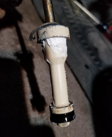

So today I began to disassemble the clutch master cylinder behind the clutch pedal inside the vehicle with the attempt of bleeding it like in a YouTube video previously shared.
Interestingly, when I pulled the push-rod and piston combo out of the master cylinder under the assumption fluid would start pouring out, nothing came out. From the looks of the push-rod piston.... well, there is no rubber piston. Now I'm not exactly sure what it is supposed to look like, but it appears the rubber has been completely corroded away. And this would explain initially why I saw black fluid coming out of the bleeder valve!
Here are some pictures of the push-rod and piston on the end. Now I am assuming there should be a rubber piston over the middle part, not just this white plastic.

It'll be a couple more days until I can dig through the trash for the one I just removed. But if I recall correctly, what you are looking at IS the Piston. The end with the black seal is what pushes the fluid.

I talked to a friend that works with brake systems for his job. He said typically on the piston there should also be a rubber seal on the top, which as seen in the photos would be missing in this case.
Tonight I got a new clutch master cylinder installed. Didn't feel like bleeding it, so I'll tackle that tomorrow and see if I get any promising results.
