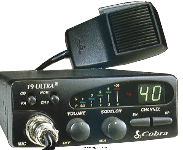

I'll admit, I'm a CB noob, and haven't really searched. Just though I'd post up and see if you guys could help me out.
I'm pretty sure I've got a Cobra 19 radio (I'd have to go check), and have a 102" whip mounted in my bed stake pocket.
I can hear everyone else fine, but they can't hear me. All the lights light up on my radio when I key up but I'm not sending any signal I guess.
Any thoughts?

This is the radio
http://www.rigpix.com/cbfreeband/cobra_19ultraii.jpg
