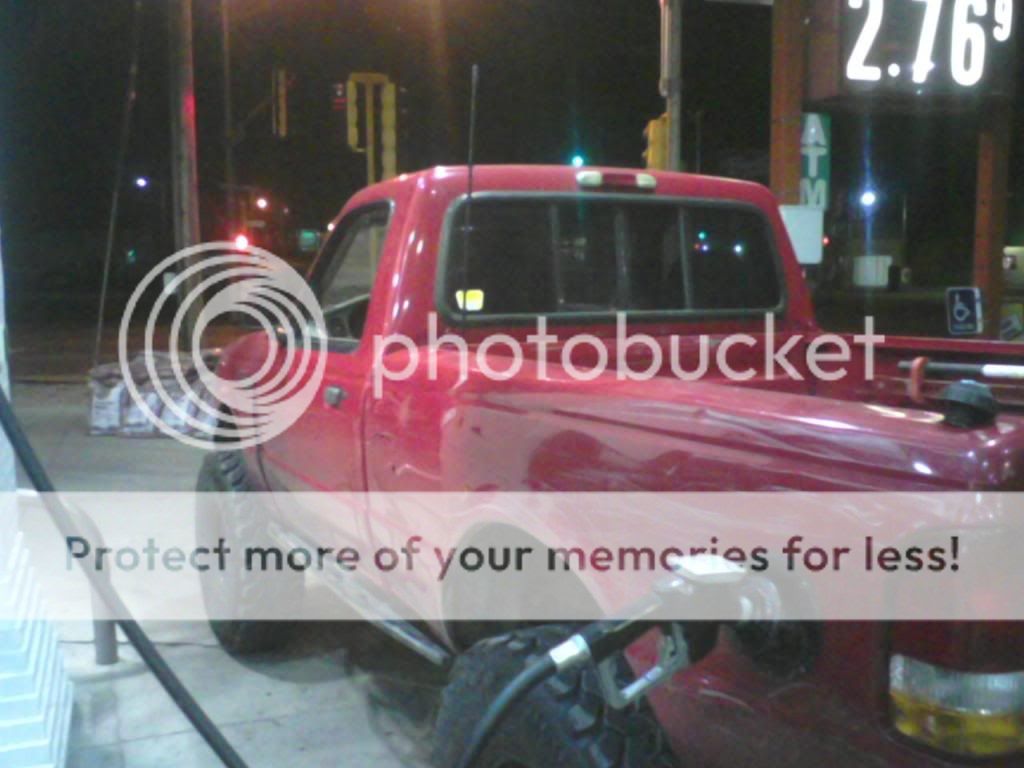

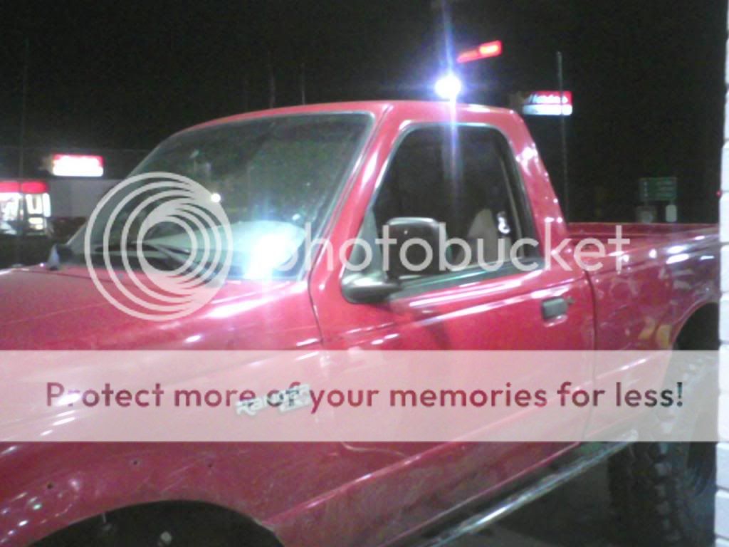

Here's what I ended up with. The antenna is in line 'horizontally' with the stake pocket, and mounted inside the bed with an angle iron style mount. I'd say it's ~6" above my roof line. Here's a couple awesome camera phone pics:
WTF... that is TERRIBLE SWR... 3:1 can hurt your radio, and 2:1 is also not that great... Wonder what would be causing that... That antenna is cut to tune ain't it?
The spring would add length, but you need to measure SWR on a high channel and a low channel to determine if you are too long or too short. Ideally, you want to be as close to 1:1 as possible.
WOw did I hit your antenna height right on the money or what? LOL sorry jus a lil self braggin, but it actually looks good, alot better than mine at the moment. Mine kinda angles out like a feeler antenna on a roach lol. in the same spot.
Agreed, that SWR is much too high. I bet it's because the antenna is too close to the cab. Move it back a couple feet (or to the rear stakehole, or up on the roof).

Well my original 'creative' mounting location has proven to be a failure, now I gotta find a way to make the thing work, even if the antenna will be higher than what I had originally intended. The radio is worthless if it doesn't work.
I stopped by a radio shop today and got a stainless spring. Tossed it on the antenna in the original mounting location. SWR still too high. Swapped my 9' coax for my 18' coax. Still too high.
The guy at the radio shop suggested I move it up so the angle mount bolts right to the side of my stake pocket, that would put the antenna mounting location in line with the stake pocket, and ~1-2" lower than the top of my bed rail.
I went ahead and did that, and attached the antenna with the spring. I'd say it's 1-1.5' over the top of my cab. Guaranteed it will get smoked by some branches. The spring should take care of it though, hopefully.
I've got a 1.9:1 tune at both 1 and 40 with the current setup. I tuned it in between storms as well, so the weather wasn't the greatest. Dunno if it'll drop lower when the weather clears up. I'll check again tomorrow if its clear out.
