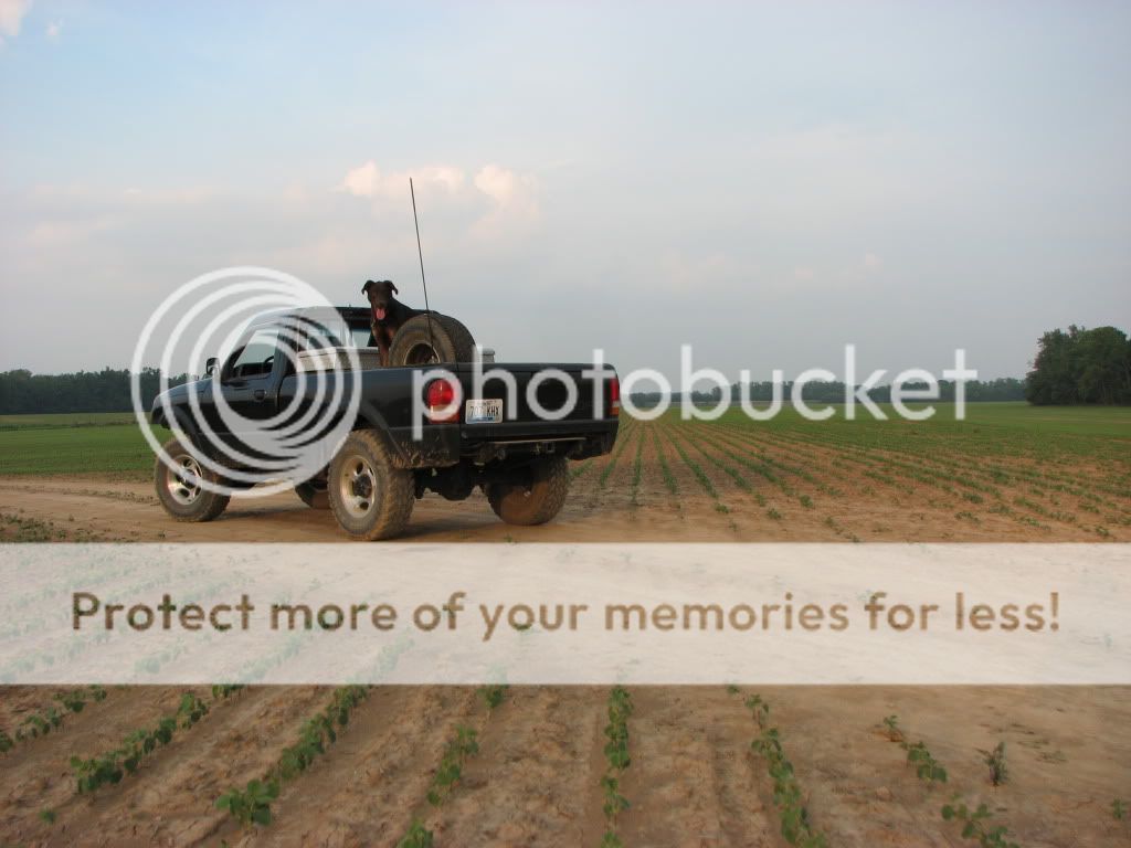

Anyways my setup is done for now. Coax came into my cab through the rear driver's side floorboard, runs under my carpet behind both seats, comes in front of my pass. seat, across the trans tunnel to the driver's side door, along the door line, behind my pedals, and to my radio.
Took all 18' of coax to run that route, no loops. Checked the standing wave for the last time, attached coax to radio, and called it done.
Worked awesome wheelin last weekend. Drug it though some brush and the spring did its job. Cap never came off. All around good stuff.
Trail communication is awesome. It makes trail rides go much smoother, and safer. General conversation/witty banter is always good fun as well.
