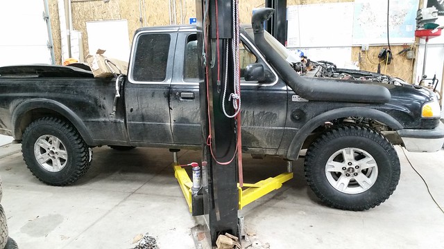

B3000 TDI swap
Lots of progress now!
Since you have to drop the front diff to get to the driver side motor mount bolt anyway, figured it was a good time to clean up the 4.10 junkyard front end and put it in.
The adapter kit is set up to use a 4.0L clutch, flywheel, and trans. So I snagged a 2010 4.0L 5 speed trans as my truck was a 3.0L. I pulled both transmissions down to install my shorter 3.0L 1st-3rd gear in the 4.0L trans with all new syncros, bearings, and swapped over my tailhousing with t case linkage mounts. I use this as a work truck out in the woods, so I wanted the lower first gear (3.7 vs 3.4). The only difference I found between the two transmission is the spacer that goes between 5th and reverse. Otherwise, everything was identical.
Adapter kit mounted up perfectly!
Had a slight interference issue between the front diff and the passat oil pan, so off to the parts stash for a jetta oil pickup and pan!
Quick baffle
Much more betterer!
Looks so little in there :D

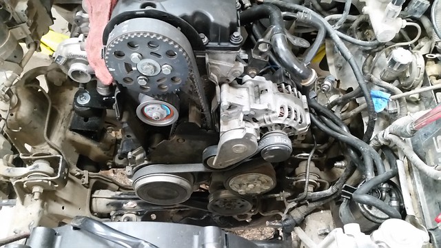

Figured out a 2004 jetta accessory bracket works just fine! Oem oil filter/cooler housing just barely fit also. Got the modded oem jetta coolant bypass line wrapped around the backside of the motor too. The passat line didn't want to play happy.

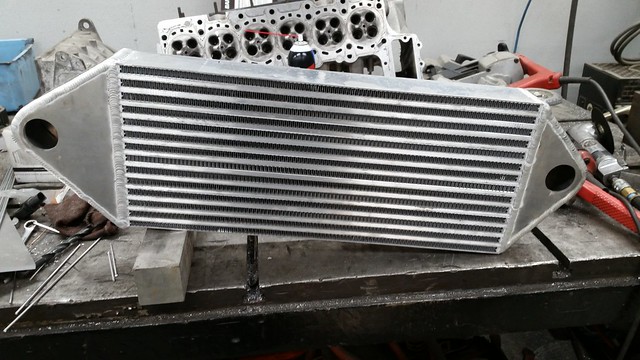

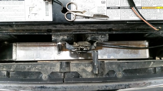

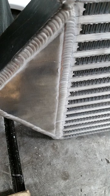

Got the intercooler all done too. Made the end tanks out of 1/4" plate to handle the intended 60psi of boost.
Welded decent for a $112 chinese core

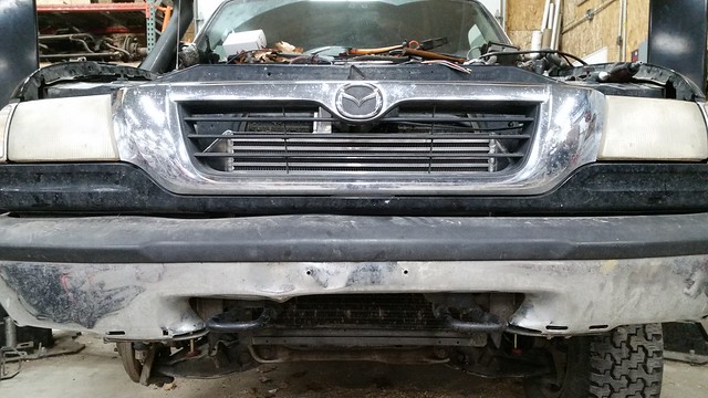

Is that a 3in core? I have to fab a bumber to fit a decent size cooler.

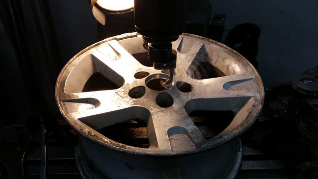

Got the centers of all 4 rims opened up to clear the front locking hubs.
Old
Much more appropriate!:D

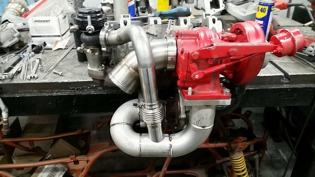

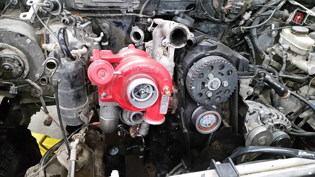

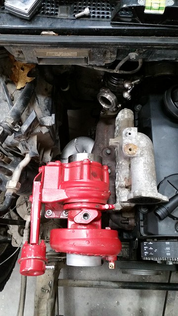

Got the hot pipe tacked up
nice so the drive turbo is controlled by the external WG?
