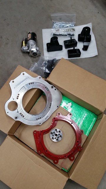

Yes! A huge update actually, my adapter kit FINALLY came in last week so the 3.slow is coming out at 7am tomorrow morning :yahoo:
Since these last pics I also added a overpacked ford clutched limited slip, and a gt500 finned rear cover because it was cheap on ebay.
TD Conversions adapter kit

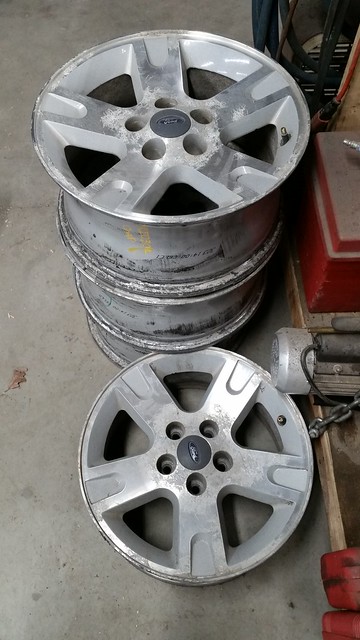

Also scored a set of cheap 16's from a newer fx4 ranger so I can run some e range 265/75-16's and not be worried about sidewalls blowing out with a bedload of wood.

Caint beat Randys adapters. His work is top notch.
