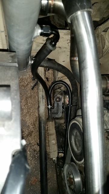

Power steering done and filled with fluid and air filter is all in and connected to the snorkel finally. Time to tame medusa's head of wires tomorrow!

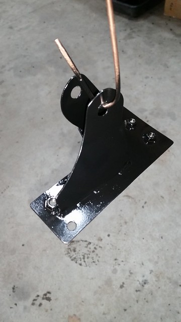

Here's the gas pedal bracket that was a major PITA

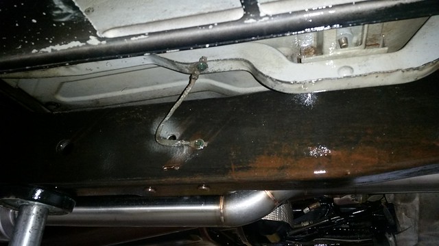

Since this guy is 100% rust free, I wanted to keep it that way so a whole gallon of fluid film went on the underside and basically everywhere salt spray would hit.

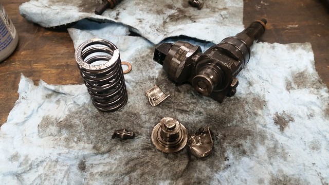

I took the truck on a 6 hour round trip on Monday and it started running funny on the way back. Didn't hear any funny noises so I figured an injector solenoid just took a crap. Upon inspection, I wish it was only the solenoid :icon_surprised:. In 10 years of professionally working on euro diesels, this is a new one on me.
I was planning on upgrading injectors eventually, but certainly not this quickly :annoyed:. I have a set of 20% over injectors on they way that will be here on Saturday if usps holds to tracking info. I tossed in a set of stock jetta injectors I had laying around so the truck is at least mobile, but it's no fun anymore with no fuel haha (passat engine I used was 135hp stock vs jetta that was 100hp).

Wow so im not familiar with the common rail stuff. am I looking at a destroyed tapped that rides on top of the injector? or is that the spring retainer? either way strange failure.
That is not common rail, its an unit injection injector, a !higher pressure design kind of the last evolution of diesel before common became common.
They don't normally look like that; sacrifice to the gods of speed and power
