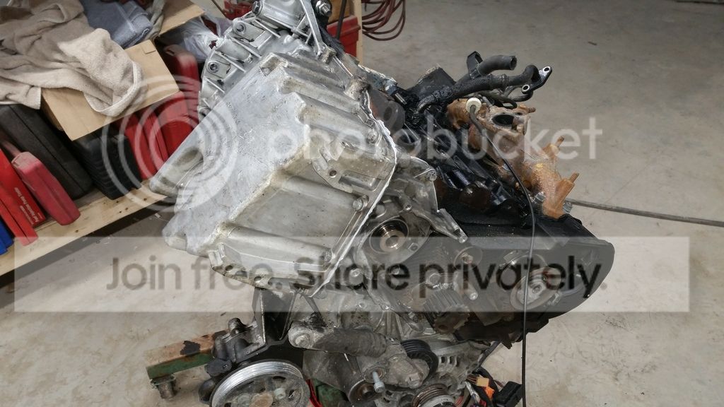

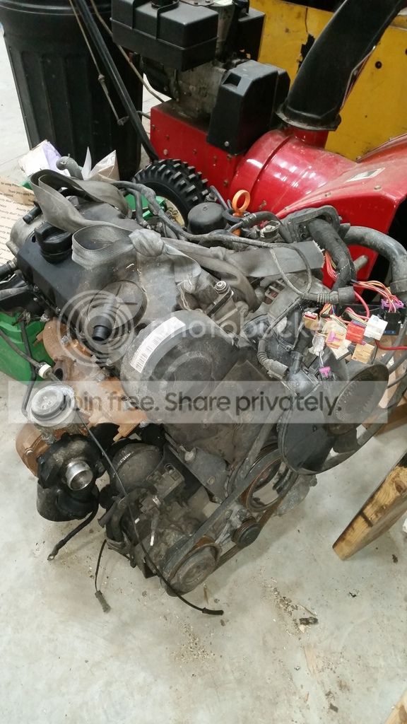

About 4 weeks ago I yanked a fully dressed 2004 Passat TDI engine/harness/ecu from a u-pull yard in the ghetto of detroit for $412.50. Sold the trans computer and intercooler off for $425, so the motor didn't cost me a dime. It needs a cam as 04-06 TDI's do, but I'm a dealer for Colt Cams so that's an easy fix. I'll also delete the balance shaft and put a fresh timing belt on it. I'm hoping all the vw accessories will clear and save any custom belt/pulley work. It's going to get a small set of K03/hx30w compounds which should be good for 180whp/350wtq with the stock injectors. When I upgrade them down the road, 220whp/425wtq should be doable from the same turbos.

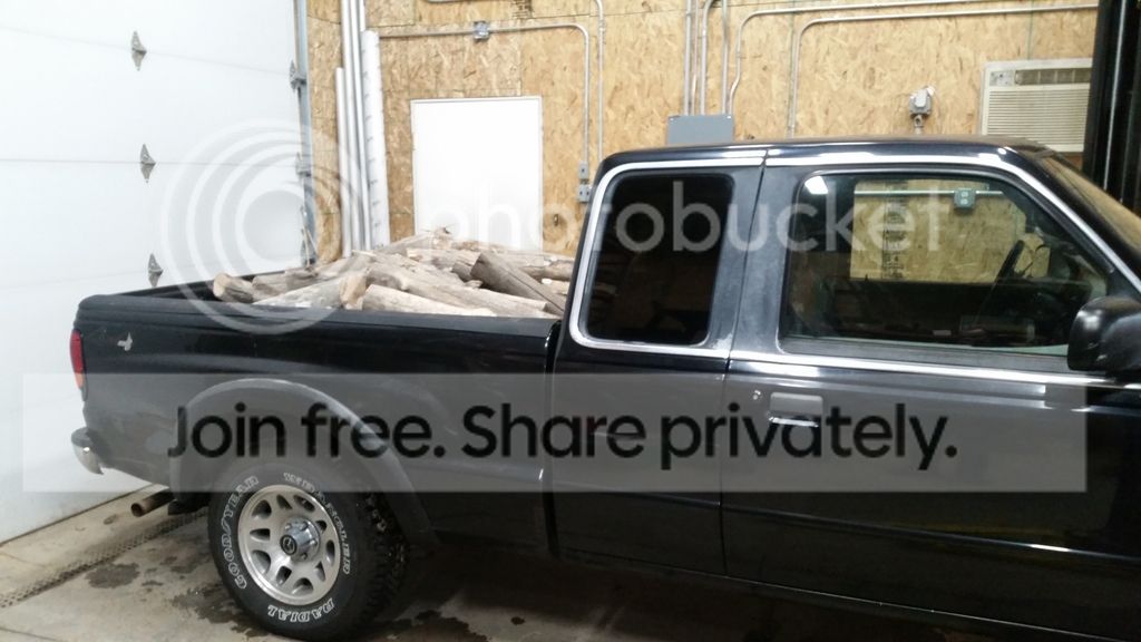

Put the truck to work today and went out and cleaned up a few dead limbs that came down in the wind storm last week. It's already sagging 1.5" with just this load so I ordered the airlift helper bag kit, firestone pump, and assorted fittings to hook it all up. I have a 20ft aluminum car hauler I plan on towing with VW's on it and I know that will squat it more than this.

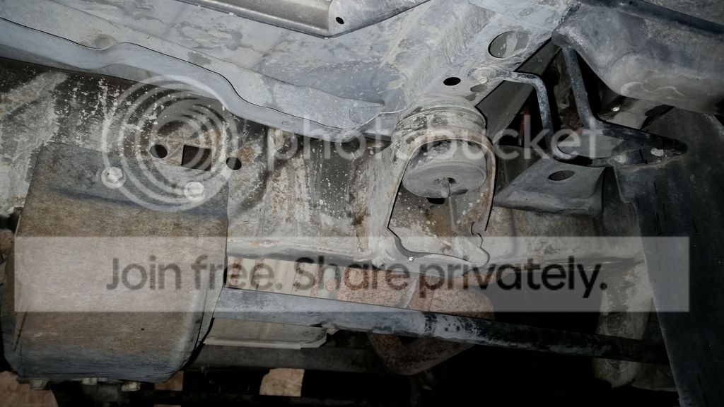

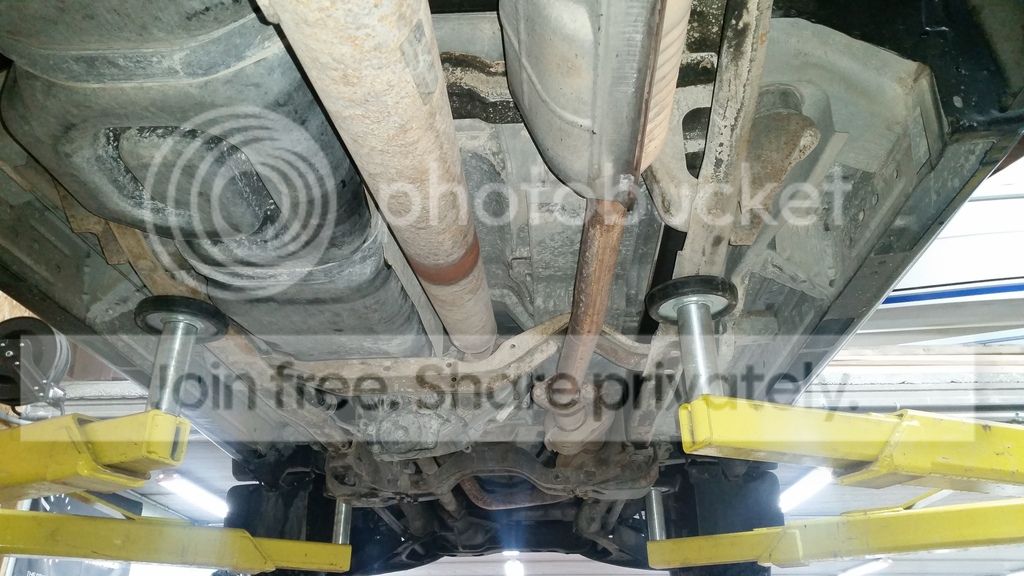

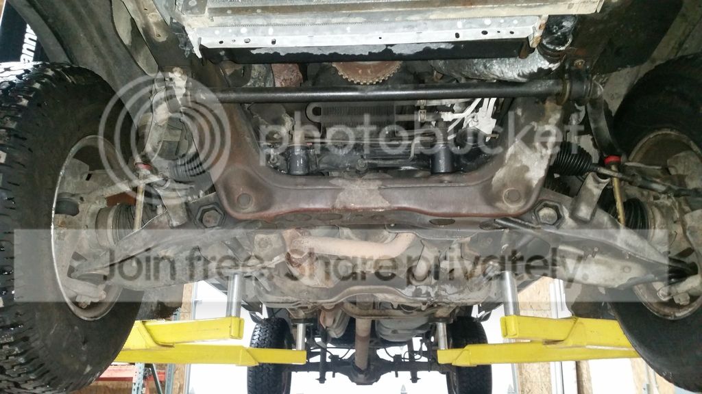

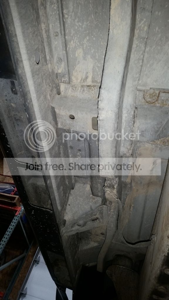

After unloading the bed, I put it on the hoist to get a look at the underside. My god :icon_surprised:. I'm so jealous of all you guys down south/out west. I can't believe this is a 17 year old truck with 216K on it. Looks like a 2 year/20k old truck from up here. This will get the most overkill undercoating job ever done when I get done with the swap and will be washed inside every time it has to see salt.

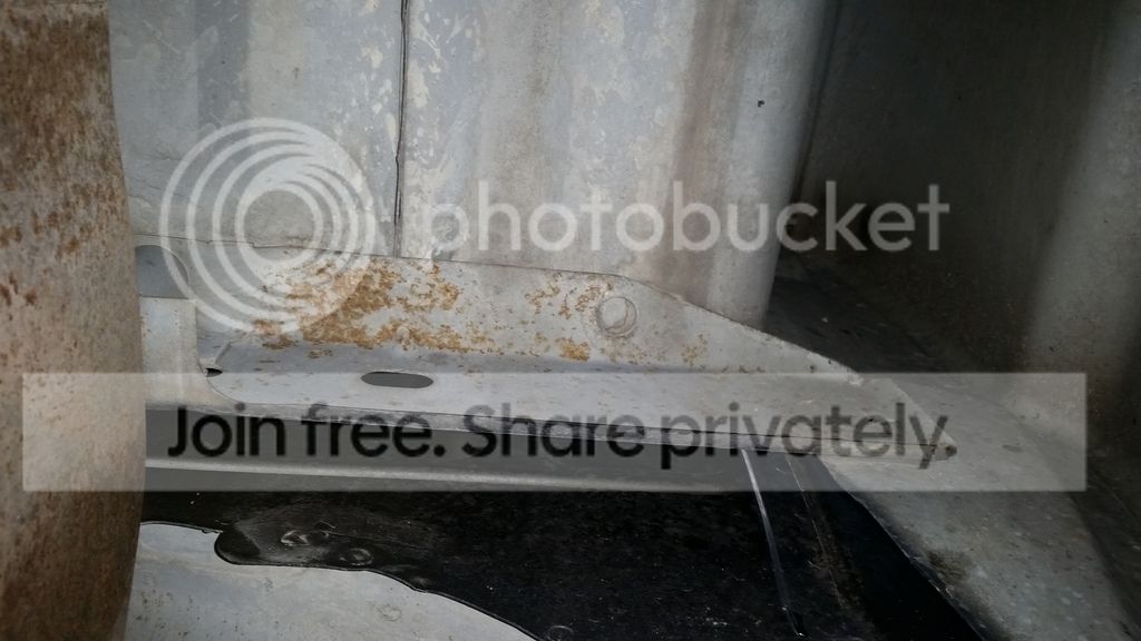

Worst rust I can find on this thing :icon_rofl:

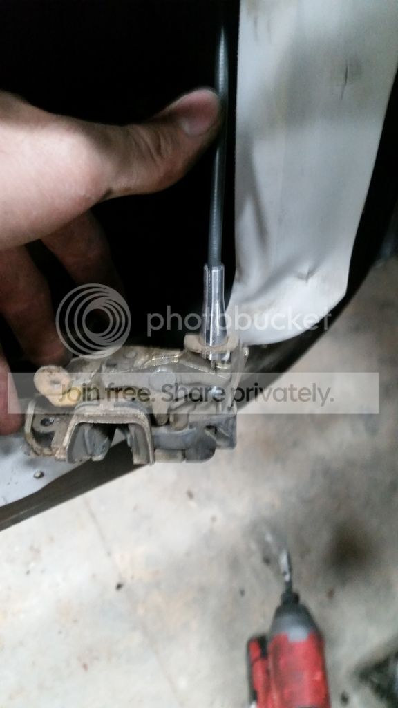

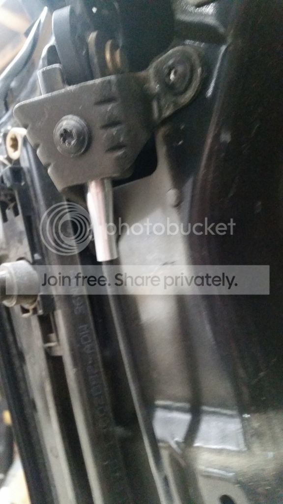

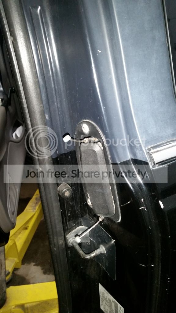

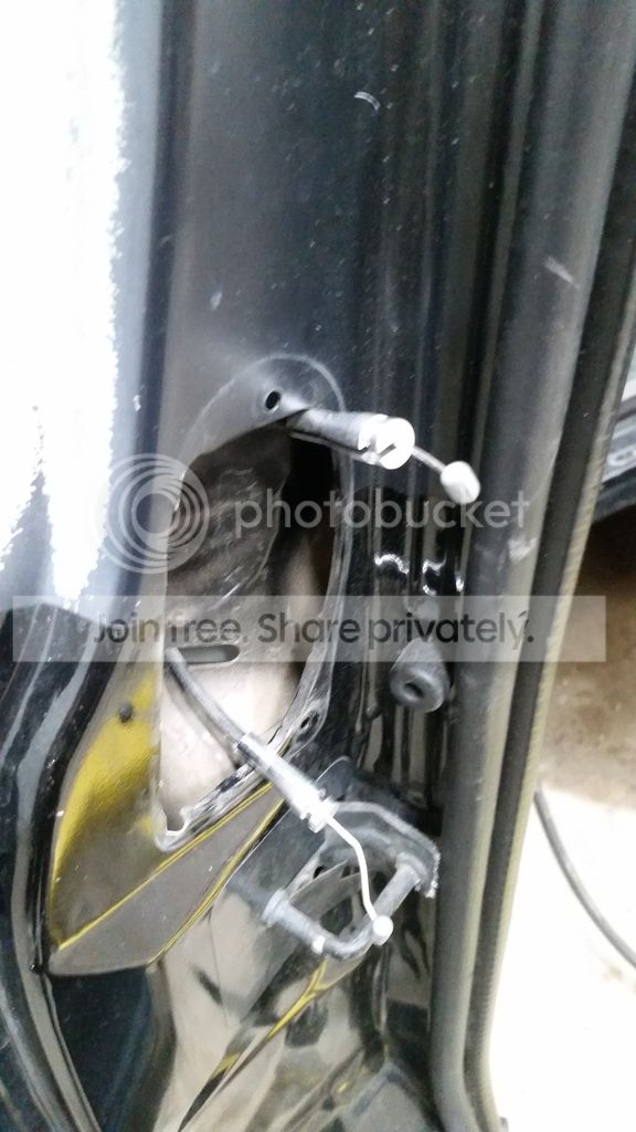

From my googling, this is a very common issue and I hopped on ebay and ordered the aluminum repair ends and a new pair of Depo door handles as they were only $12/each. Any specific tips for doing the job(other than don't break the door card)?

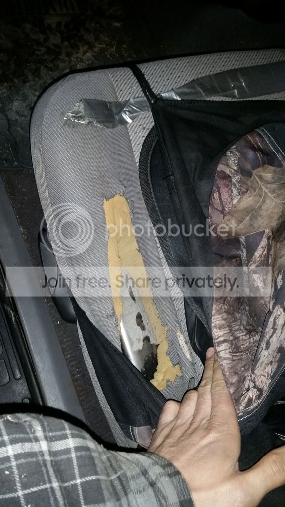

What's the best course of action here? Can a new seat bottom be bought anywhere for a reasonable price? I have to imagine any seat from a junkyard isn't going to be much better.

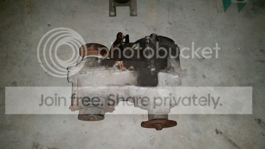

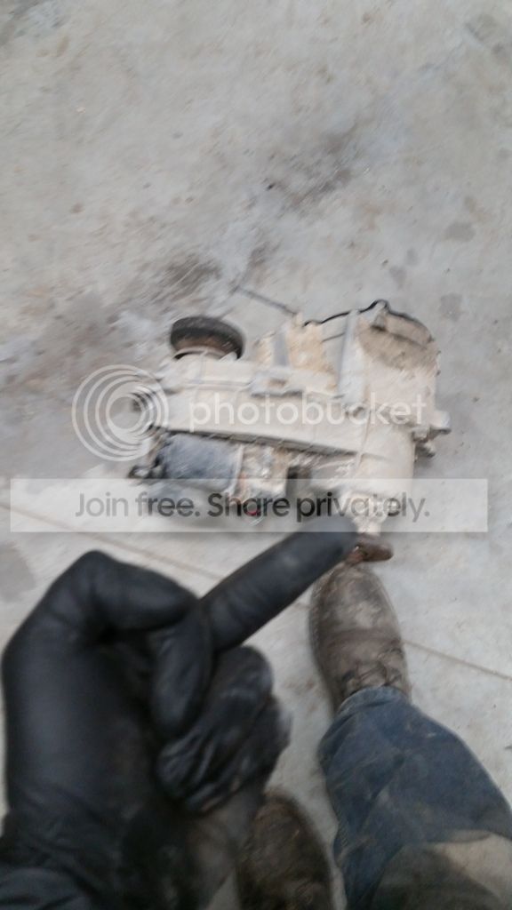

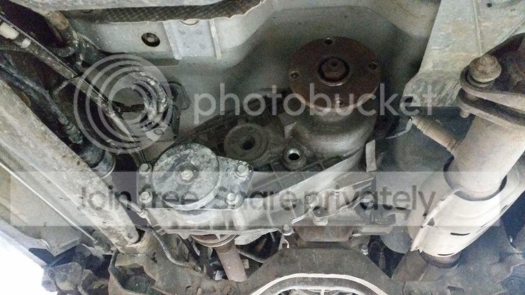

I tried 4wd today and the electric motor takes 3-10 minutes to shift in/out. My tailhousing does have the 2 holes for the mechanical linkage, so which exact vehicle do I need to yank a manual 1354 from? Same vehicle for the shit boot/trim? I found the Rugged Ridge manual hubs as well, they are also on order.

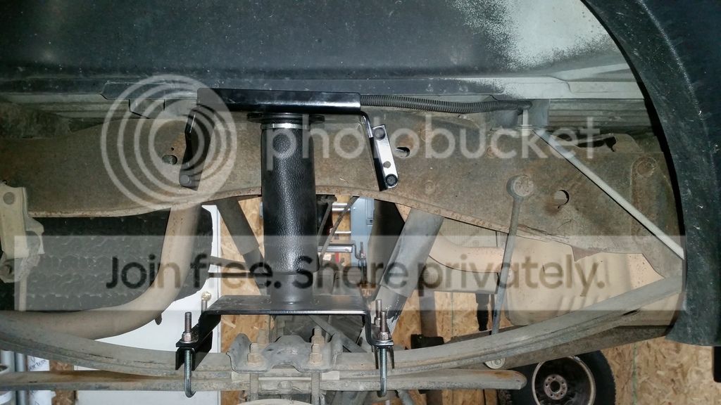

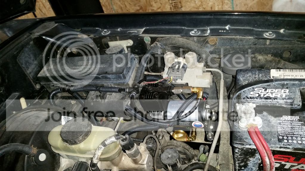

Airbag kit came in today. Had the hoist open, so I pulled it in and tossed 'em on. Compressor should be here in the next day or two so I'll finish plumbing the lines up then.

I started calling around to junkyards today and scored a 02 fx4 manual shift T case for $150 shipped to my door with the interior boot and shift lever. The linkage and floor plate were already gone so I need to track those down now.

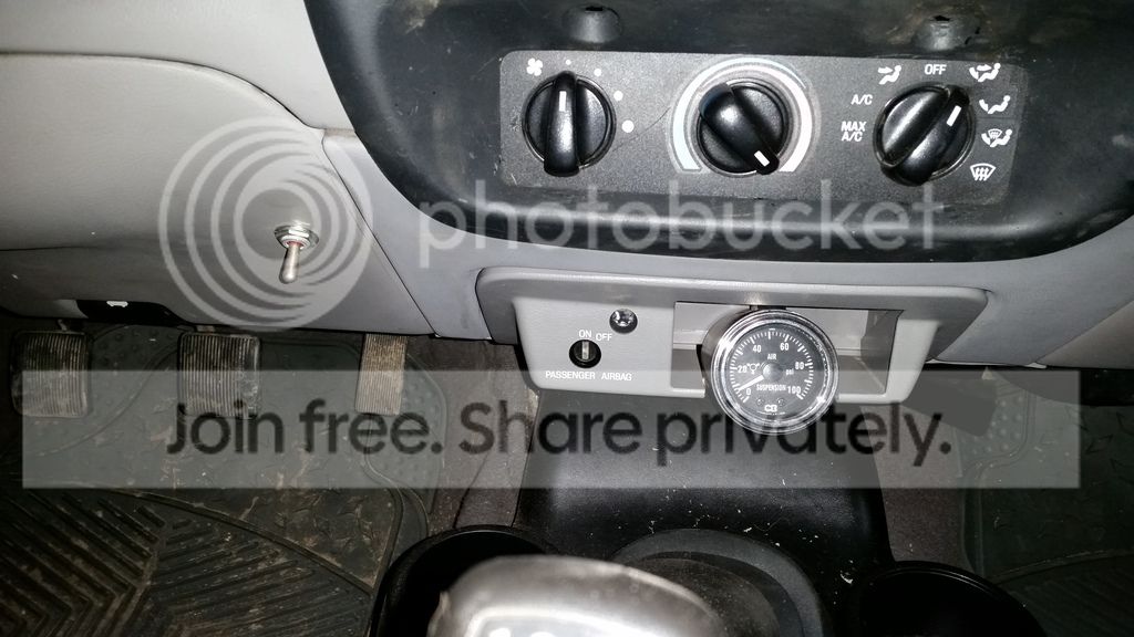

Got the compressor, gauge, and switch wired up. Sooooo much better with a full bed of wood now.

might want to consider the load capabilities of that rear axle(wheel bearings) before loading up those air bags too much...... with them on there you might be tempted to put some racks in the stake pockets:beer:

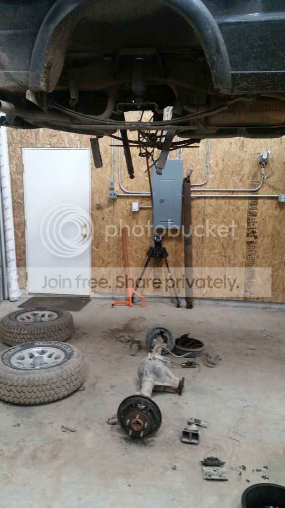

This 7.5" is wasted anyway, the ring/pinion have a scary amount of backlash. It's going to get a 8.8 swap from an Explorer or fx4 ranger in the very near future. Im not worried about hurting the rear wheel bearings on a 3/4mile trip back from the woods doing ~25mph. I'm not going to put 1500llbs in the bed and drive a few states over haha.
My rear door cables were failed in the normal ford fashion, so I ordered the aluminum ends off ebay and did them all on both doors.

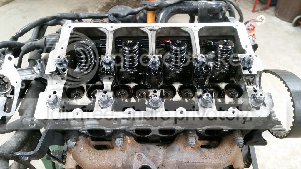

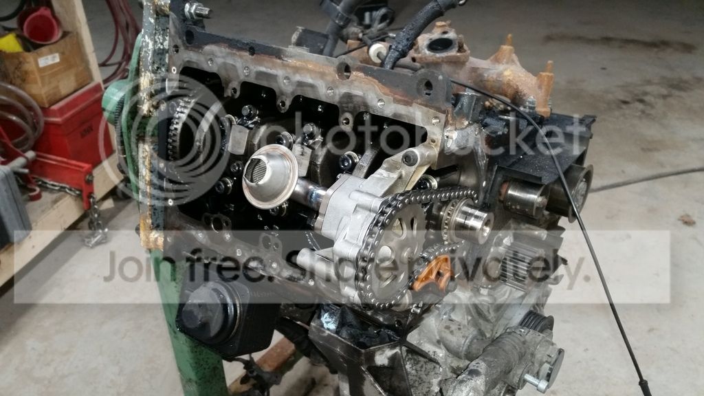

After cleaning the shop up from a 6.4 powerstroke job, I freed up an engine stand and started on the TDI. Pulled the trashed cam to install some head studs and stiffer valve springs. I'm planning on 45-50psi of boost so I'm setting the engine up accordingly.

Got a nice surprise from ups today! The elusive 2003 manual shift 1354! To my door for $150 from a wrecking yard in Wisconsin. Now I just need to find the shift linkage and floor plate.

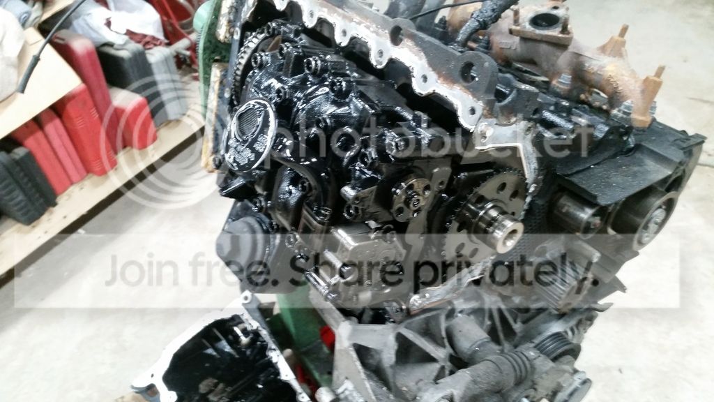

This evening I rolled the engine over to work on the bottom end. Balance shaft setup was deleted and stronger main bolts installed.
Before
B3000 TDI swap
After
B3000 TDI swap
All sealed back up.

Oh yea, the balance shaft unit is a solid 30 lbs of total crap that belongs in the scrap can. The chain drive fails due to a undersized chain and the oil pump is driven by a hex key shaft that likes to round over. The 04-05 passat tdi's are the only ones with the balance shaft setup, all the rest have just the chain driven oil pump which lasts well past 500kmi.
I just went on car part and found the cheapest T case for a 02-03 fx4 LOL. No magic involved. Case was $100 and $50 to ship. They even threw in the chrome fx4 shift lever/knob! They included the floor plate, but the boots were all cut to get the shifters out :temper:.

Yup, I found two of the ranger 8.8 fx4 4.10 posi rear ends near-ish me, waiting to hear back on who had the better deal. I know as sloppy as my 7.5 is, it's going to be a time bomb with 400lbft being fed to it LOL. I'll be fine with drums for now, can always put disks on later.

If it's the same axle tube ends, all you'd do is swap the backing plates for caliper brackets and dust tins. I'm not worried at all about making it work. I pulled my truck down tonight and mine already has 10" rear drums and stops plenty good for now so I'd rather not deal with moving spring perches and shock mounts. Not that I do don't have the equipment, I just have other things to spend time on at the current moment.

I happily said FU to this pile of crap after it gave me hell getting stuck in 4lo, then refusing to shift back to 2wd for 3 hours :annoyed:.
