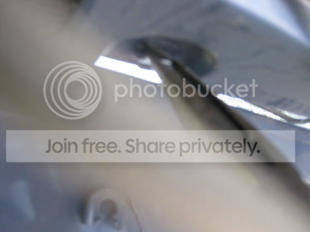

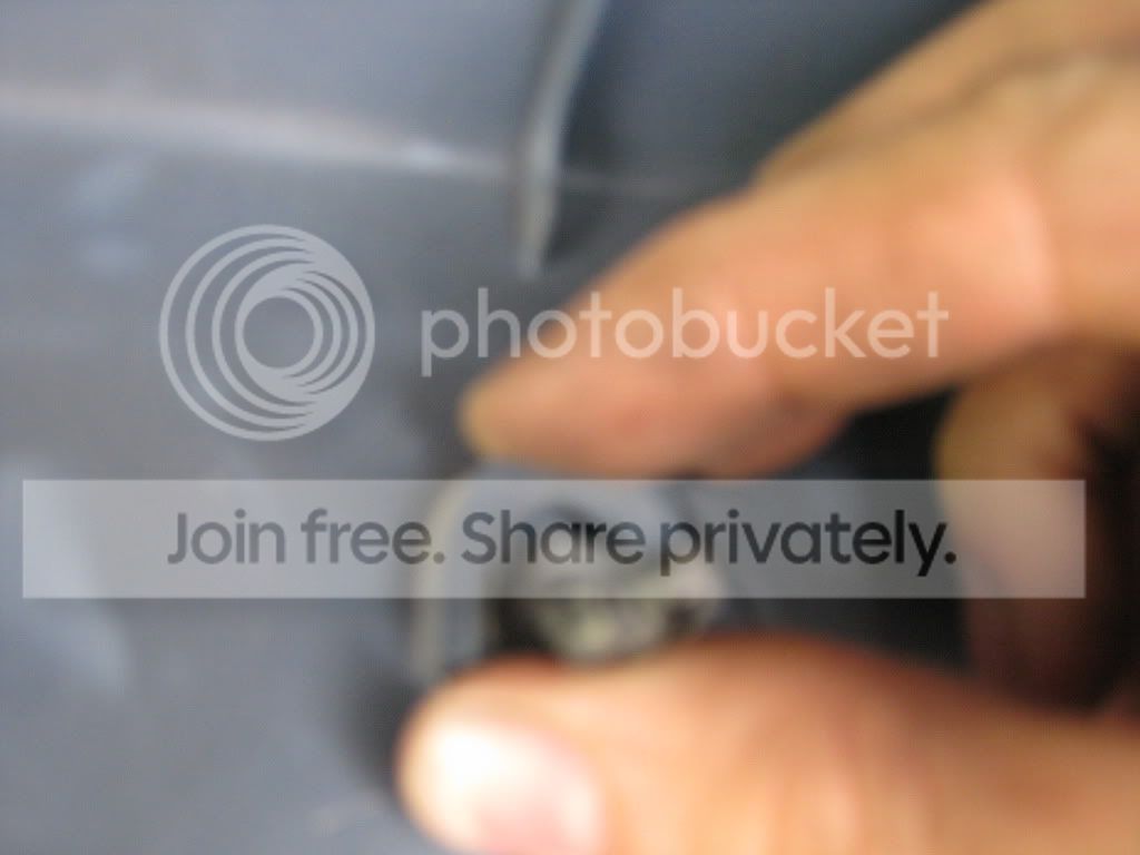

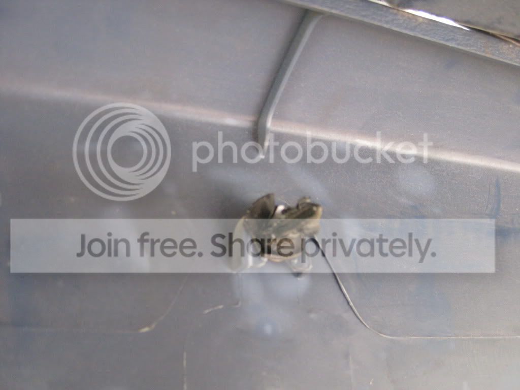

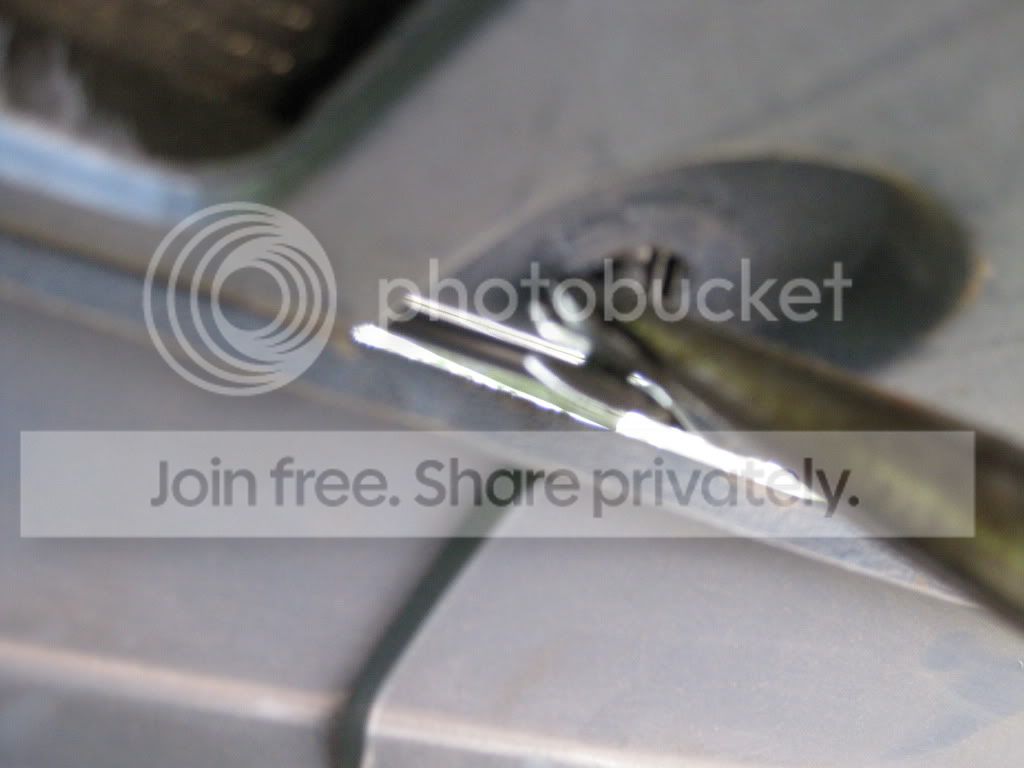

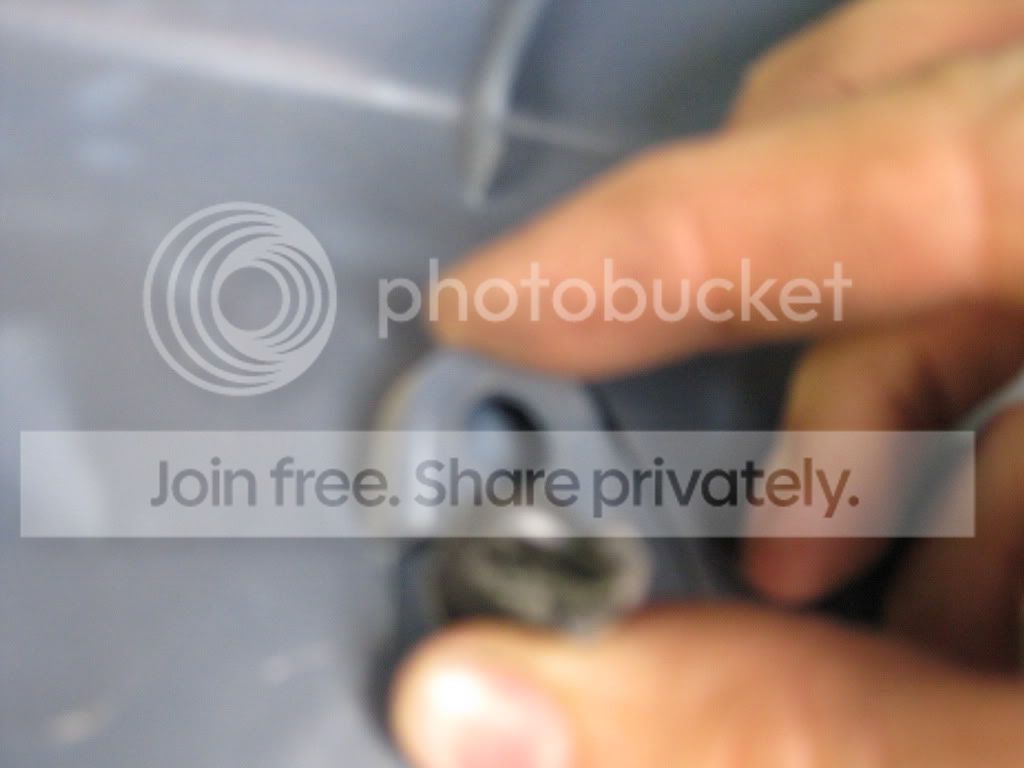

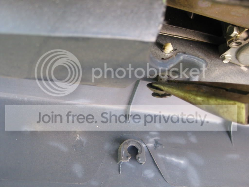

Step 1: Open the rear hatch and remove the interior trim panel.
-Remove the screws around the perimeter of the panel and then slide it toward the front of the vehicle.
- Take it down and pull the pushpins out of the gate with your pliers and put them back in the trim panel

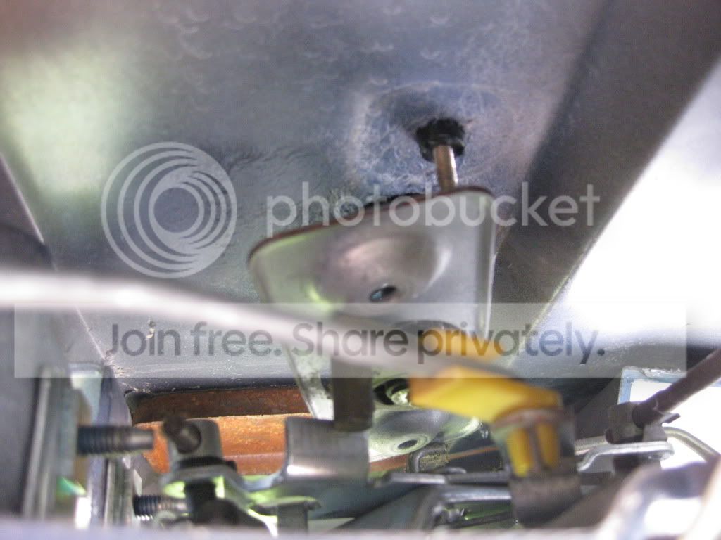

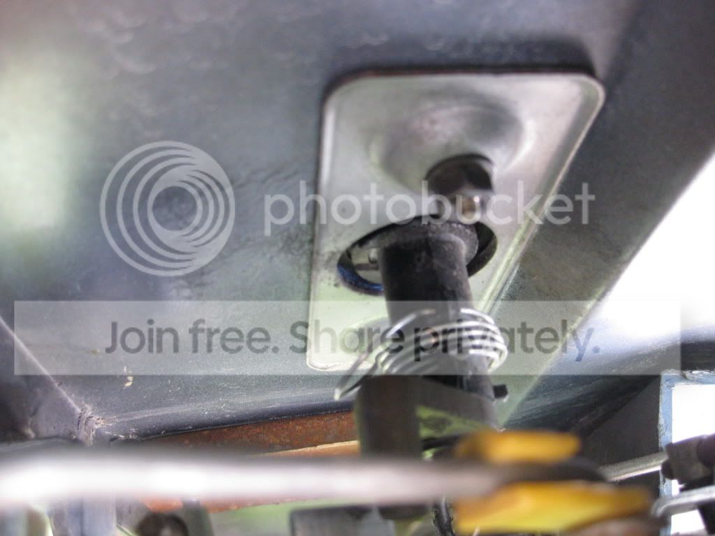

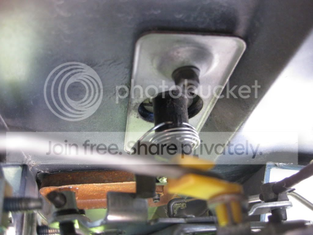

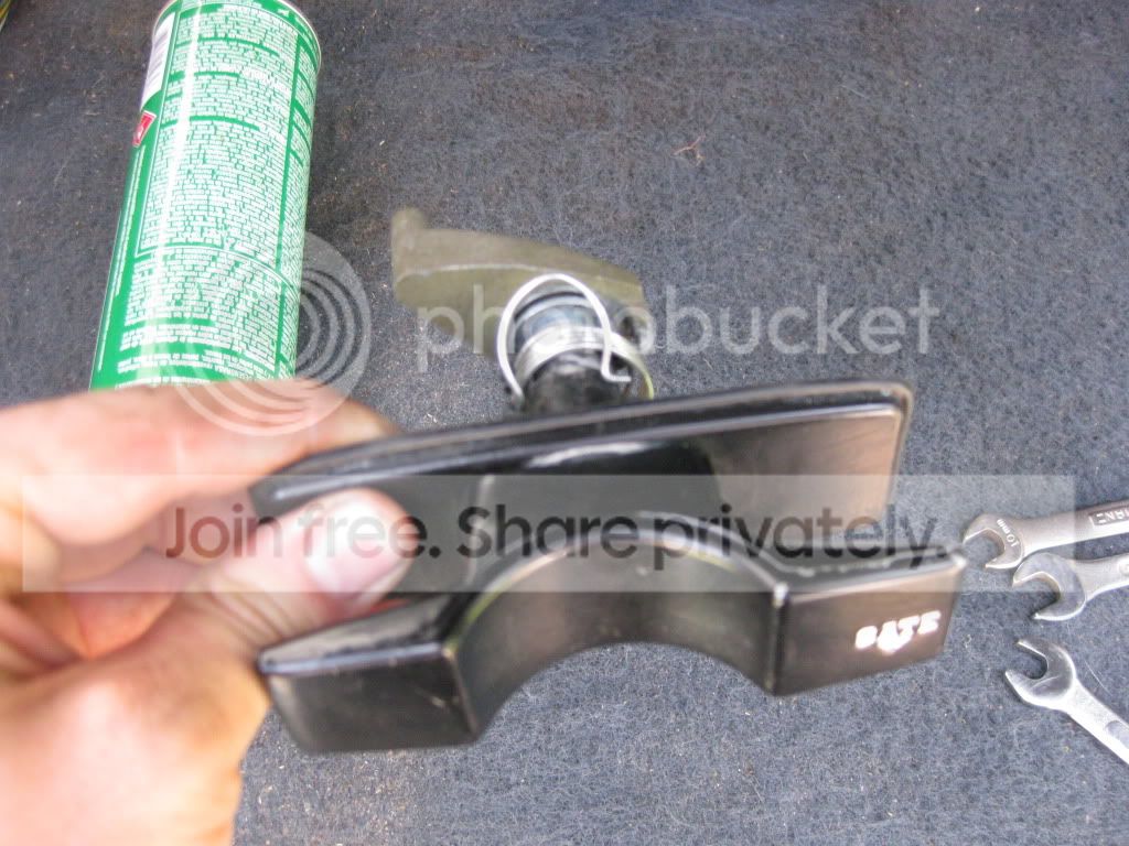

Step 2: Remove the latch release handle.
- Remove the two 9 mm nuts holding the latch to the gate
B2 Liftgate latch repair.

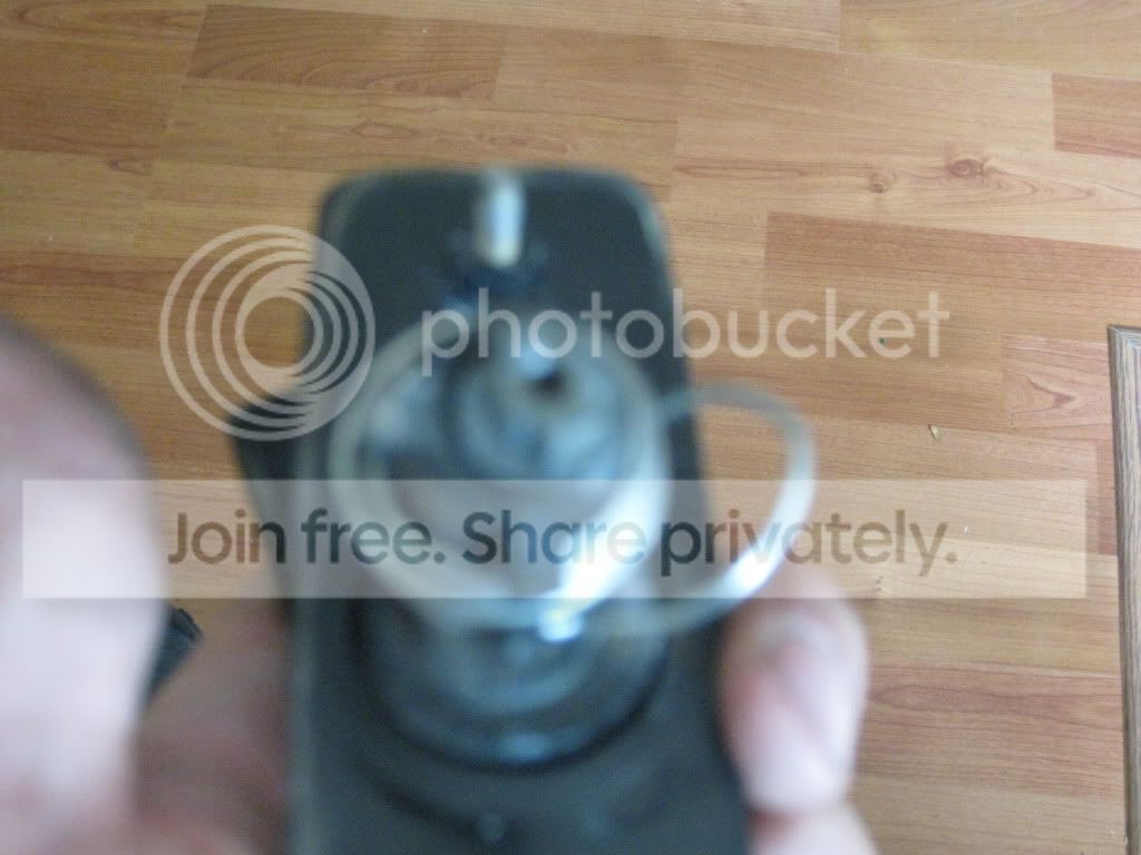

And the inside retaining plate.
- Pull the handle straight out of the gate.

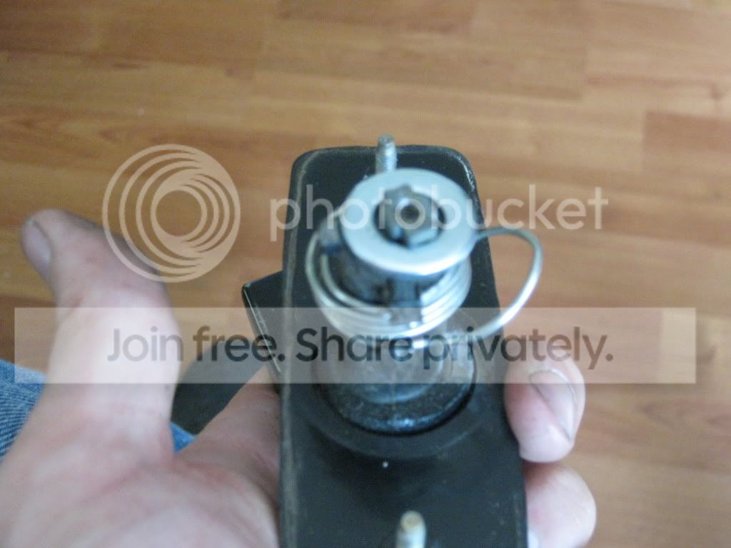

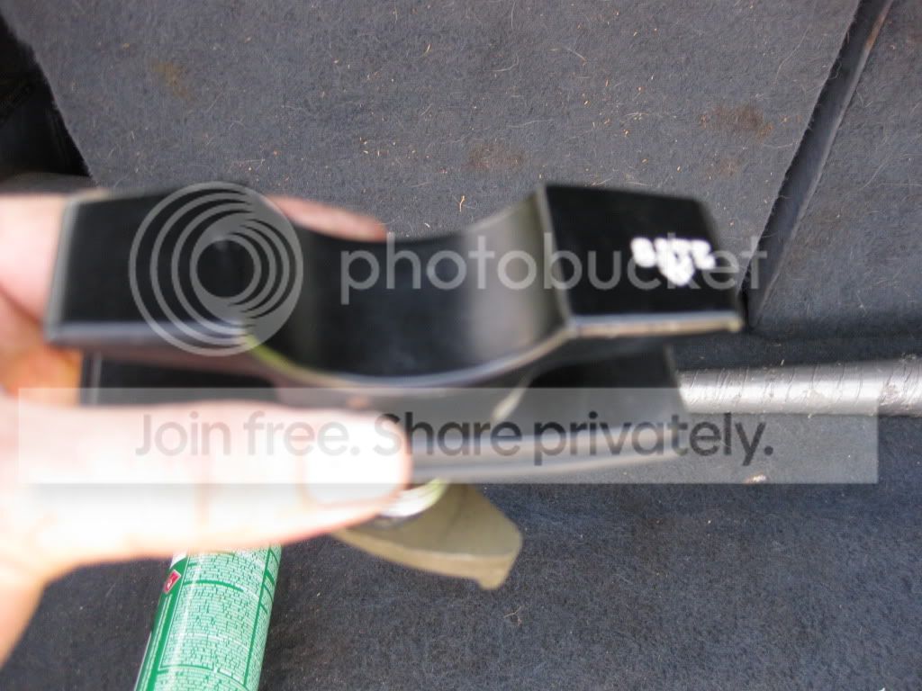

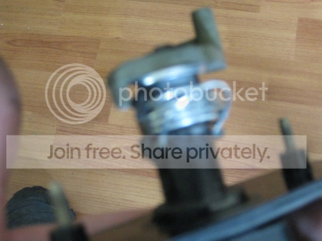

Step 3: Remove the latch arm:
- Remove the 7/32” screw from the end of the handle (screw already removed)

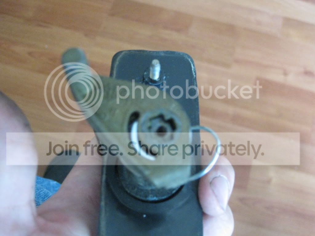

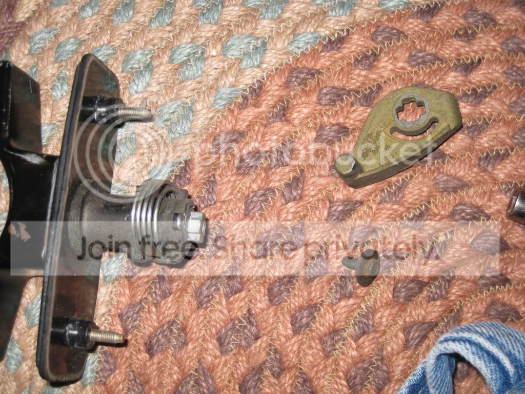

Pick arm up off handle.
Step 4: Install the washer under the arm and reassemble the latch release.

Step 5: Reassemble in reverse. Close the hatch and test it for proper operation before installing the trim panel. If this does not fix your problem you can now crawl into the back and pull one of the rods toward the center of the gate to open it.
