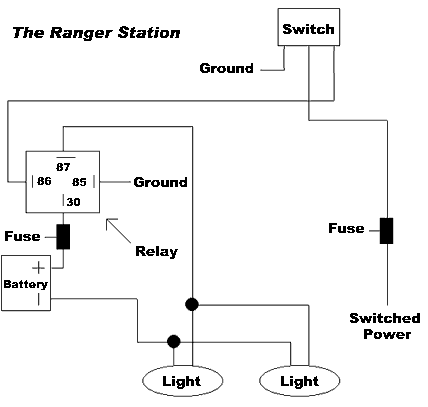

You do realize it is hard on the switch to take the load of that light right?
yeah it could melt it and damage your wirings. u should add the relay. its not that hard
My KC's up front don't have a relay. If the MFG didn't send one, then I honestly don't see why it needs one, but if you think it does then I might stop and pick one up. But from what I remember, relays end up attaching to your backup lights and other crap, but I don't want that, don't need any more damn wires all over the place.
Why can I not run my switch power (the fused line) to the battery instead of the fusebox. I would have to shorten my wire about 4ft, not a big fan of that.
Alright, switch was getting hot tonight... I'm going to get rid of the stock wiring and go to 12 gauge stuff, and I also got a relay and a in-line fuse holder for the whole relay deal. The relay seems straight forward enough, I might post pics if anyone wants it...
