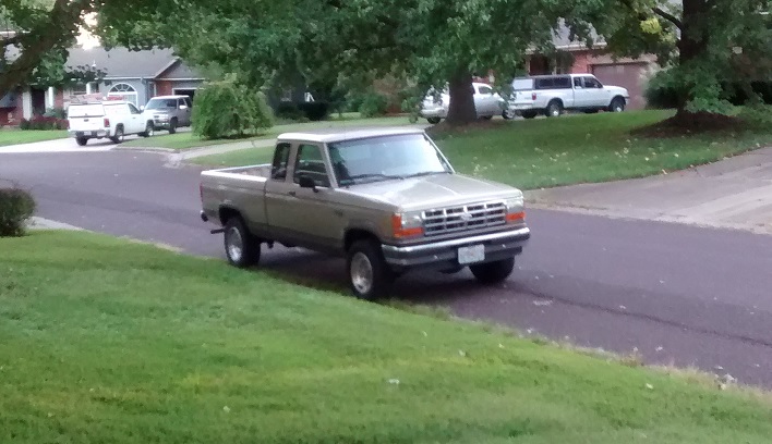

1990 Ranger XLT with push button 4x4. It all worked great. Had this truck gone over top to bottom. Asked my daughter to take it in for a leaking front tire but it came back without an auto locking hub. I don't drive it much, it's shopped most of the time, so didn't notice for an entire year. Now I can't find a replacement and cannot prove the tire people stole it/didn't put it back on. Looking for a replacement.

I'd keep a regular check at the yard
What did they put back in its place?
If they put a manual hub then you're half done.
Yes, watch the wrecking yards
There is no difference between left or right auto hubs
A manual hub swap would be better long term, seen here: https://www.therangerstation.com/tech/automatic-to-manual-hub-conversion/
