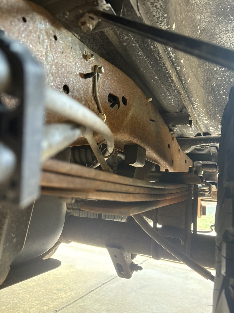

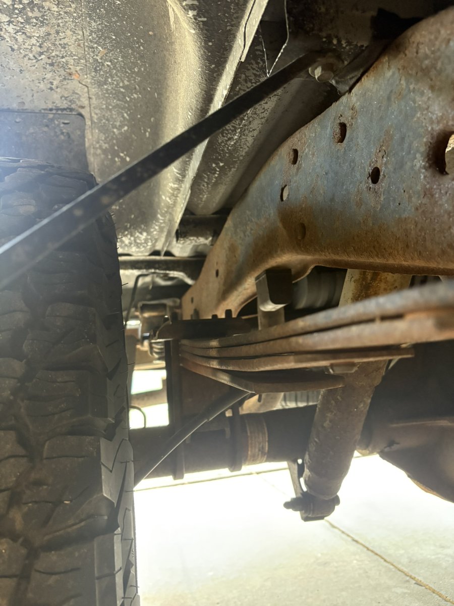

Hello everyone,
I'm refreshing the suspension on my 2003 FX4, and while the shocks are totally gone (replacing with Bilstein 4600s), I am unsure about the leaf springs. These look a little flat to me, but the truck does have a tall fiberglass bed cap on and I have hauled a few heavy loads before that may have loaded the truck to the max. As it sits, the front is about 1in lower than the rear on the worn out shocks and just the bed cap. Reading about AALs, they seem like a band-aid and will stiffen the ride up, but my FIL who is an old-school mechanic said I should go this route albeit without seeing any pics. If these are shot, I was thinking about finding a set at the junkyard, but might just bite the bullet and buy a new set from rockauto or general spring. Thoughts?
I'd have to say that yes those are worn out. Looks to me like they are moving beyond flat and starting to bow the other way. Could be a trick of the camera or my bad eyes though.
I wouldn't bother with junkyard springs, they are likely to be just as bad. Either new set, bandaid it with add-a-leafs, or find some place to get those rearched.

Those springs definitely look like they are taking a W shape which means they’re shot. Re-arch is a band-aid at best on springs that worn. Junkyard springs are iffy. I’ve also combined multiple packs several times before. If you can afford it though, I’d say just get a set of 1,750# springs and call it a day. If you haul stuff and/or have a fiberglass cap on all the time, that’s what you want. They will last a long time, usually longer than the stock springs. If you use it like a truck, might as well do the “buy once, cry once” route.
"Wore slap out" is my official evaluation. I recommend find new or gently used springs somewhere.
