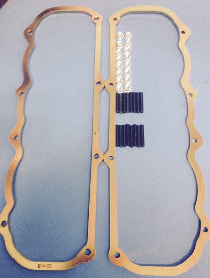

Anyone tried to fix valve covers leak with this ?

Tom morana have those valve cover rails but it is not cheap, if it fix the leaks for good it's worth it I think, did someone tried this ?

I've thought of using those myself (haven't got to rebuilding my spare engine yet, though).
In theory, they should help a lot. My understanding is they replace the weird wing washers with a thick torque distributing band.
I'm currently running felpro gaskets with the service manual's recommended torque. I think those slowed leaks. I'd be very interested in seeing that morana part in action.
