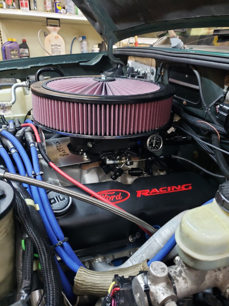

update on the sniper: the ecu crapped out. holley sent a new unit, a whole new sniper kit, eventually. put it back on friday, it was skipping. performed compression leak down test, i have been questioning valve train issues. to my surprise test went well. put a new set of ngk plugs, #tr55 to be exact. tightened the gap from.050 to 42 - 43 ish replaced a wire that broke during removal and its back on all 8. running strong. need to get a set of new matching wires just for looks, and a larger filter, probably a k&n flow through. also considering a lower thermostat.
New filter, still mismatched wires. The sniper has been good this time, AMAZING throttle response.
