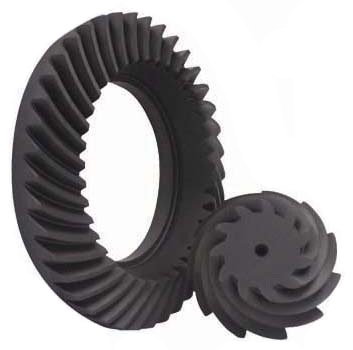

Anyone tried to buy D35 gears lately?

you have almost 30 more hp and like 40 more torque and you have 3 more cylinders to help. I’m going with what the countless Toyota and Jeep guys say. And my experience also. I had 410s and 35s with ford 4.0 and after going with 513s. I would never do anything less for a 35 and bigger tire. I wish I would have went with 538s in my ranger. But that’s my real world experience. People don’t gear down when they need to and they get use to the shitty performance and idk just deal with it. I know I was one of them. I was only going to go with the d35 because I could regear it and throw a lunch box locker in it and run for the summer but since Covid killed 513s for TTB d35s it looks like I’m gonna have to get creative on what I do.
